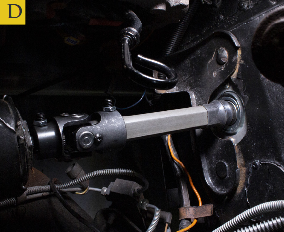

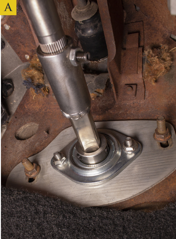

I did my own- used a newer design off a Nissan Cube-
Mounted mine on the outside of the firewall- the EAS says theirs mounts on the inside. I really don't think there is room. I spoke with a guy from EAS at IIRC Hotrod Power tour or a Summit Racing Motorama-
and he was not really knowledgeable on the C3. I have their literature and looked over the install PDF- but it doesn't show any pics of it in a C3 where the motor goes.
There's not a lot of room around the column?
And I'm a little baffled on where they are placing the motor? See pics

mine on the firewall-

BUT- -knowing the size of the motor- can you see it fitting on the column inside the car?

"knowing the size of the motor- can you see it fitting on the column inside the car?" That was my question too. I have a 454 with headers stuffed in the engine bay, so there is not much room there either. I like the idea that no power steering pump and hoses are needed and there is no parasitic drag to reduce rwhp, but will it fit?
