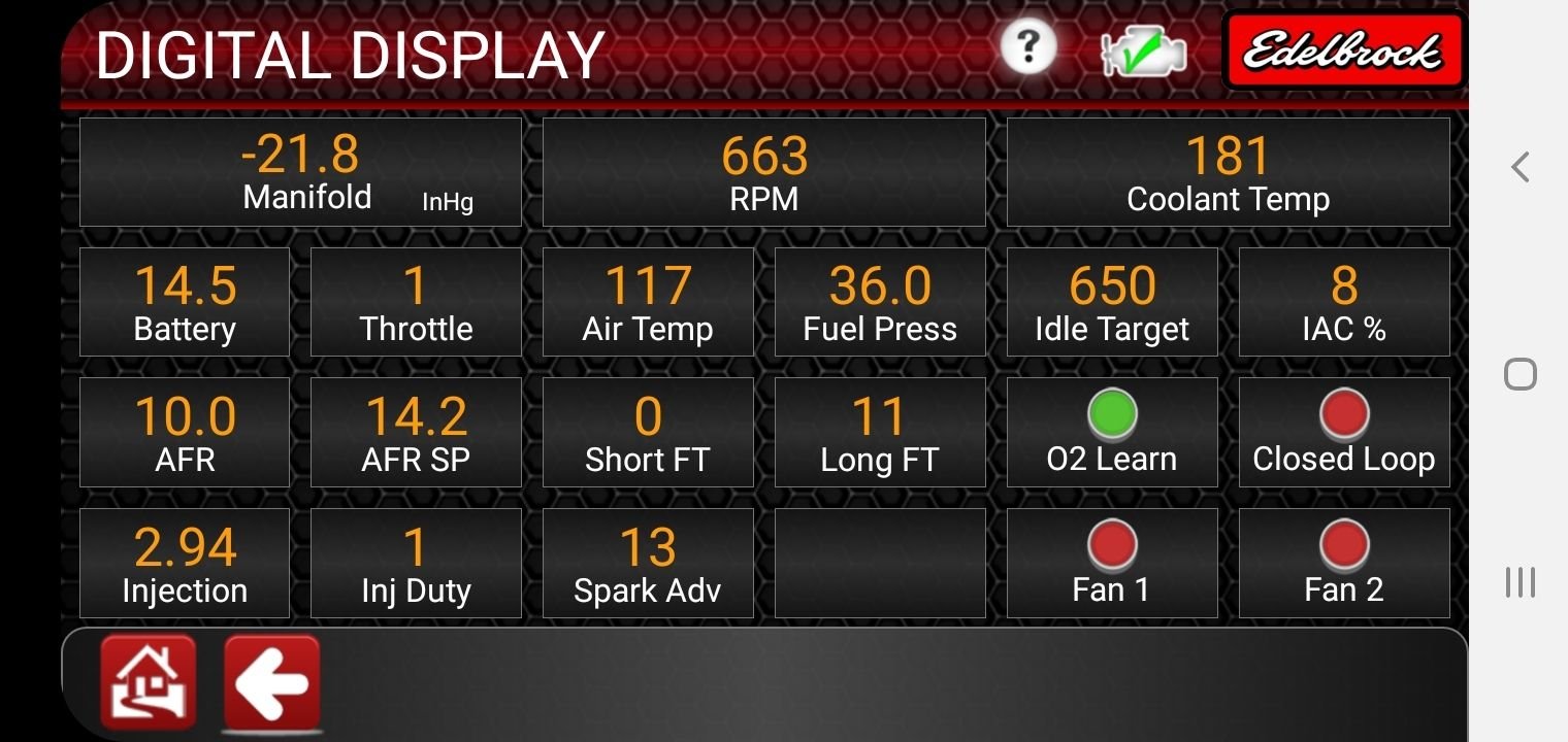

I have a Edelbrock Pro Flo 4 on my 71 LS5. I am totally happy with the system. It comes with a port injected manifold, a distributor, and the ECU and sensors required for install. Additional things you will need for install is a fuel system capable of providing 43 or 58 psi depending on the map you run. That is determined by the cubic inch displacement and vacuum your engine normally runs at idle or camshaft. The other thing that will be required is the install of one O2 sensor bung on your exhaust for O2 sensor install. The system is relatively easy to install if you have changed an intake manifold and have basic wiring ability. It does require a power and ground wire connected to the battery which turned out to be the most challenging part of the install. I just followed the positive battery lead to the starter route through the tunnel. The system gives you fully adjustable mechanical and vacuum advance. It has E-tuner 4 software available for download on your Android device or the optional tablet. I would not buy a unit with the optional tablet. There are plenty of android tablet available for less than $100. In my case, I always have my phone, which means I always have monitoring and modification ability or you can use a tablet. Below is a picture of the digital display. You can play around with the software available in Play Store by running it in the demo mode and see what setup is like for the system. Whatever system you decide on, it should solve the problem you are trying to fix. Good luck.
PF4 digital display
