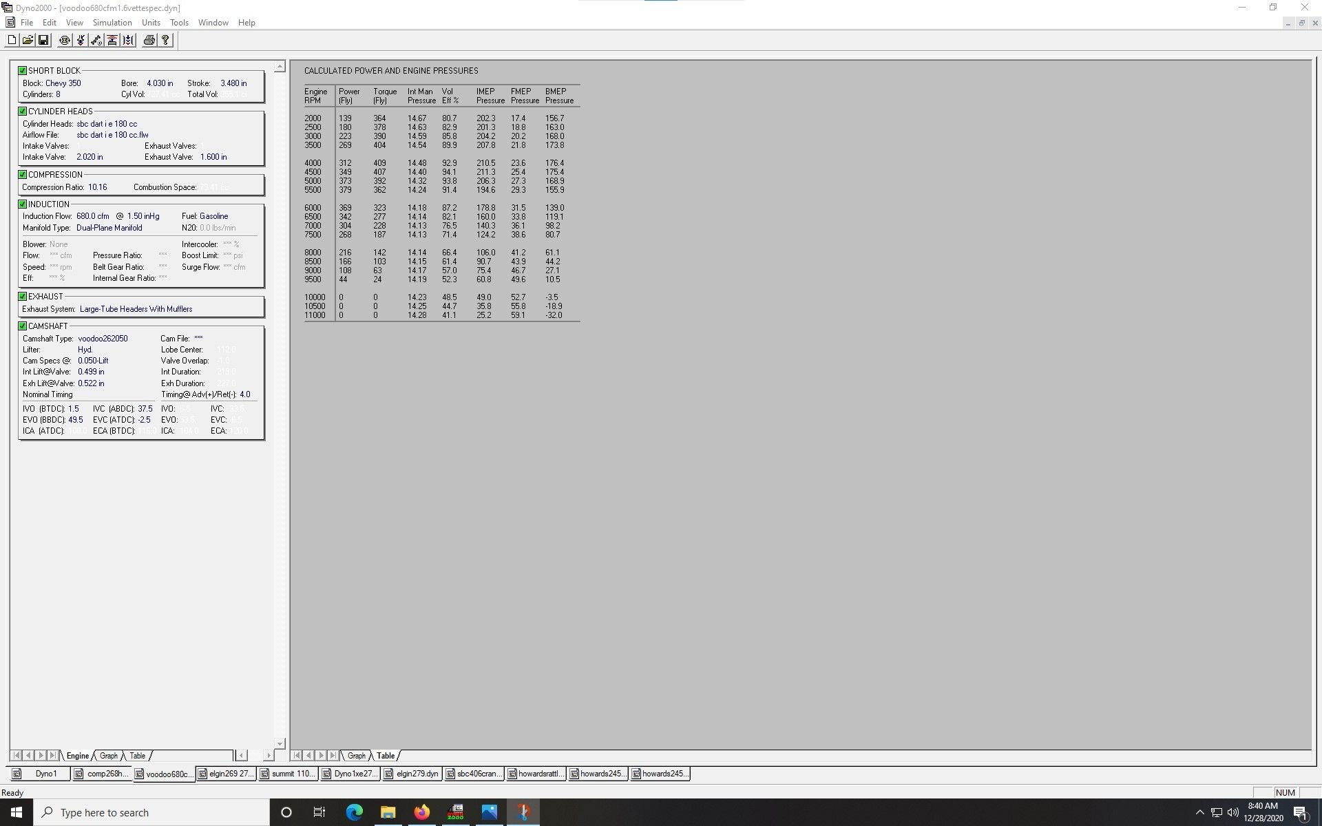

This looks like almost the same scenerio I was in 6 years ago... I built a 355 with 7cc flat tops and 64cc dart heads. Dyno 2000 actually showed the torque and HP was better for my combo with the voodoo 262 cam vs the voodoo 268 cam.. of course right now I am considering jumping to a larger howards retro roller cam as the dyno software show pretty substantial gains with it. And yes these numbers are highly optomistic and likely much higher than real world performance but when comparing both options using the math its still worth something. BTW DCR is a concern so you want a can that will bleed off enough to run pump gas. I took Reelav8rs advice 6 years ago and aimed for a small quench area of about .039. My deck is not decked so I use a .015 steel shim gasket. I have no issues running 89 octane with the iron eagle heads. I have sidepipes with vettepacks, a th400 with stock (2000rpm?) stall and 3.08 rear gears.. I still wish I had more power at takeoff and regret not building a 383 or 400.. I wish I had a 700r4 or 200r4 and its on my bucket list for the lower 1st gear and OD.
PS my lift numbers dont match the cams specs due to the 1.6 rockers im running.
