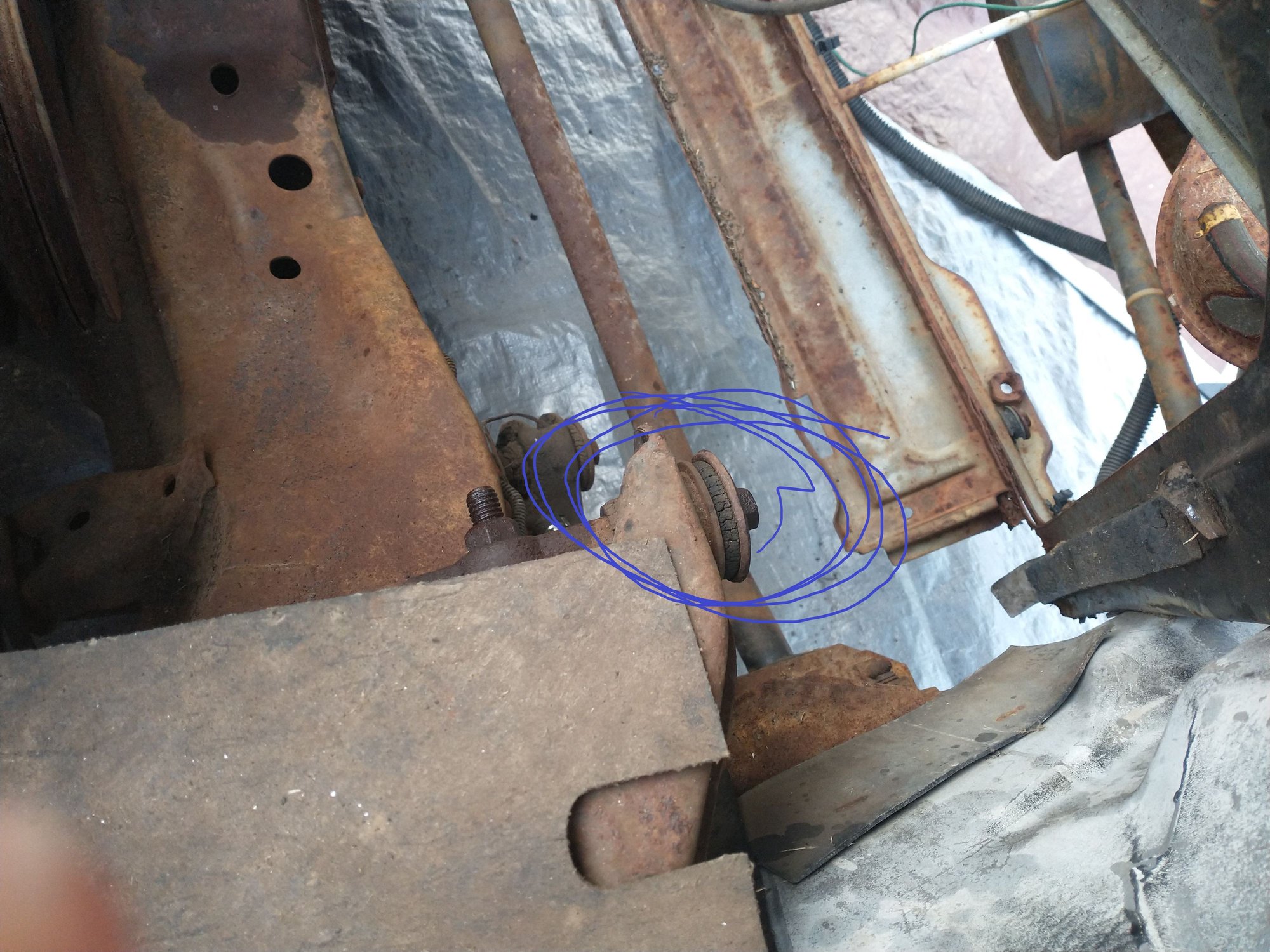

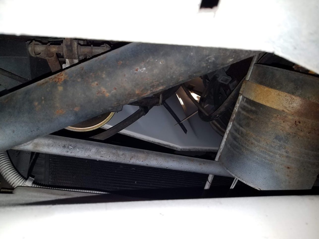

Can someone tell me what these bushings and this bar are? I have attached pictures of both the bar, bushings, and engine bay. Thank you.

Upper control arm bushings. You can find them at our supporting corvette vendors, most "box" auto parts stores. You can also find how to videos on YouTube.

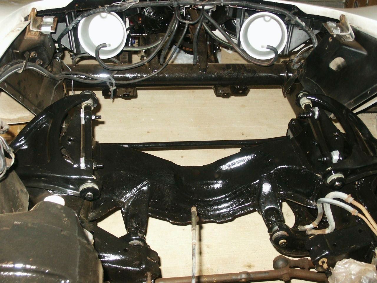

As stated above, A-arm bushings. You have upper and lower bushings. Here is a photo of both that I replaced on my 73.
Donnie

I'm not 100% sure what that bar is, but it should probably be welded at both ends. Here's the least terrible photo I found that sorta shows it. This is looking up from beneath, with the hood raised (visible behind the coffee can).

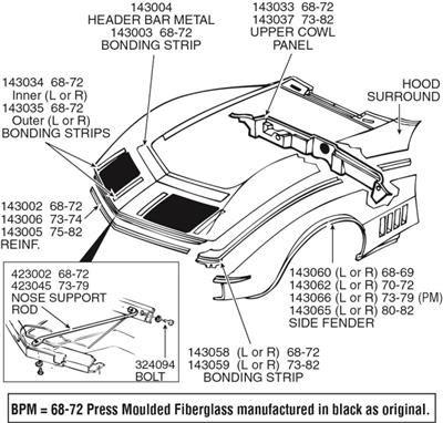

that rod looks like a support rod...? Better pic may clarify

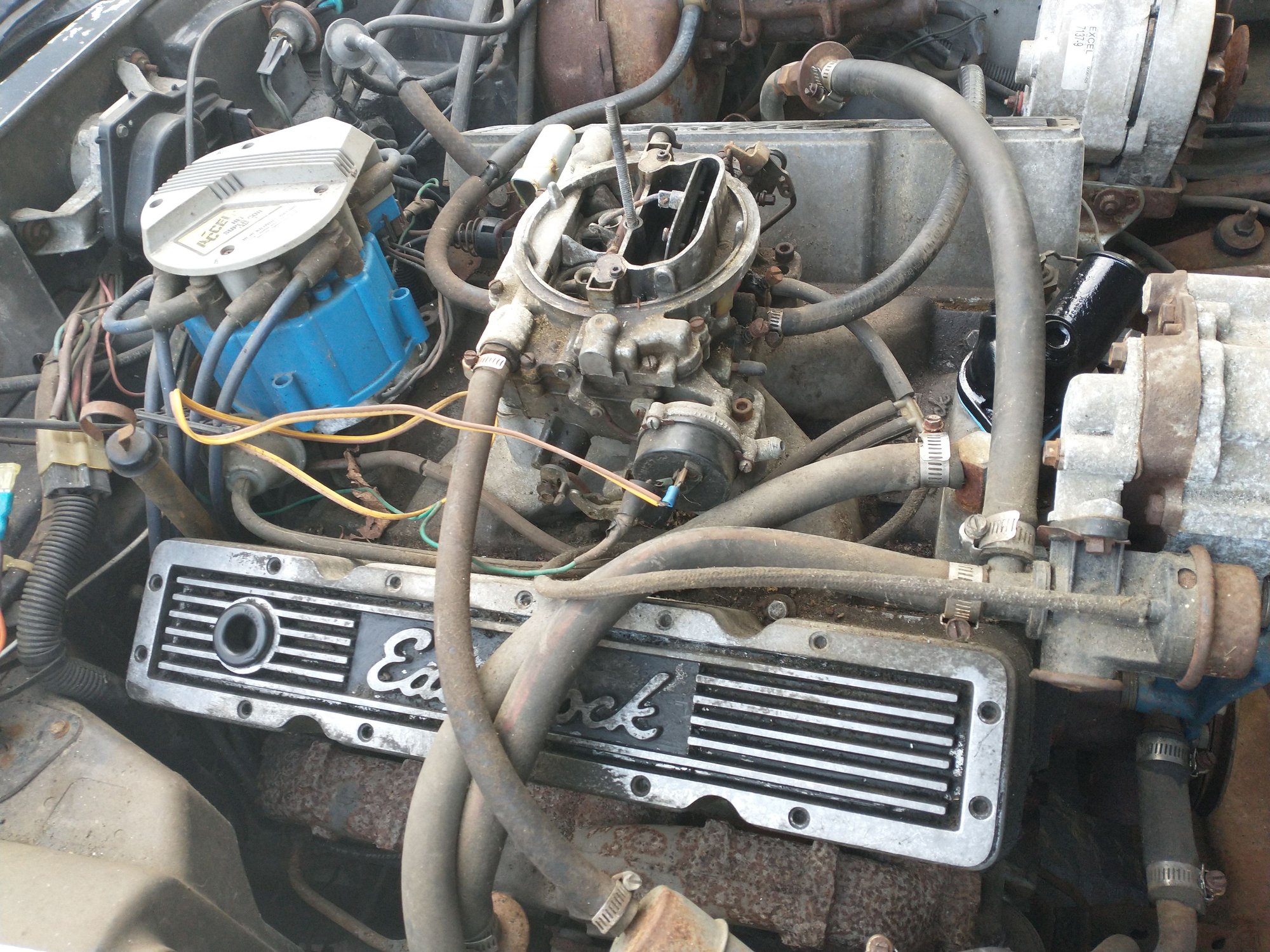

dont toss out all that emissions stuff its worth money...what are you planning? That fuel line looks dangerous...

I STRONGLY suggest that you get the rubber fuel line, and fuel filter, MUCH FURTHER away from the exhaust manifold, than they presently are. They get hot enough, and a-arm bushings won't be a concern....

Dose Support rod.
