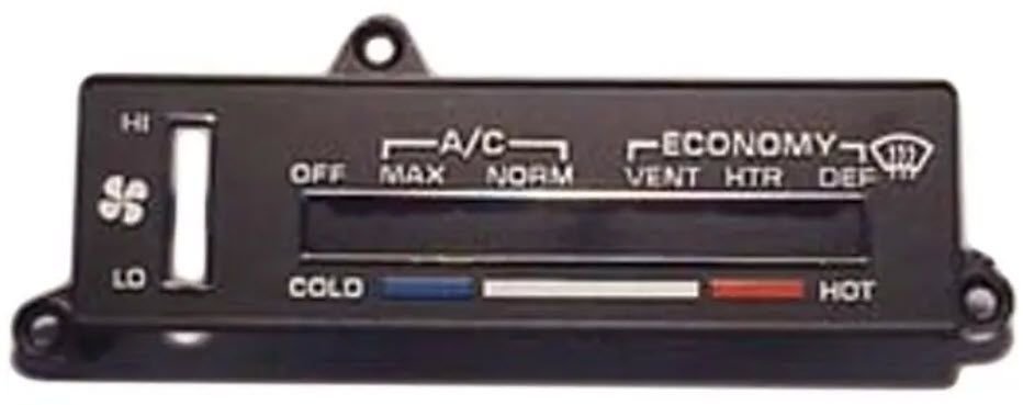

I also have another question. So I think I’ve fixed the vacuum leak at the air conditioning control panel. My blower motor wont not turn on when switched to the economy side of my controller. Is that normal? Also, how to I switch the vents between floor and upper and defrost?
Your panel looks like this...right?

Yes
