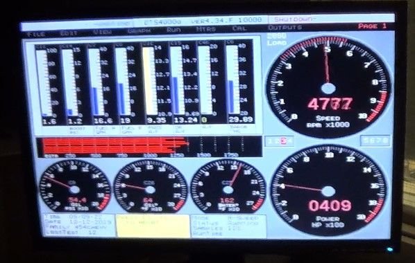

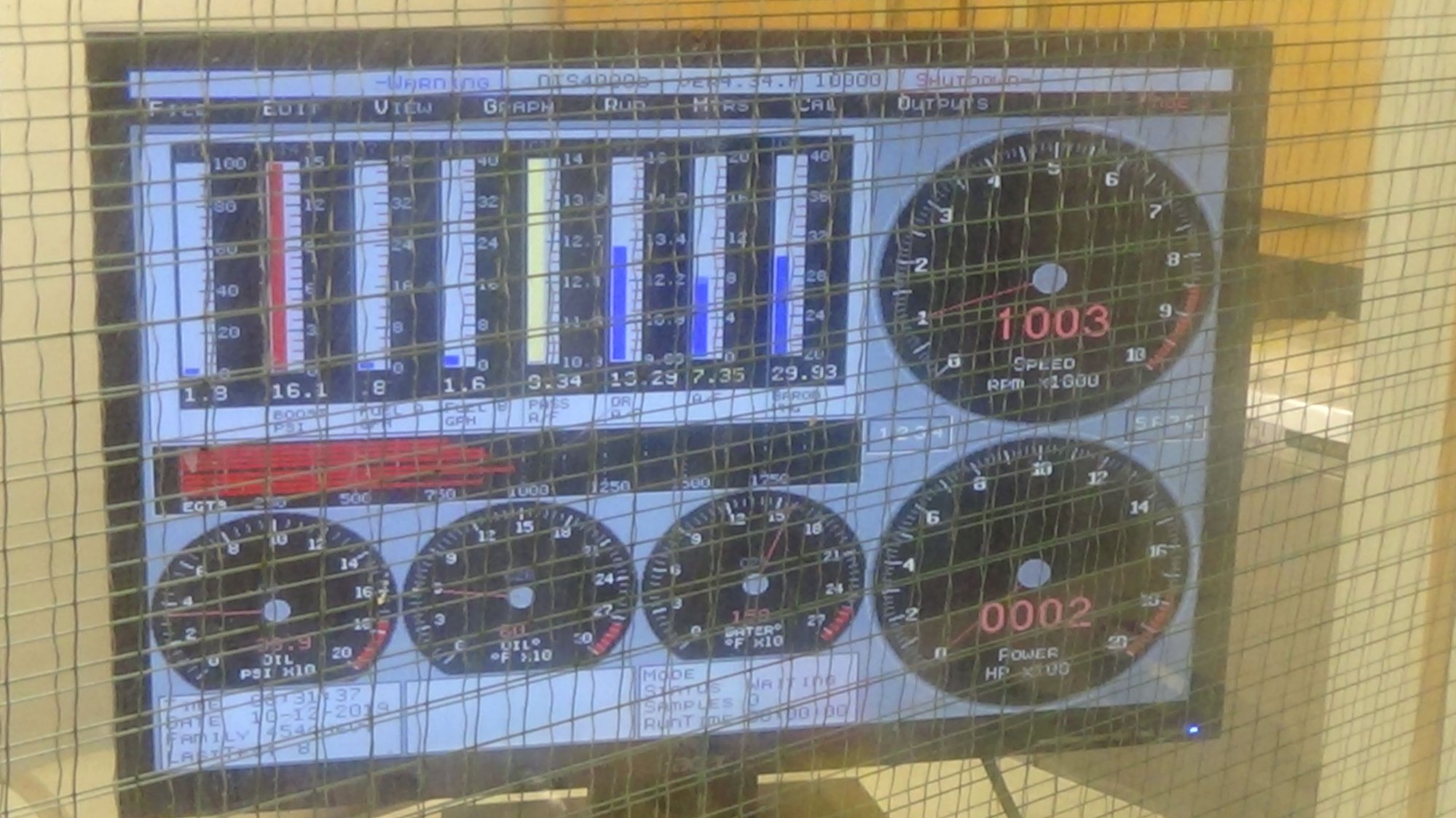

I was always under the impression that as long as you are within 100 degrees you are good to go. And here's a Dyno shot of my brand new engine under full load with eight exhaust pipe thermocouples.. Lowest 1175 and highest about 1350. This is a perfectly normal spread. All close. #2 & #6 slightly low. A 10% variation. This is kind of like compression readings, you want them all close. They will never be the same. Now if one is 20-30% low, that's different, and you have a problem. Your compression readings are even less than 10% spread, more like 6%.
