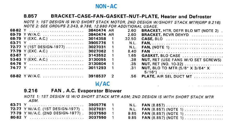

Hi, my 72 is born with ac, but most parts like evaporator, condenser and blower are missing.
I have decided to go without ac and have rebuild the heater box to be non ac like, but have kept the heater core.
Now I am struggling to find the right blower motor. Should I go for an ac or non ac blower? Some dealers have different blowers for the two setups and some list the same for both.
I am looking at ac delco 15-80666 on ebay, it seems to fit except for models with "ac press on", what ever that is.
I am confused and any guidance is much appreciated
br Anders

Long shot here but did you ever get your answer? I'm in the same boat.

Looks like the 63-71 blower motor was the same Non-AC or W/AC
Same for 72-1st Design 1977...
The problem you may find is the harness, heater control switch and resistor are different from Non-AC and W/AC cars.
