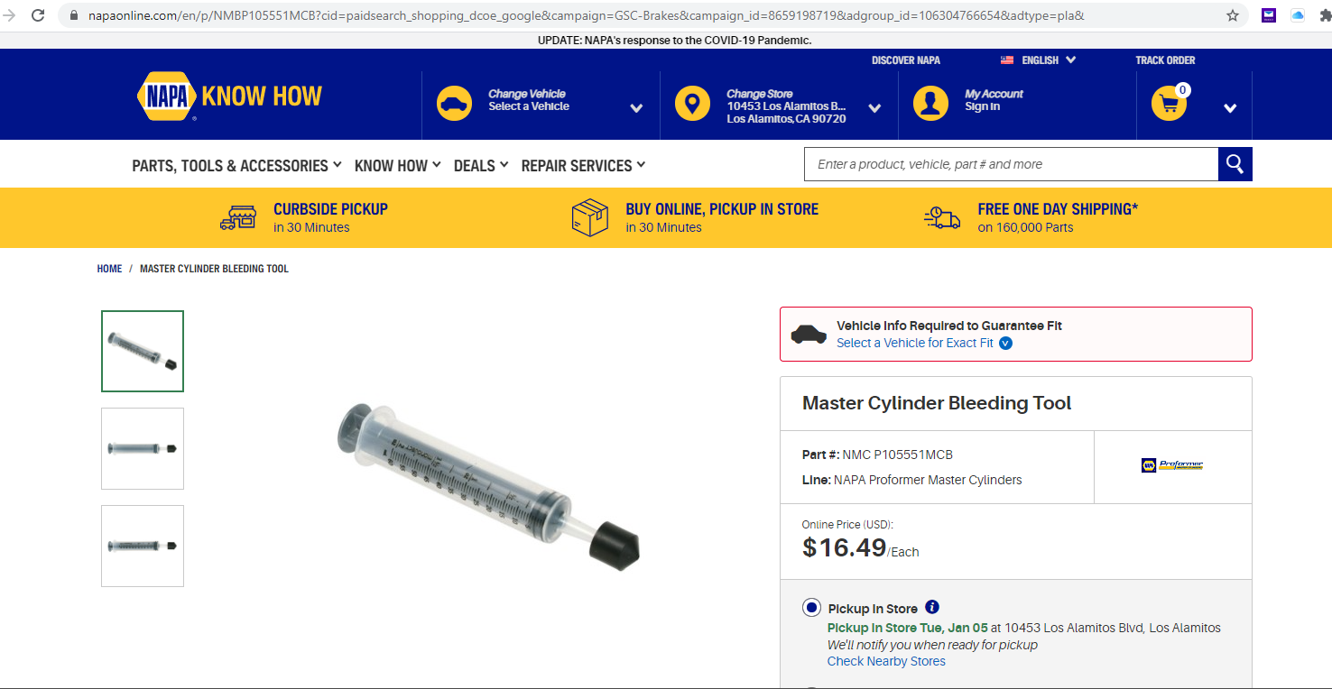

I just did my brakes and a couple of calipers myself. Used a brake bleeder syringe like the one below. Was able to bleed my brakes myself and have a good pedal. Just open one bleeder at a time and force fluid through the system.
