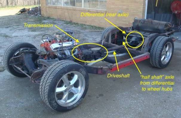

Here's a pic and labels to illustrate the major components of the drivetrain between the engine and rear wheels:
