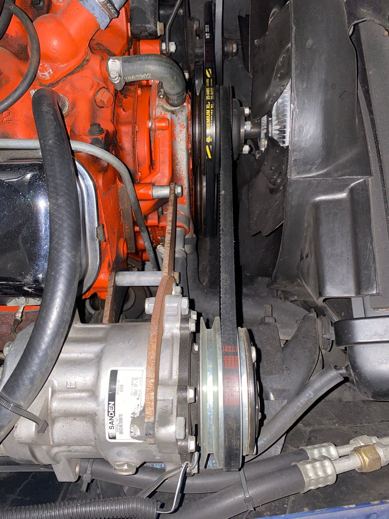

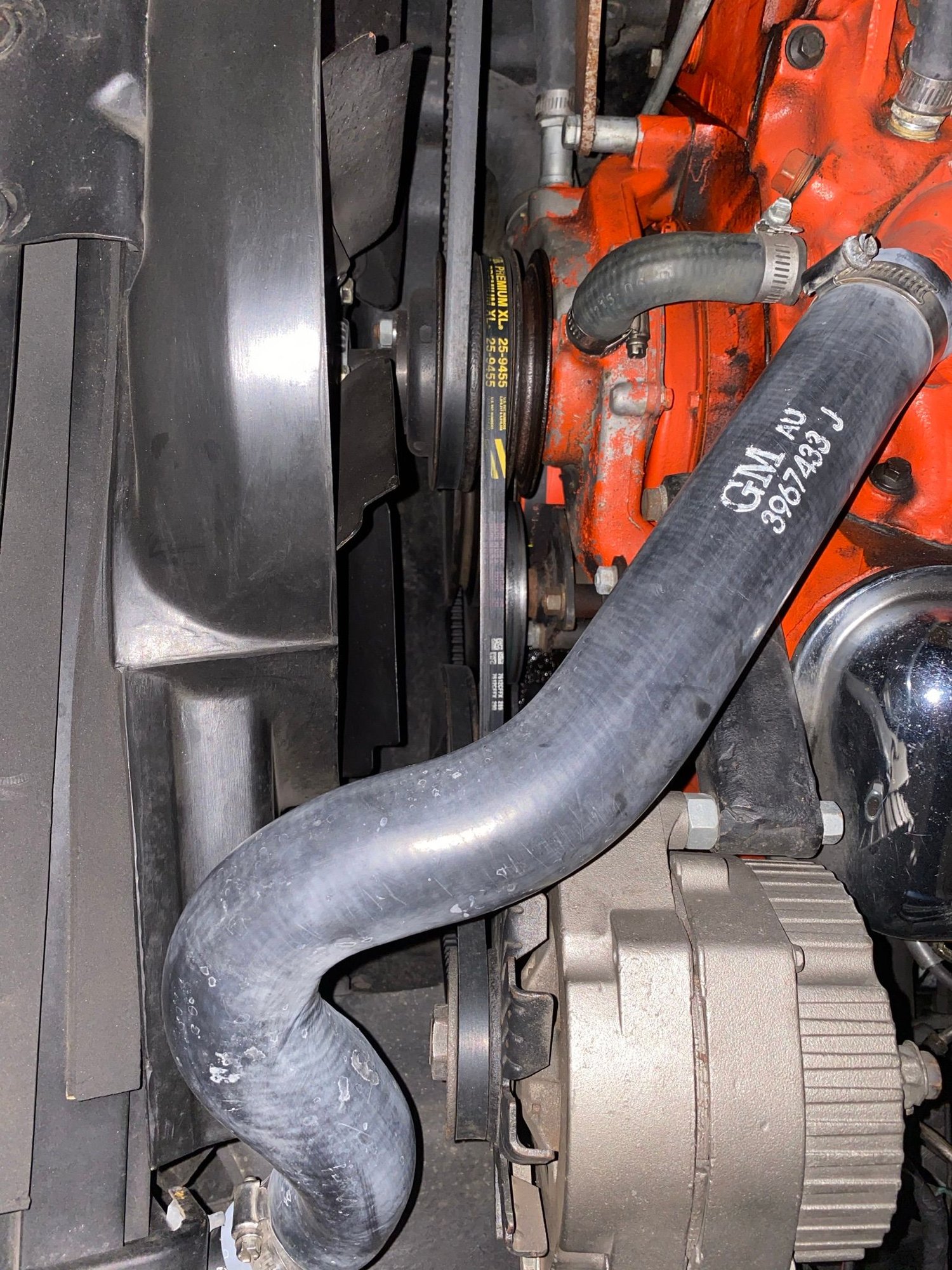

Took some pics of what my belts look like right now, not sure why there’s a second groove on the compressor. But me not knowing something about a car is nothing new.

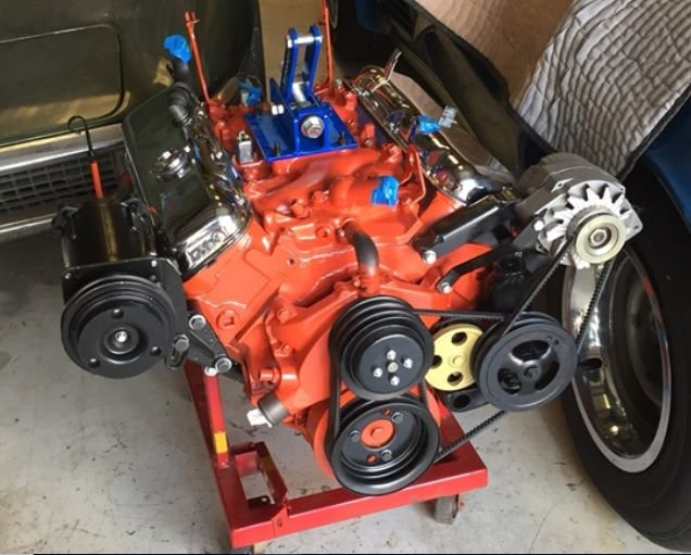

From an older alan post
op hard to see how yours is routed but worth a review

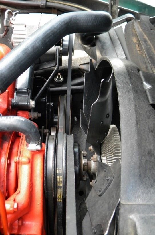

Okay, so mine looks like:

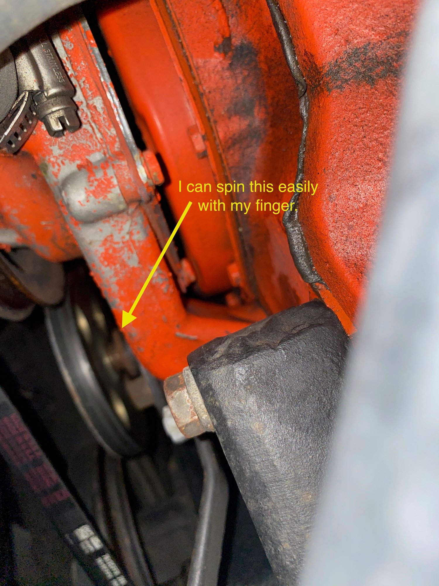

Except, I think this is my idler pulley, right?
It's not touching anything.

Don't want to confuse you, but here's my observation.
Here's the good news:
Your 3 groove pulley on the water pump is correct.
Your AC Compressor belt is routed correctly, the brackets and spacers line the compressor up like it's suppose to be.
You can remove the compressor belt if want to, but I would not remove the compressor, it might just need a charge or a leak repaired.
Fortunately, you have the idler pulley for the crank to water pump belt but the belt is not installed, details below.
Your power steering belt is installed correctly, so no problem there. It might be the wrong size belt, but that's all.
Bad news:
Something is not right about the 2 groove crank pulley, the 2 grooves should line up with the rear and middle grooves of the water pump pulley.
From what I can see, it looks like the crank pulley is not correct for a '71 454. It should be a 2 groove, the rear groove should line up with the rear groove of the water pump pulley and the idler pulley. The other groove would line up with the water pump pulley and the power steering pulley
You have the wrong alternator pulley, that's why there is a nut between the alternator and the upper alternator bracket so it positions the alternator forward to line up the belt with the power steering pulley.

Isnt he missing the belt closest to engine? You have better eyes than me..i cant see crank pulley grooves..

Yes, he's missing the crank to water pump belt, which is crucial on his 454. Without it, the power steering belt is driving the PS, water pump, alternator, and AC compressor.
The crank pulley doesn't look right from what I can see.

Any experienced C3 big block Corvette mechanic will address that crank to water pump belt at first glance.
