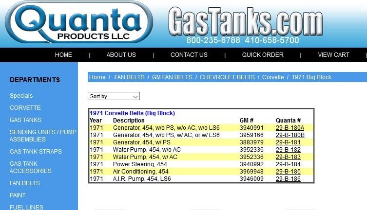

I would not drive my car without the short water pump pulley to crank pulley belt. The power steering belt would be the main belt and I wouldn't trust it, and it would probably squeal. And besides that, I've had issues with original GM big block power steering brackets not handling the stress.
The link 67:72 posted is a good one, here is the chart for your '71.
The water pump belt listed is GM #3952336, which cross references to a Gates 7315. It is 31.5" long and .41" wide. If I were you, this would be the one I would install.
My water pump belt is a 15320, which cross references to a Gates 7320. It is 32" long and .41" wide. A half inch longer and it's not quite as hard to install and the idler pulley pushes in to give it a little snug.
Let us know if you need any help/advice to install your belts.

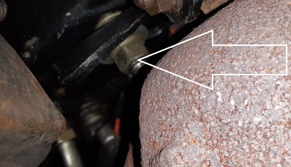

The P.S. Pump has two bolts. One on top for locking down, one on the bottom which is a pivot bolt. Usually the pivot bolt is so tight and rusty that it needs to be slightly loosened for belt adjustments. Bottom pivot bolt is only accessible from underneath (ramps).
Do not use a pry bar to remove slack at the pump. Use a pry stick, such as a 1 X 2. Wood is more forgiving and not as likely to damage the pump. The stick can be jammed between the pump and the block. Go slow & steady, checking the belt tension. Then snug down the upper bolt, then bottom bolt, then top bolt again.

Here is a photo of the PS adjustment nut on the rear. I use an offset box wrench to loosen/tighten.

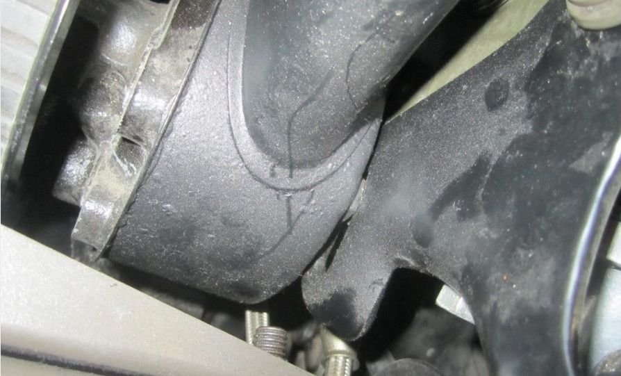

Note that the belt # 15320 waterpump in above photo, is riding too deep in the pulley. So, therefore, it must be an incorrect belt.
I believe you are correct about the change in sizes and that is causing a lot of the problems we're experiencing. I installed a 7315 on mine recently and still have the sleeve it came in, which states " 3/8" x 32-1/8" or 9.5/10 mm x 815 mm. According to 71 Green 454, Gates 7315 is 31.5" long and .41" wide. Worse, my guess is the original belt was supposed to be .440" wide. Two problems here. First, the belt is not as wide and will sit lower in the sheave as you noted. This makes the belt seem longer. The effective change in length is about 0.2" +/-. Second, the belt size you think you are getting is not what actually arrives.
