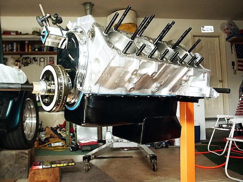

I'm saying that Cloyes adjustable are not needed. The aftermarket water pumps have very little clearance. I use a central button that doesn't do anything except look pretty under a stockish type cover. I've never had one touch the inside of a timing cover.
http://www.speedwaymotors.com/Small-...Long,3232.html
My refresh going back in
