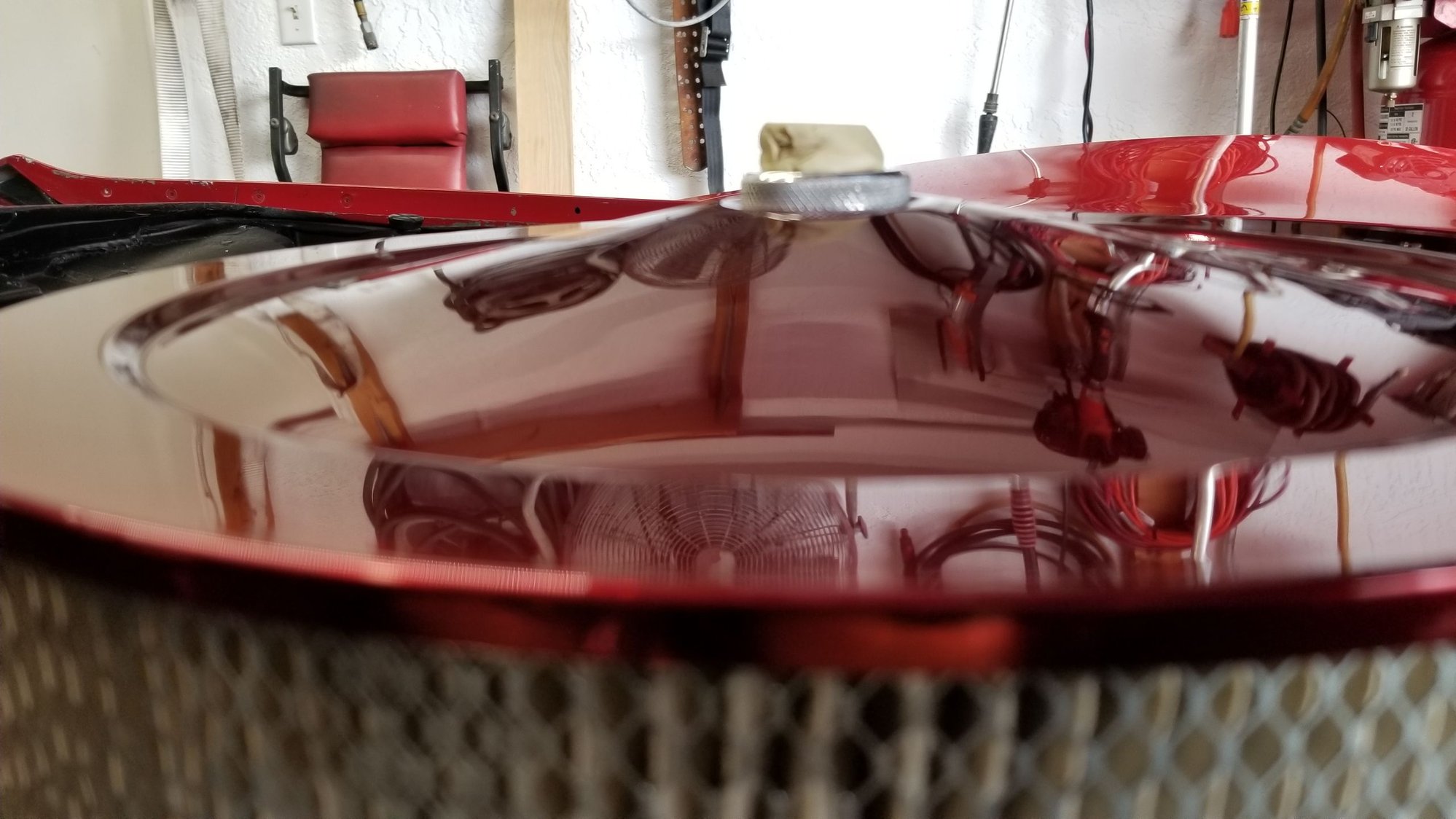

This is the biggest drop base I found. Using this, a 2" filter, and a K&N filter top fit perfectly with my bigblock.
Air Cleaner

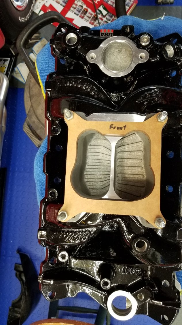

I have a 1980 and have had edelbrock eps intake with drop base air cleaner from K&N 14" with 3 in filter I just last moth replaced my intake with eldebrock air gap 2601 with 1/2 in phenolic space and have 1/2 in hood clearance . stock hood hope this helps .
To Air cleaner
