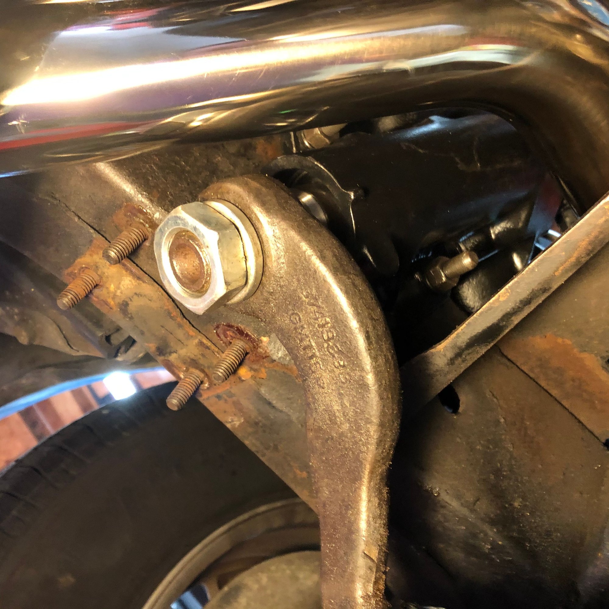

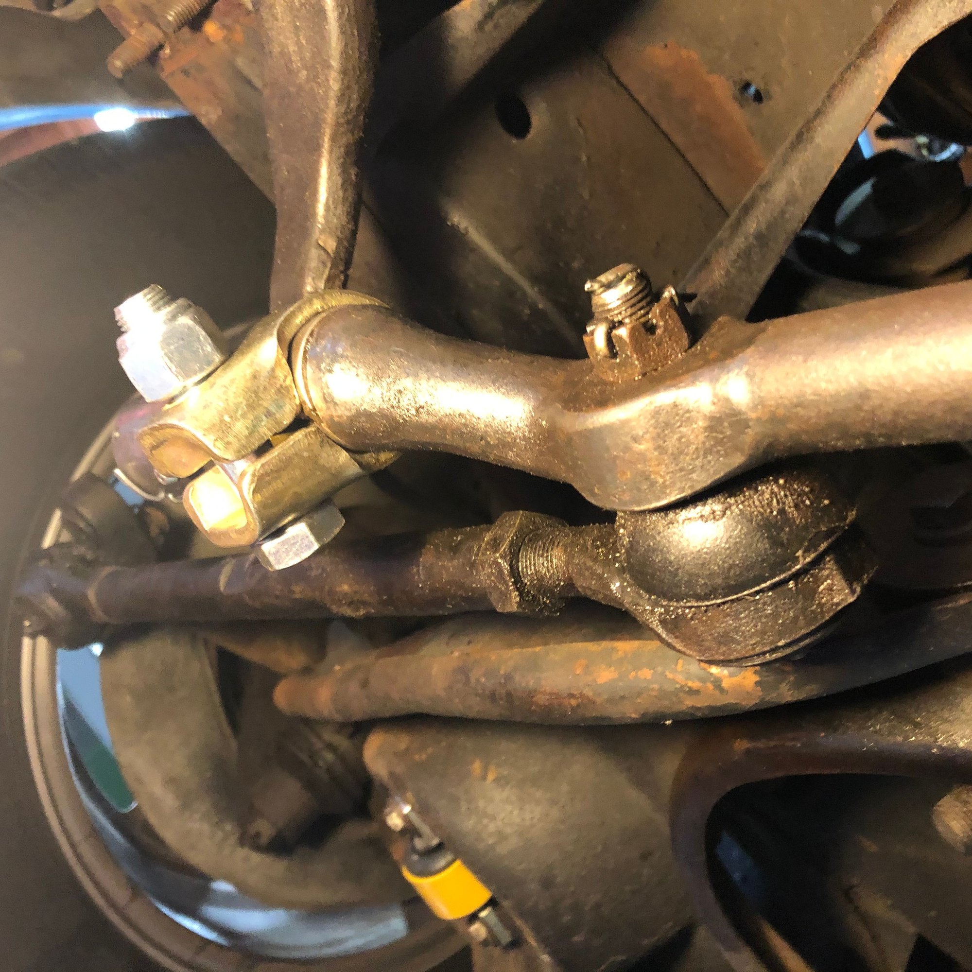

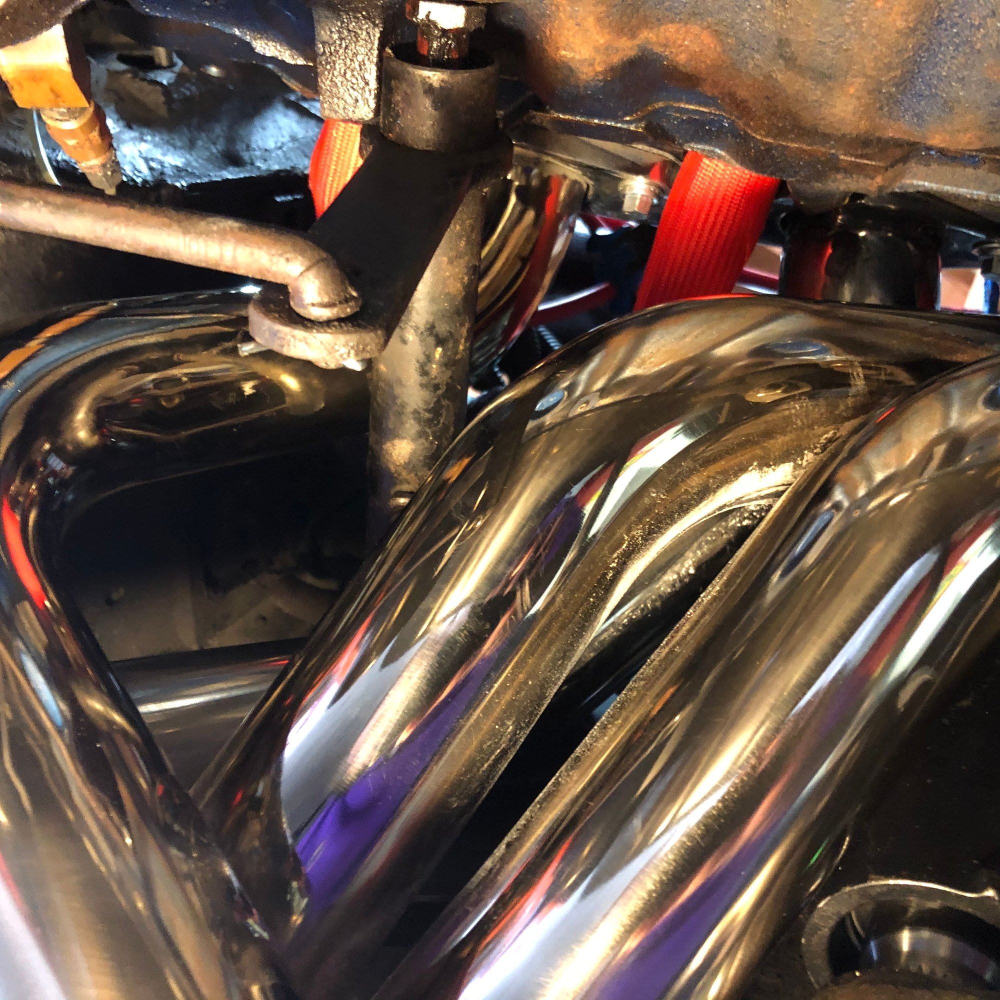

The purpose of this thread is to report that BB car owners with Doug’s Headers can fairly easily install a Borgeson steering unit regarding clearance. I took my headers off to remove the old steering parts just to give myself more room. I was concerned the clearance with #3 cylinder but it went together just fine. Dougs headers fit really well on the block with no denting or dinging necessary.
One word of caution regarding the steering column and shaft collapsing. It does NOT work as easily as it shows in all the videos, instructions, etc. You need to be prepared to remove the column and then take it apart to get it to collapse. You will also need upper and lower bearings which are available from Zip Corvette. It’s not a 4-5hr job (at least not for me). This was the only snag I ran into during this project and I will test drive it soon.
My car is a 1968 w/ 454 Big Block.
#3 is tight but manageable.
New drag link and no more leaking control valve.
