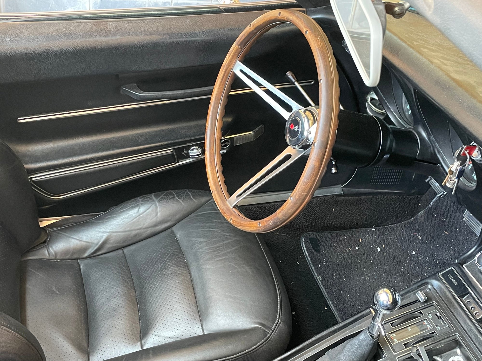

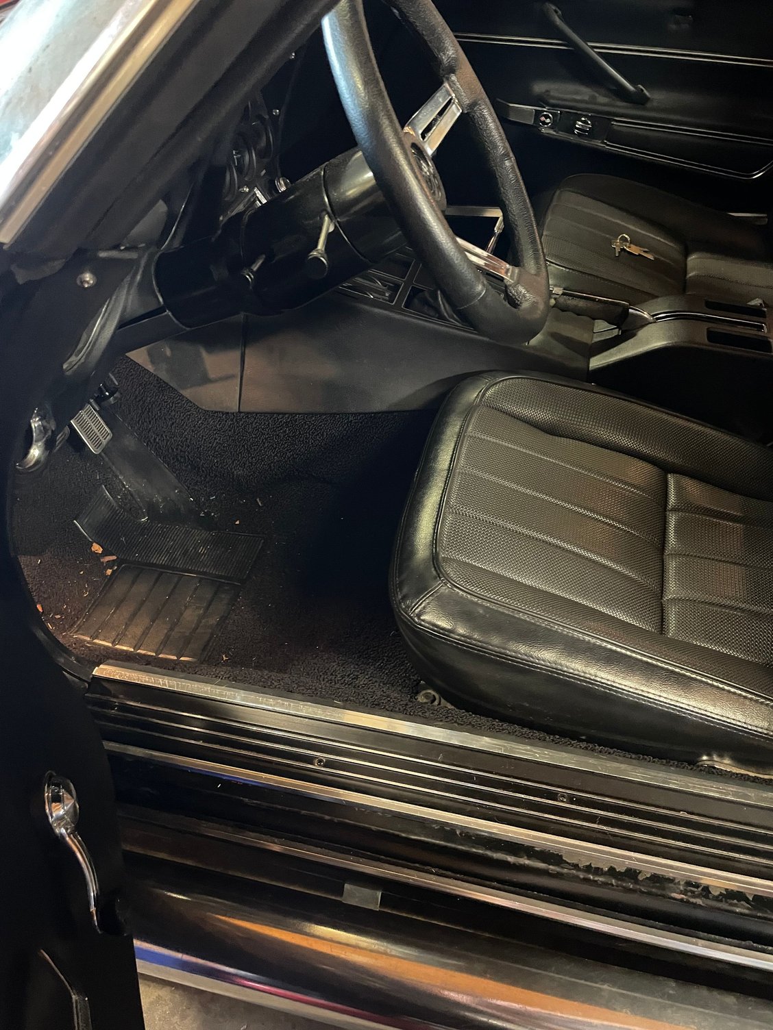

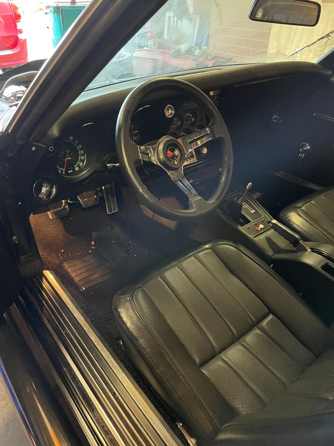

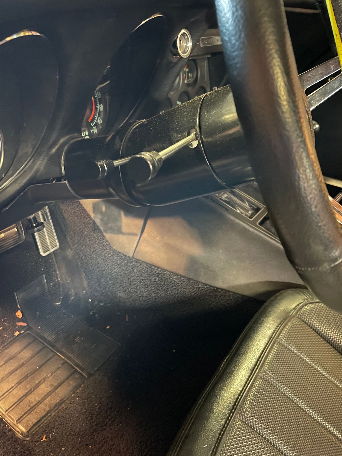

A few weeks ago I posted a thread asking if anyone had installed an Ididit column in a 68 with a Borgeson steering box. I didn’t get any responses so apparently no one else has taken on this project. I was able to get mine in and ended up reducing the overall length of the column by 3”. If you have never done such a thing before, it’s one heck of a job but after doing mine I could probably do it again in about half the time.
The whole tilt steering column stuff started when I installed C6 seats in my car and realized I definitely need tilt steering. I didn’t want to get a column from another C3 because I wanted to keep the ignition on the dash and also didn’t want to add a rewiring project into the mix.
Bottom line is that you can shorten an Ididit column but it’s a heck of a job for a weekender like me. I’m very happy with the results and it looks great.
If you are interested in doing this project with your car, contact Ididit tech team and they can tell you how to shorten the column.

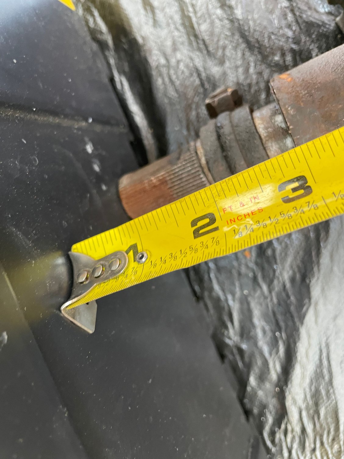

Ron,
I'm looking at the same modification and I'm trying to figure out what to tell the folks at Ididit about modifying the column. Did you just cut 3" off the length of the outer tube? How much did you shorten the shaft? They said that the shaft only sticks out of the tube by 1.5" on the retrofit column so I'm curious what you had to do to the one you bought.

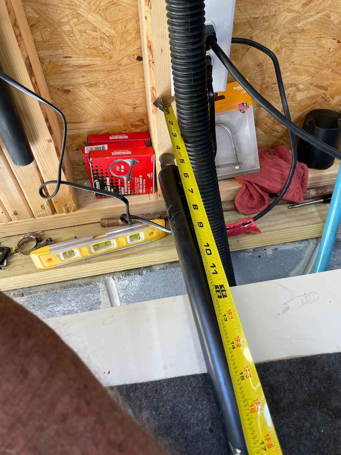

I shortened the outer tube 3”. Once you get the Ididit column apart you will see that the shaft inside can collapse much like the original steering was designed. It’s held together with a roll pin which is easily removed. After you trim the outer tube you can take a measurement for the shaft and make it the length you want it to be.
The best way to determine the length that you need is to lay the old column down next to the new Ididit column and make them match up. This is how I did mine.
Read over this link too, it will help you. https://epasperformance.com/pages/id...assembly-notes

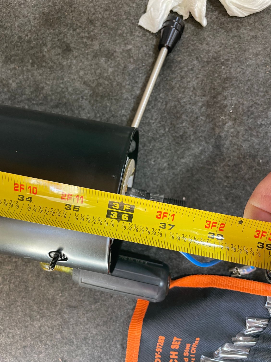

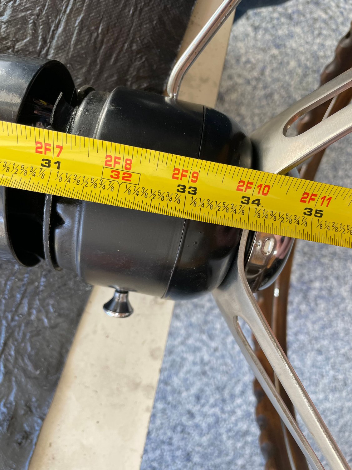

I ordered part 1120700051 from IDIDIT. My column was already shortened because I installed a Borgeson steering box earlier.
Old column measurements
Old column
Ididit column
Ididit measurement
