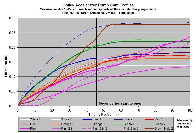

MelWff - I set the pump lever adjustment just before the carbs were installed. That was 2-1/2 years and ~600 miles ago so I'll check that again. JBrooke825 - In looking online at a few of throttle position vs. cam lift graphs, this one (attached) shows the red and pink cams (in hole 1, the broad pink line) profiles are very similar until around 70% of WOT.
