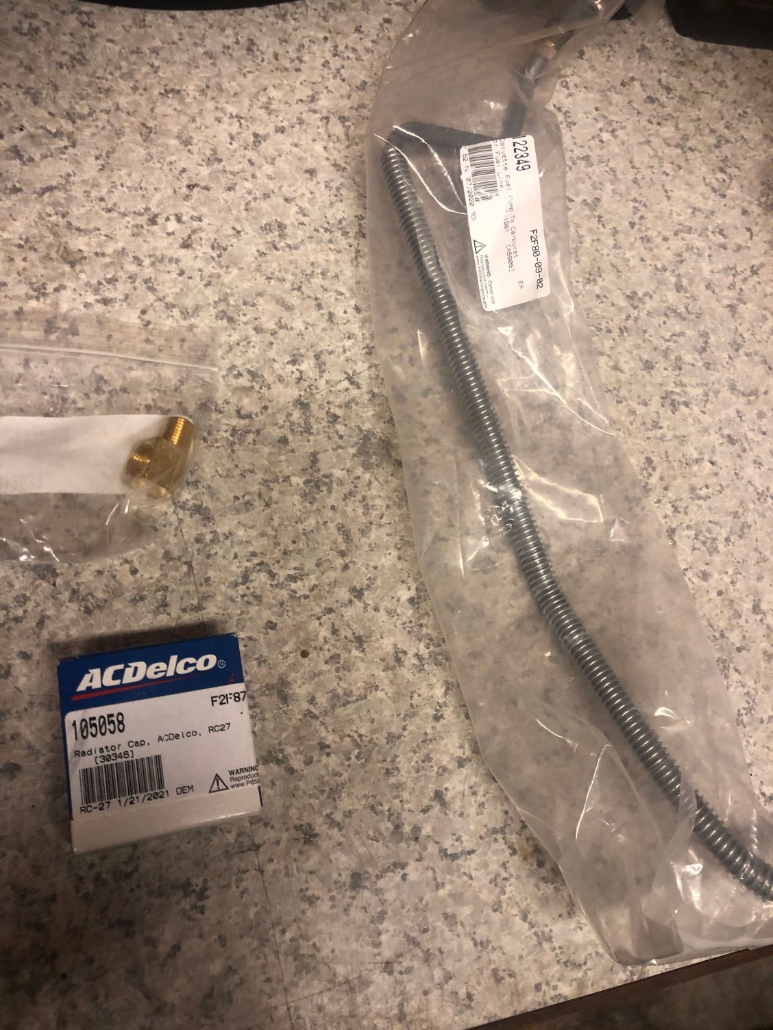

Default Manifold replacement gasket
Originally Posted by resdoggie
You should only need to push the gas pedal once to the floor to set the choke and then start up. That's how it came from the factory and it should be no different now for a properly setup carb. So you still need to investigate why you need 5 times as many pumps to start from cold. Have you tried just one pump? Have you setup the choke to specs?
so I got a little crazy. I had a slight leak at the manifold and ordered a new gasket but then decided to order a new manifold and then a new egr etc. need help identifying some tubes npt piece etc to install clean:
