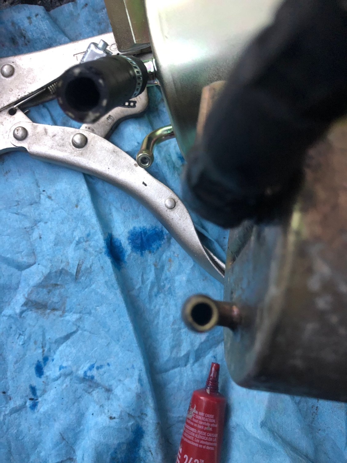

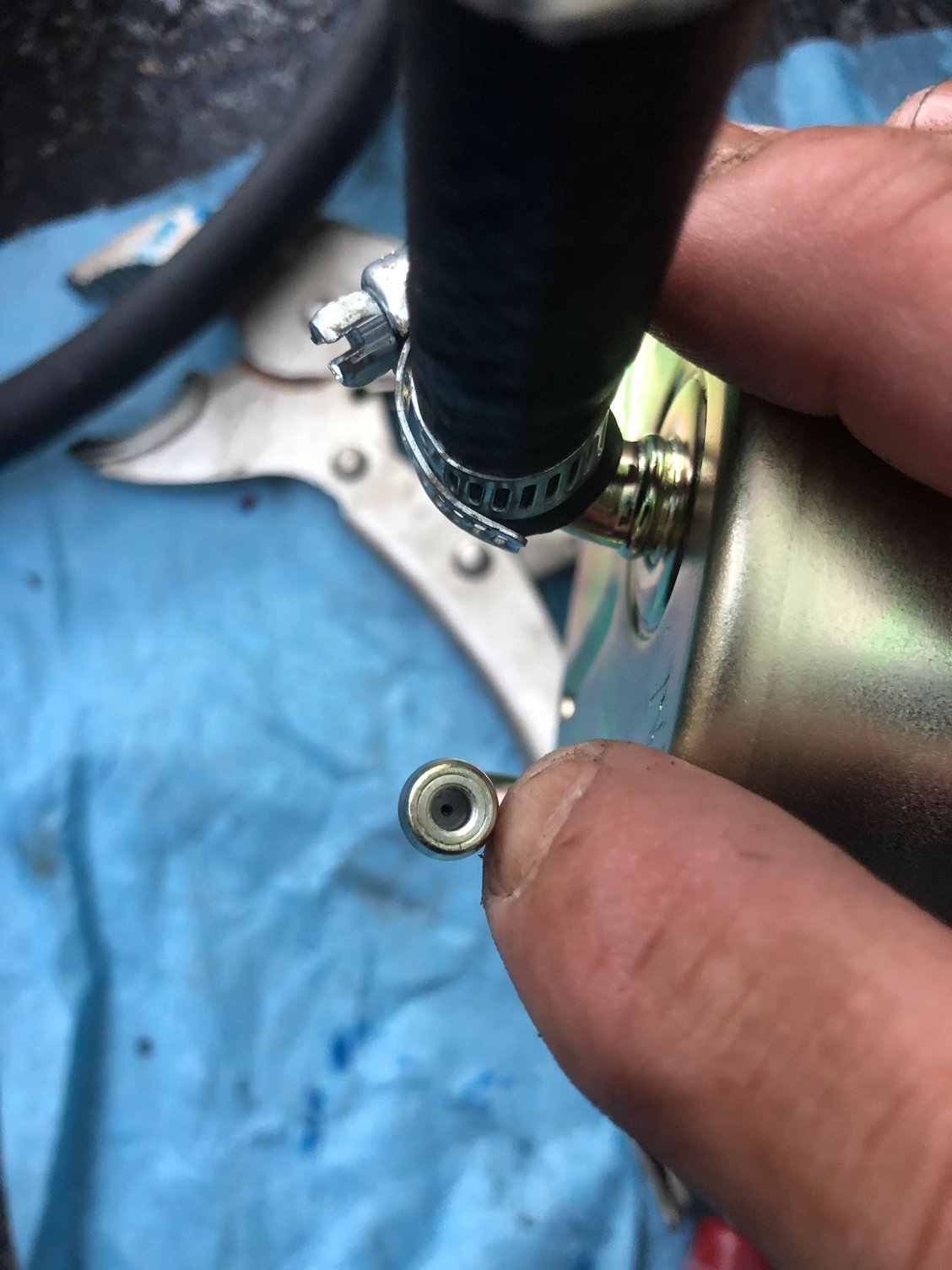

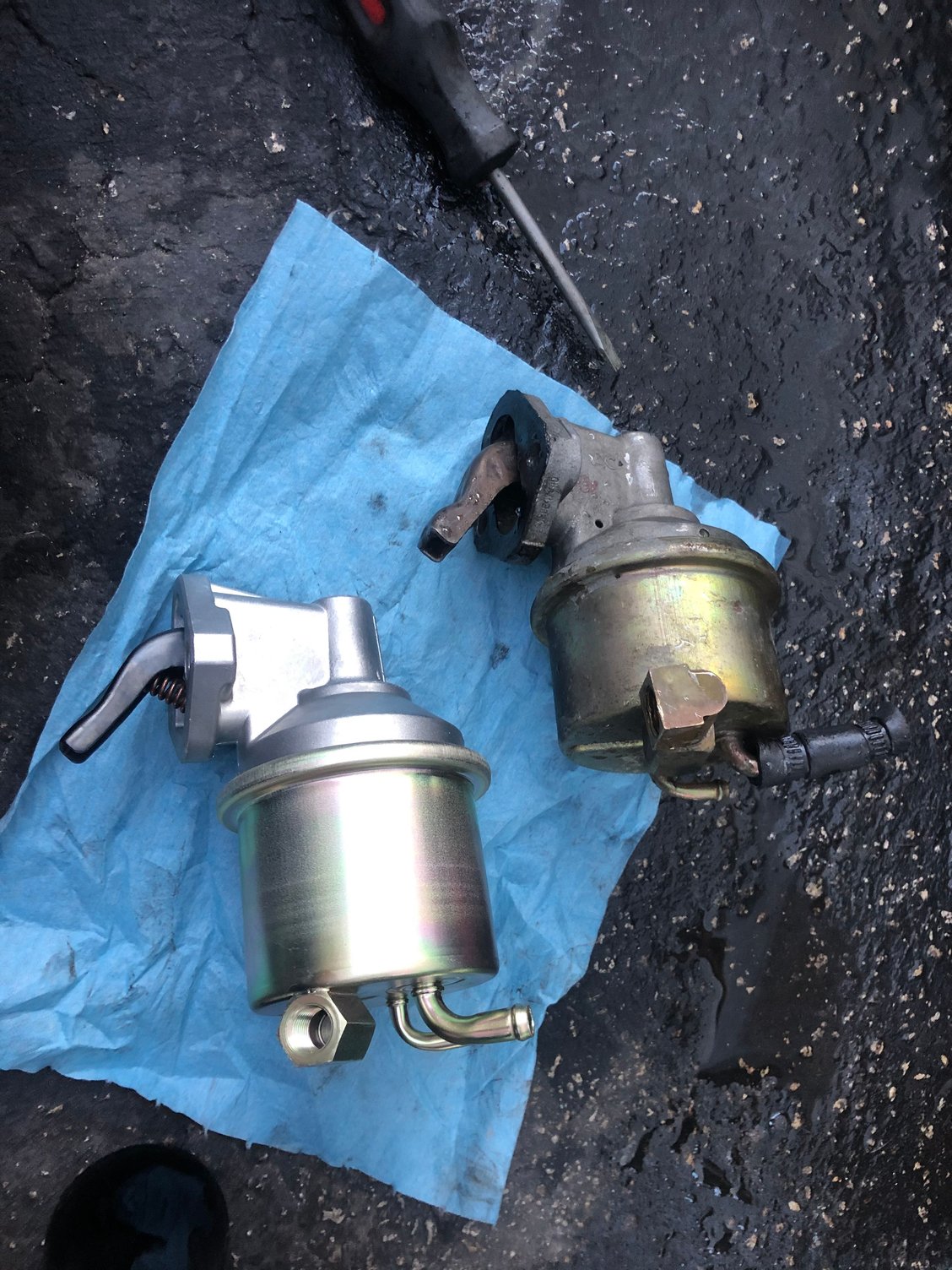

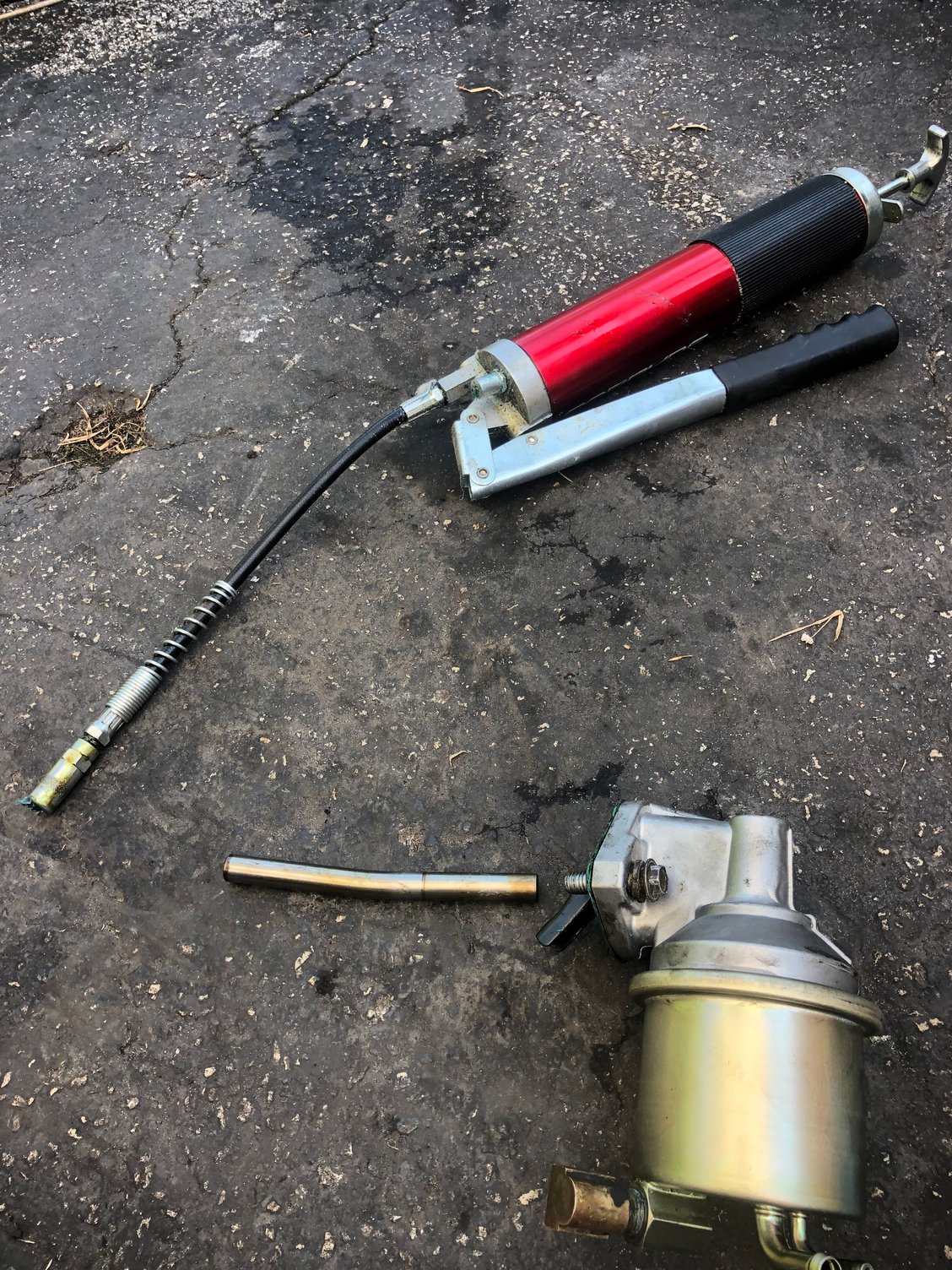

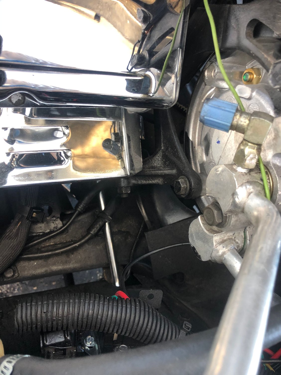

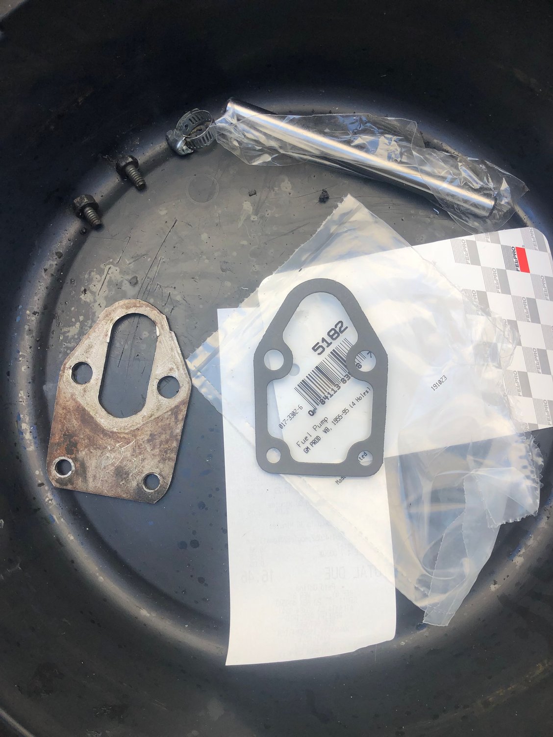

So I got the fuel pump. Instead of researching fully, i decided to pop it in there and realized i bent the fuel rod (see pic) Off to Napa to get another one. While I was at it I bought a gasket for the plate which had none. someone had been in there before because one of the screws was missing a washer. Anyway, I bought high temp grease to keep the rod in place. I put everything back and noticed I wasn't getting any gas thru to the metal pipe going to the carb. Why? because I wasn't patient and didn't pump enough. I kept the pedal down with the metal pipe going to the carb unplugged to see if I got any gas flow. I finally did, as i can hear it spraying into my pan. I tightened it all together and it started up right away. I swapped out the pump to see if I can avoid a 5 pump start, instead of a 1 pump start. Lastly, the original pump did not have the white 'plug' the new one does. When I say original, i mean it. It's stamped and all. I bought an airtex one, as I can't find an ac delco anywhere. Good reviews.

You should measure pressure and flow at end of pipe prior to carb and see what you have.
pumping throttle will only pump what gas is in carb bowl..
i would check flow also did you use s hose for pump? ( pre molded)
also how did you bend rod?

didnt change metal rod used original. Gonna swap it also rubber pipe from gas supply up to fuel pump is all crappy will order new ones. What a cheap butt I am that I would t order it all at the same time. I think I do it purposely so I have an excuse to be down there lol. Anyway this morning 5 pump again. Definitely lines. Lastly I want to send carb to Lars change all the rubbers etc thanks all as usual.

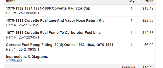

thanks green, ordered on eckler pkus metal pipe.

ordered the following
