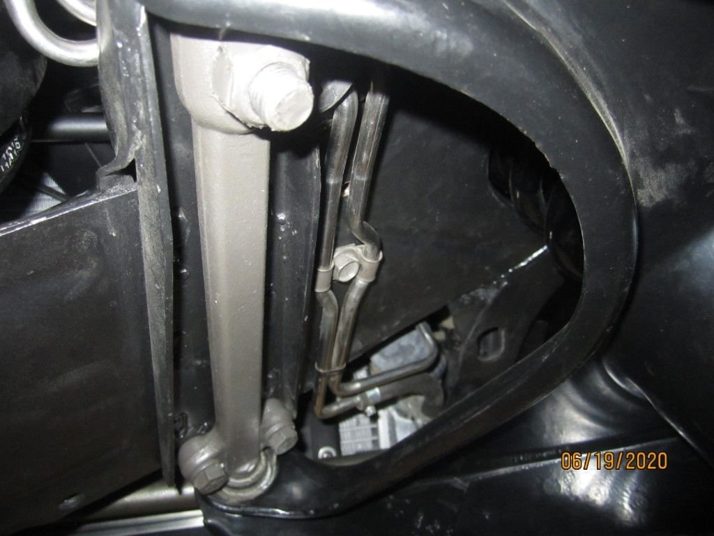

Trans lines run under the A arm or over?

Best to check the AIM
On my 72 they run here
As Mooser shows in the pic, it's kinda between the two A-arms. Look for that double clip's bolt hole to locate the pathway.
To 69bb
