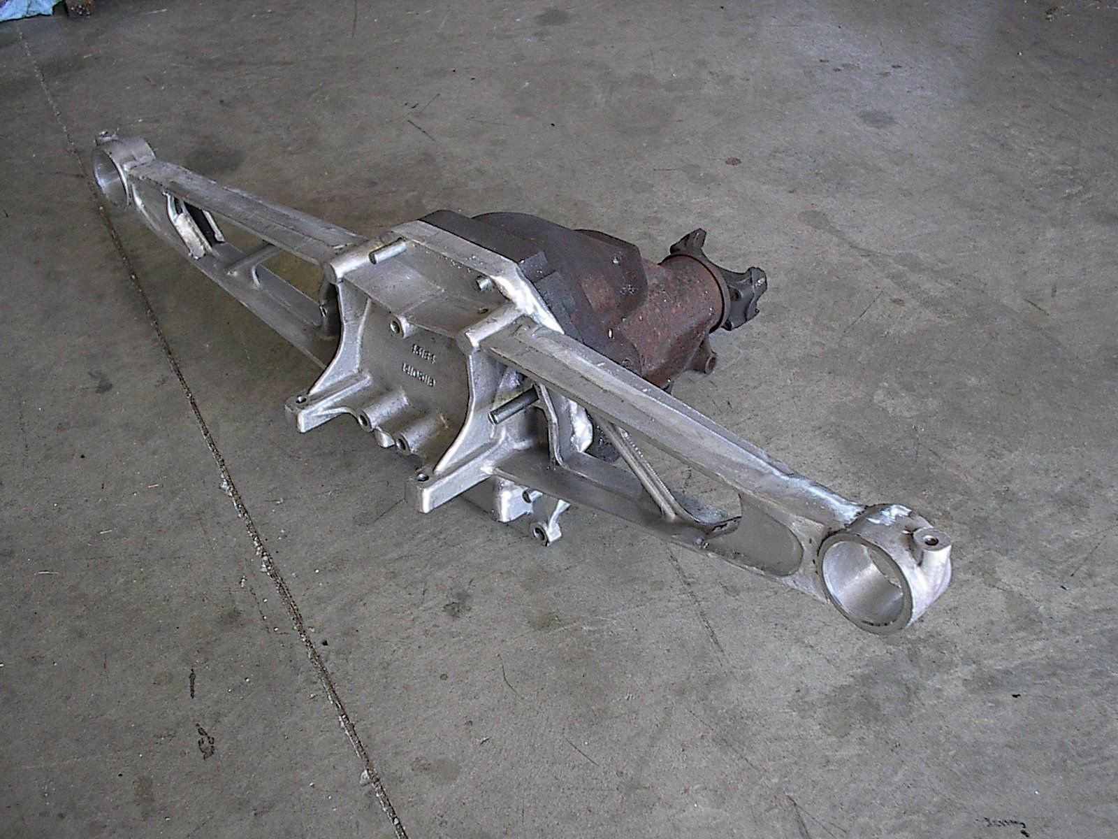

Nope. C4 D44 units are damn expensive, and IIRC they don't package well in the stock C3 floorpan. I'm using the stock C3 differential (strong, cheap, and plentiful) but with a C4 D36 batwing (lighter than the C3/C4 D44 batwings, 20# lighter than the stock C3 cover/crossmember, and dirt cheap and plentiful). Did some cutting, narrowing, welding, and re-drilling to make the D36 batwing fit my differential. Here's an old picture, during the process, doing a test fit on an old C3 case.

Well, it didn't look like a good gamble when I was trying to fit the C4 suspension under my car. I know some guys are having some decent luck, durability-wise, with the C3 D44 unit, but I wasn't in the mood to gamble it behind a big block.
Would have been nice if the volume/economics of the original rear end had allowed continued production but with a change to aluminum in the housing material.
