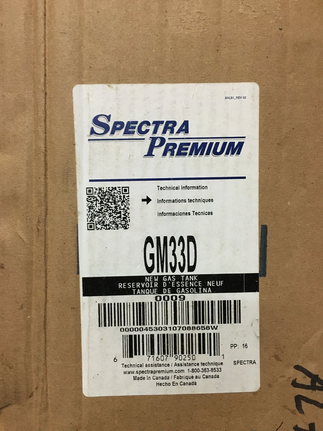

Recently replaced the tank on my 72. The tanks to buy are made by Spectra manufacturered in Canada. Mine was perfect replica of the original. No Anderson logo though. I believe the same part number GM33D fits your ‘74. Check application to be sure and google part number. Multiple sources sell this tank. I bought a new sending unit and all other related parts like anti rattle pads. Use spray adhesive on pads and apply the pads to the tank. They don’t move around when you reinstall the tank. I also used High Tack liquid sealant for the cork gasket from the tank to the filler neck. Suppose to withstand gas better than silicone. It’s not a bad job overall. Good luck.
https://ecat.spectrapremium.com/products/GM33D
Label from the box my tank came in.
