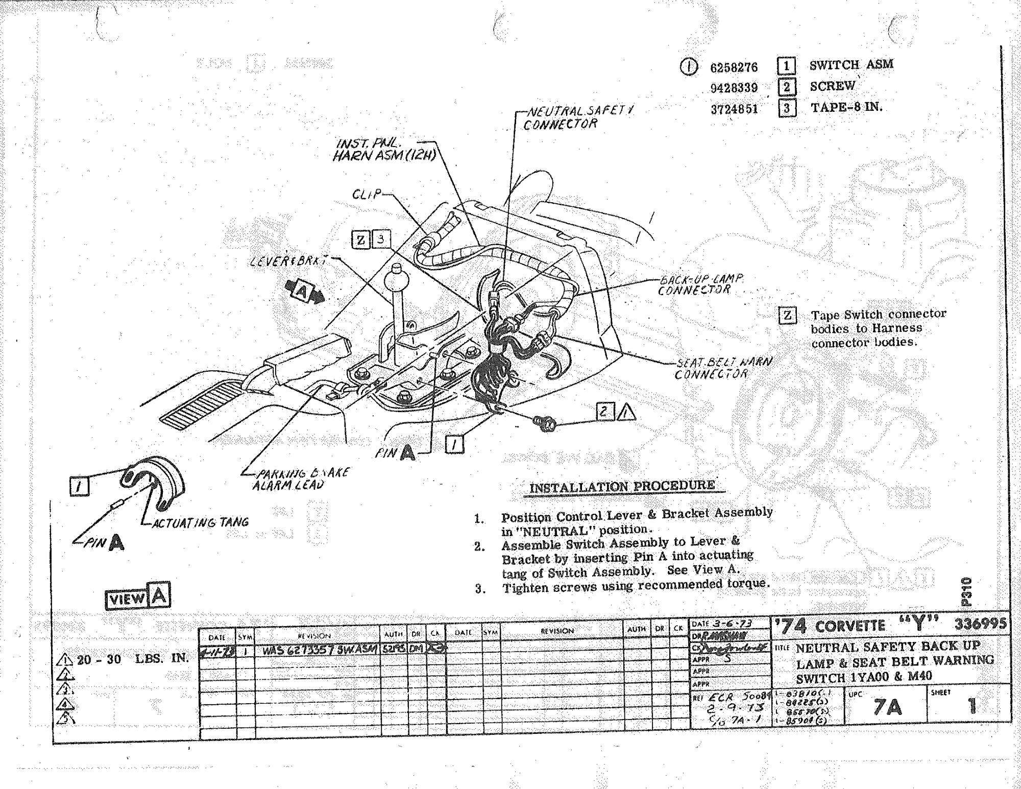

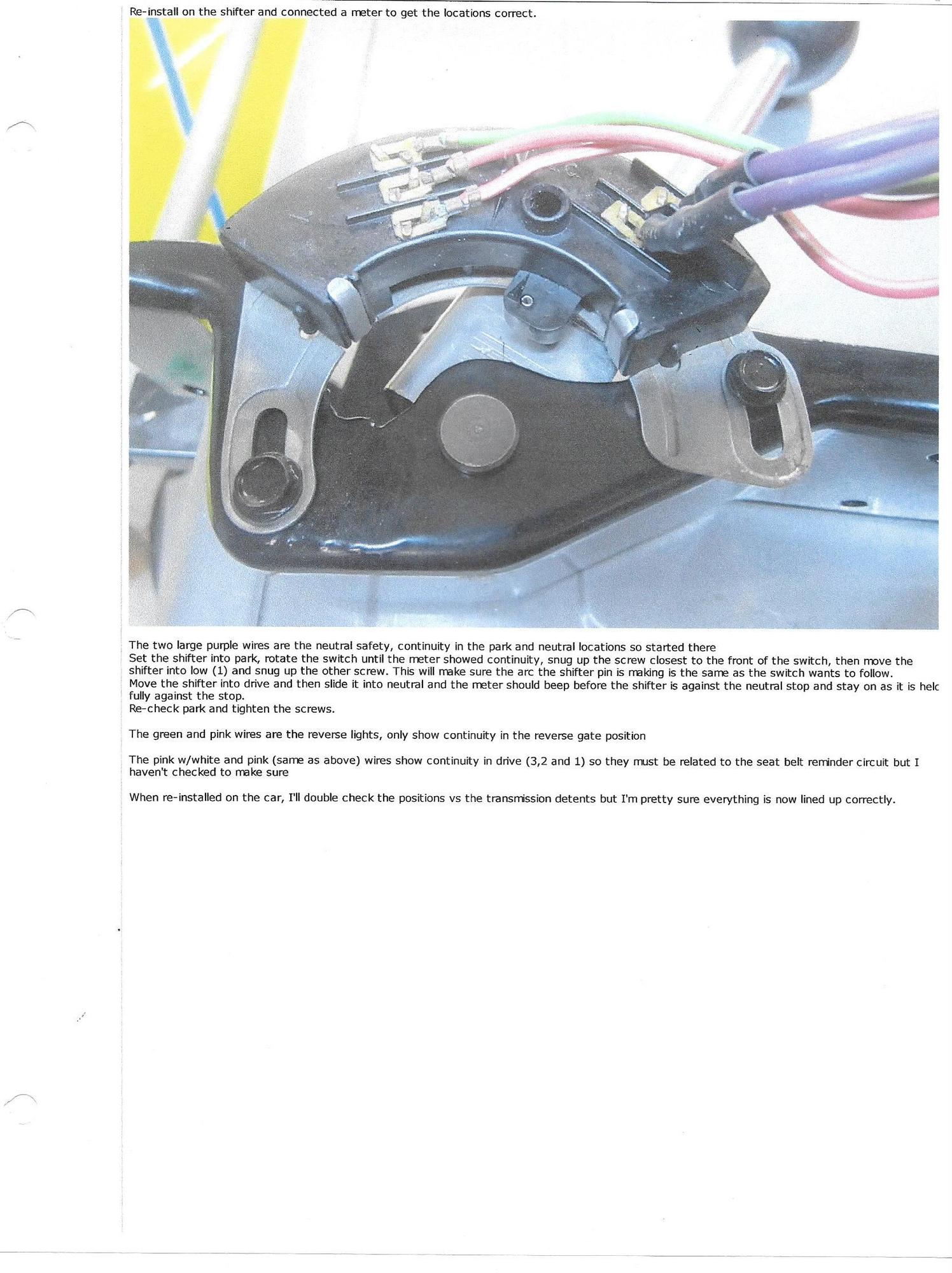

I’m having to replace my neutral safety switch on my 71 automatic. The screws were hard to get to and probably harder to put back in. Any tips on installing them also any other helpful info on adjustment etc?

Default Does this help?
