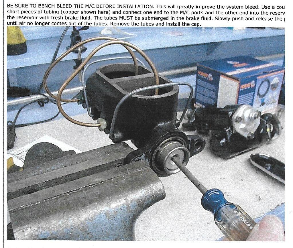

Default Not to worry!
Bleeding your new M/C is easy, here's how:
You can find the M/C bleed kit in the 'help' section at your local auto parts store.
Some M/C's have a deep hole and some are shallow.
Compare your old one.

Bleeding the master isn't hard, if I can do it right on the first try, well, easy. The pics above look good, there are even inexpensive kits made just for this.

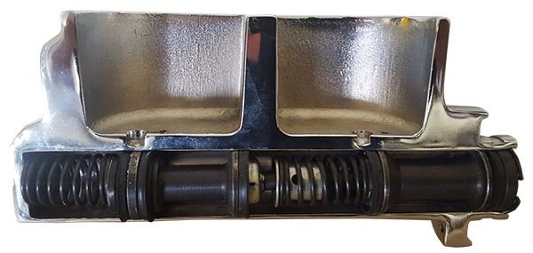

Well thanks but no one answered my question. The reason I ask is because when I disassembled my M/C I had to pull the piston out with long nose plyers. I think the rear spring was installed after the piston. back ackwards.
Old Jan 29, 2021 | 11:11 AM
barkingrats's Avatar
barkingrats
1967 Pedal Car Champion
Joined: Mar 2020
Posts: 9,137
Likes: 4,248
From: US-PNW
Can you post a photo of what you have? The masters that I've rebuilt all had 2 springs and 2 pistons.

Old Jan 29, 2021 | 02:42 PM
michaelroy's Avatar
michaelroy
Joined: Mar 2015
Posts: 306
Likes: 20
From: Greenville SC
Thank you 67:72 the pic is worth a 1000 words. Needed the order in which the parts went into bore. I'm pretty sure mine was assembled wrong from factory. Spring was not 1st part installed in bore.
