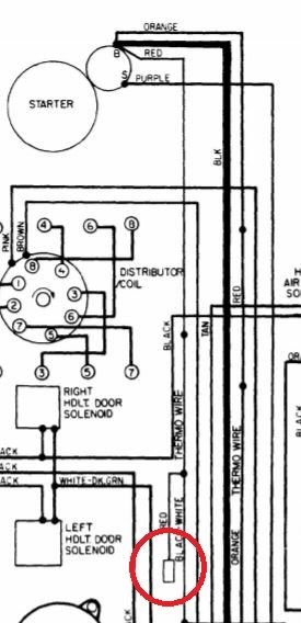

Where does this go on the 1976 wiring diagram (see red circle)? I suspect it's missing a label?

Engine compartment light? Late77 had them- don't know about 76?

+1 for under hood light.
I have one on my early 77, and it has a fusible link since it doesn’t go through the fuse block. That’s what your diagram shows too.
