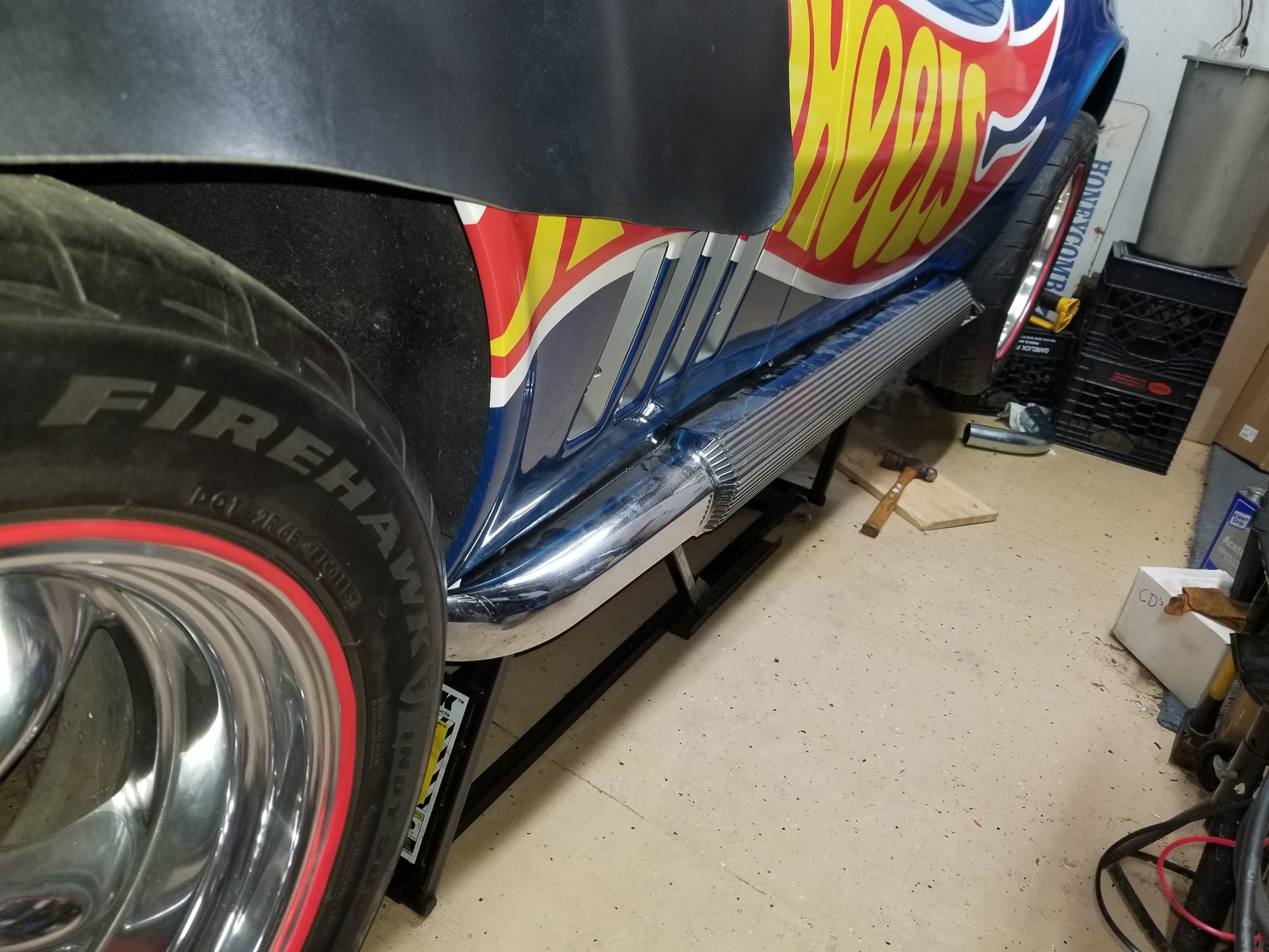

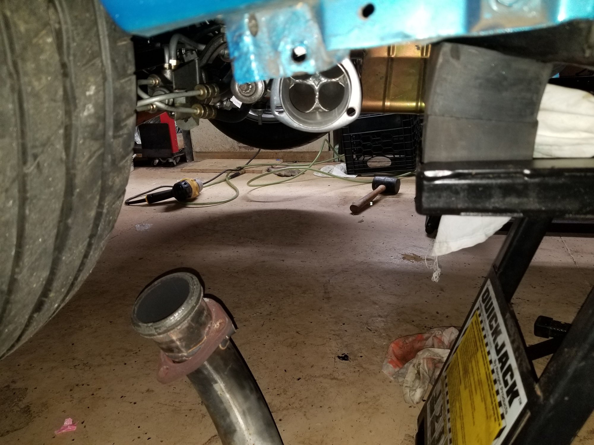

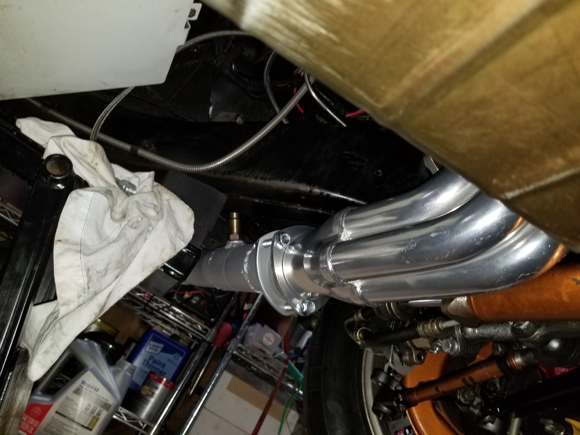

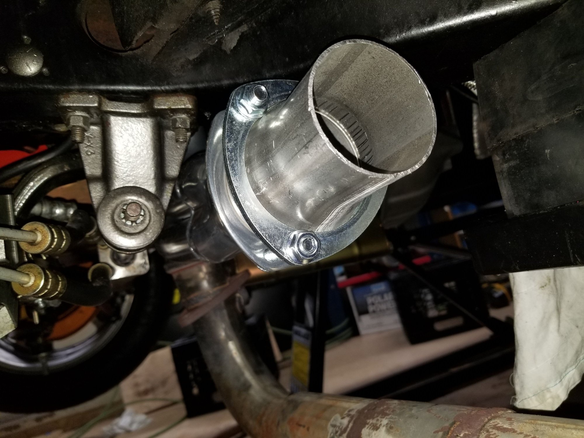

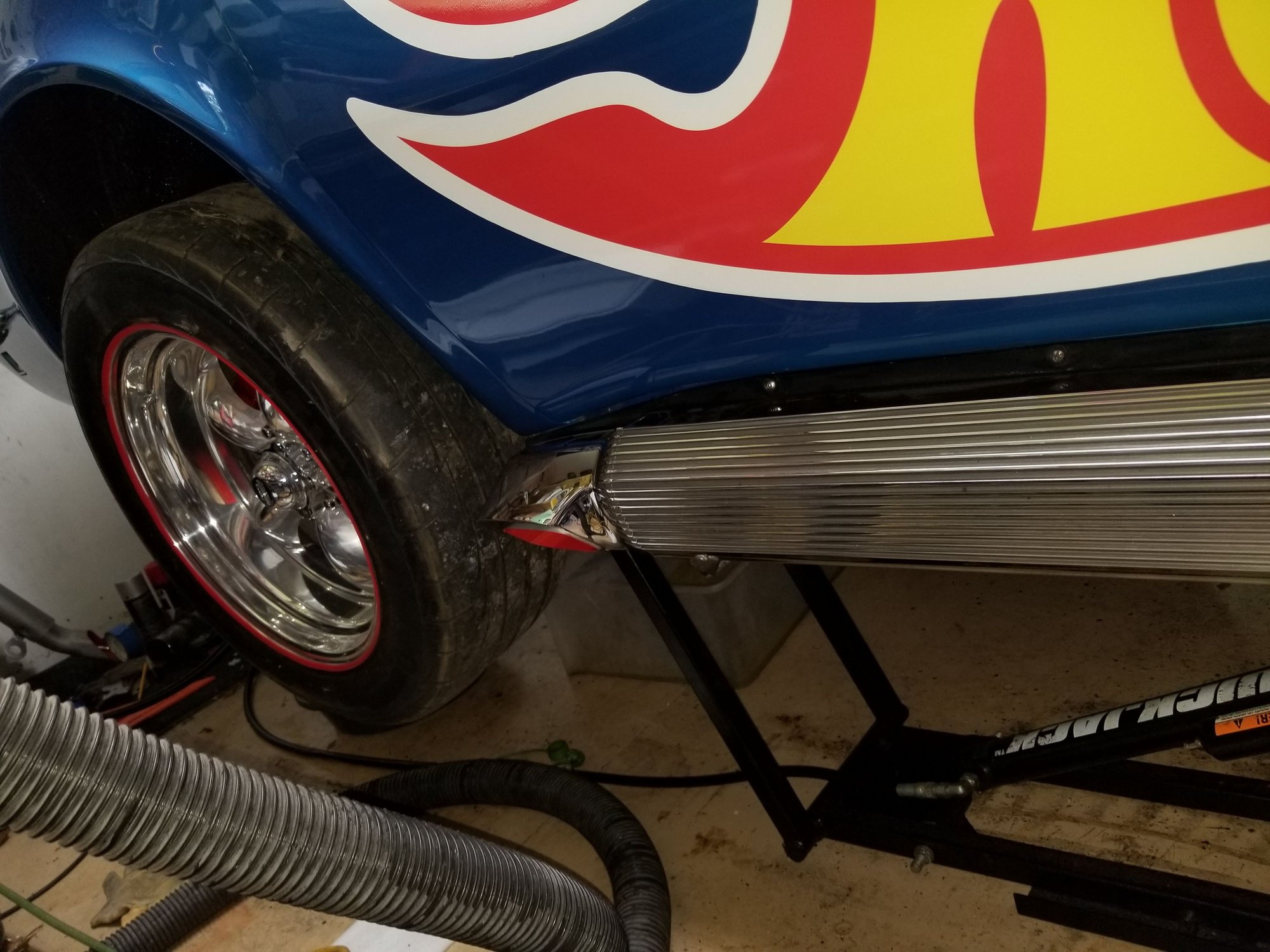

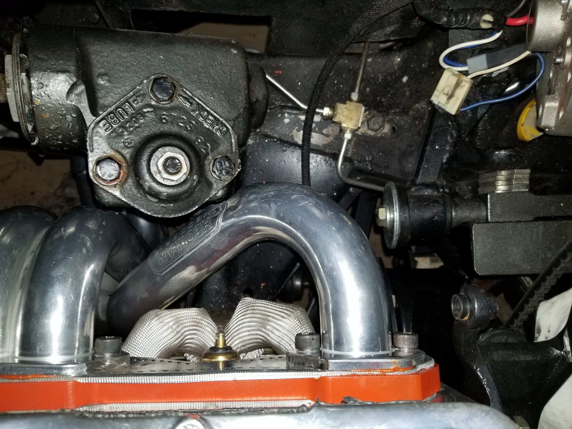

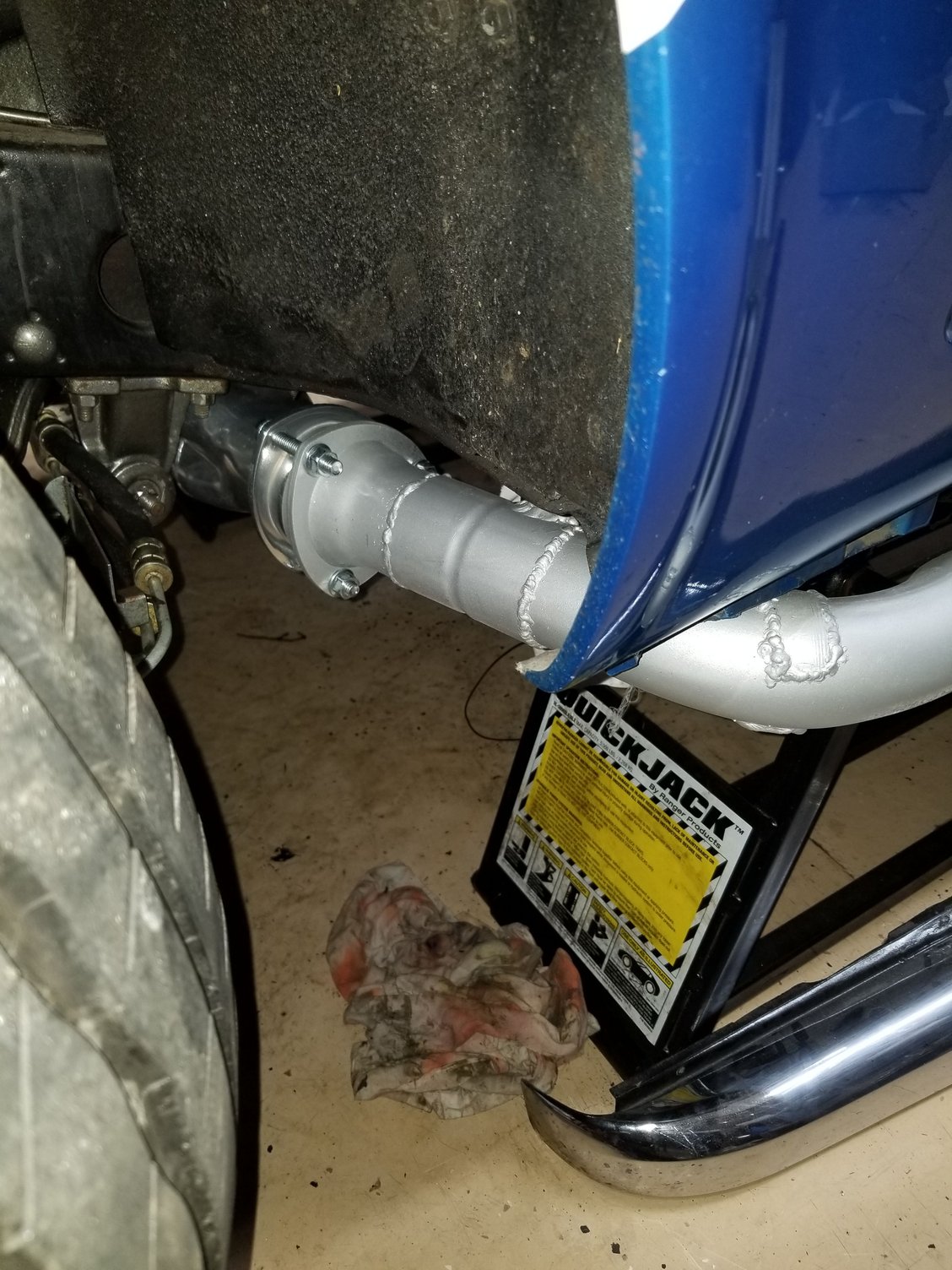

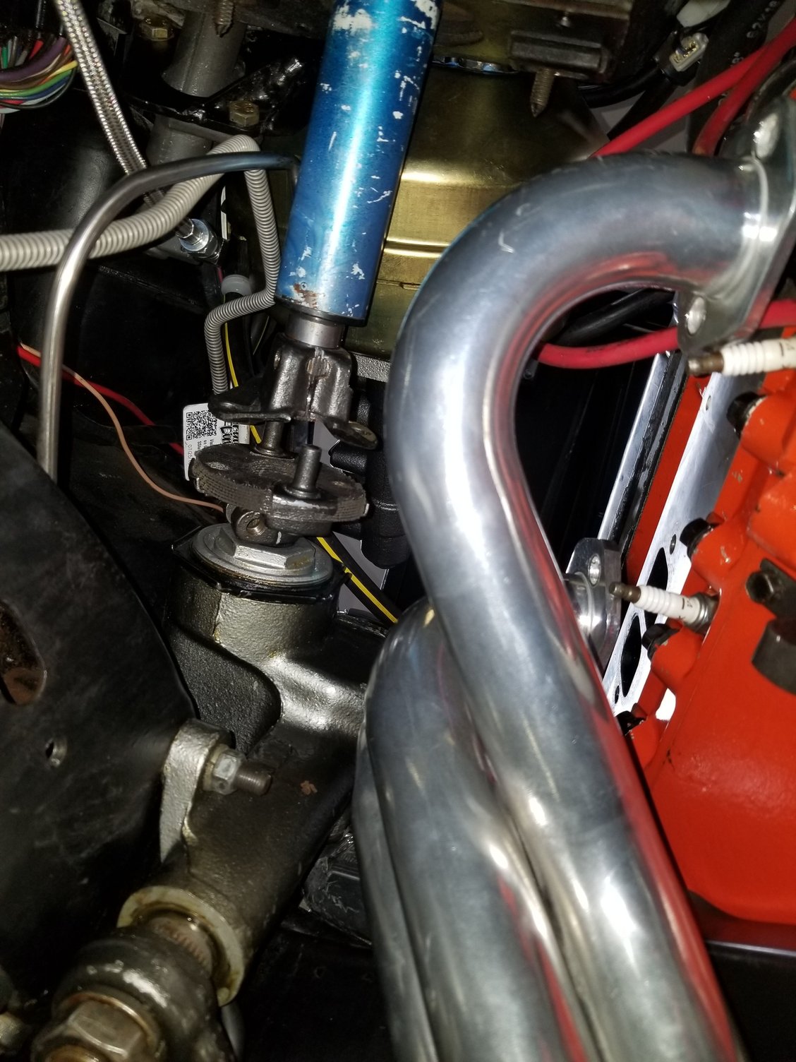

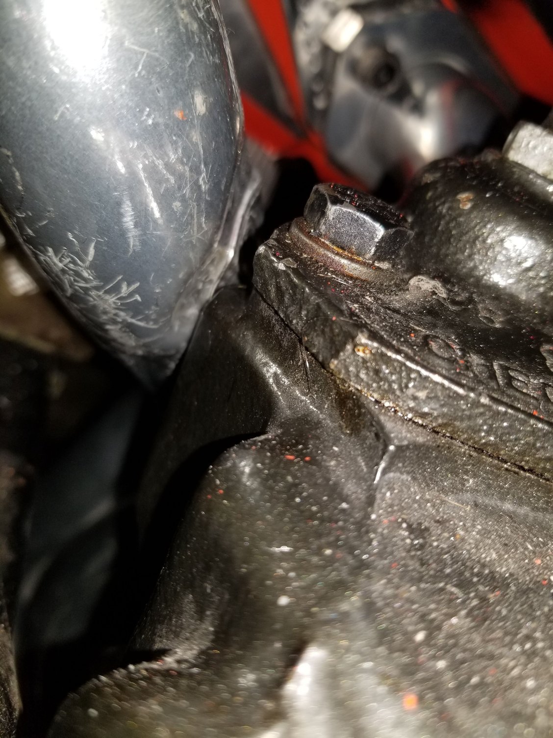

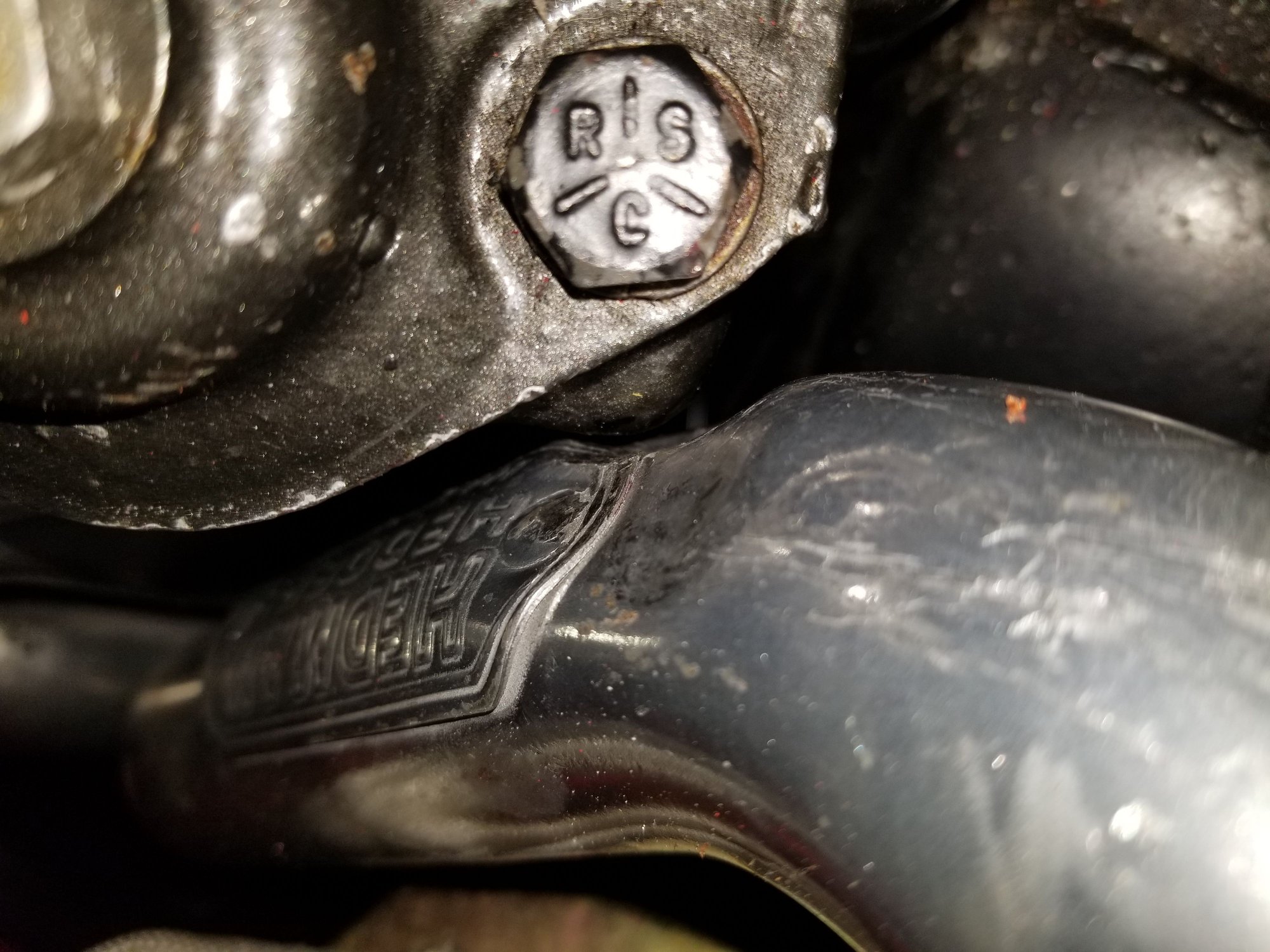

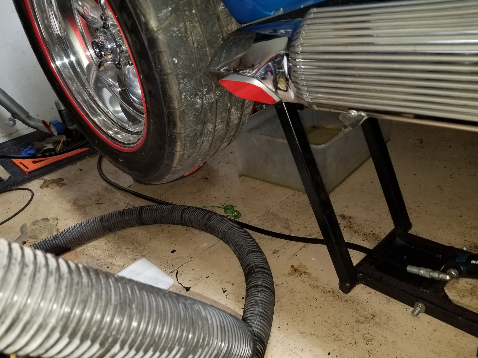

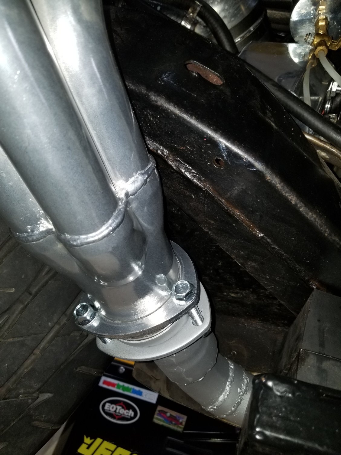

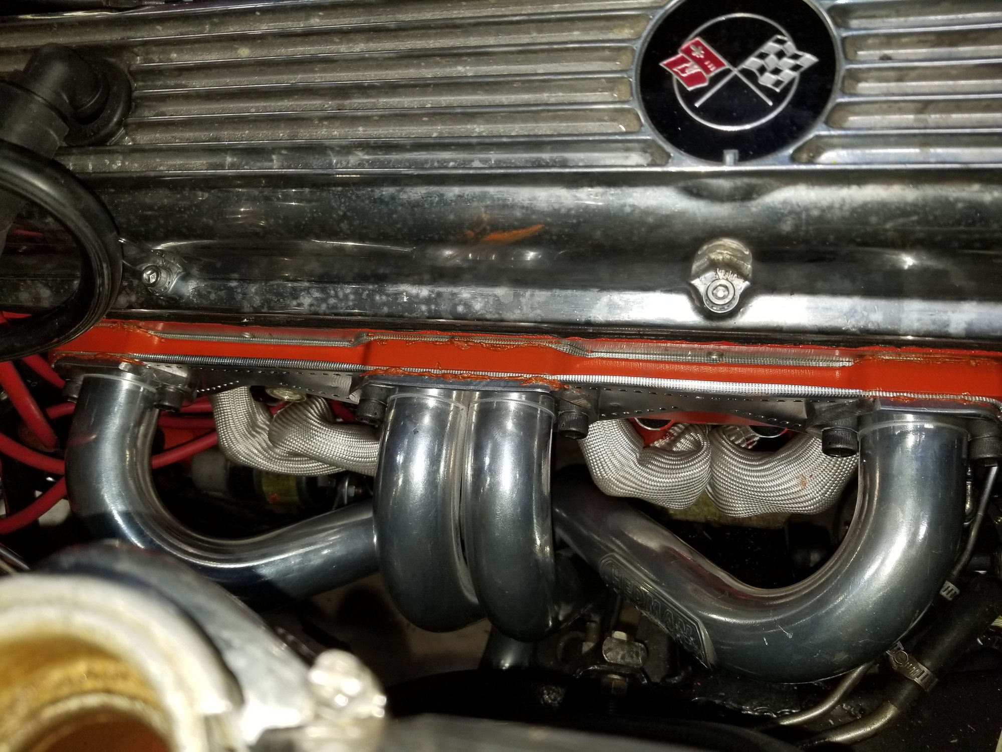

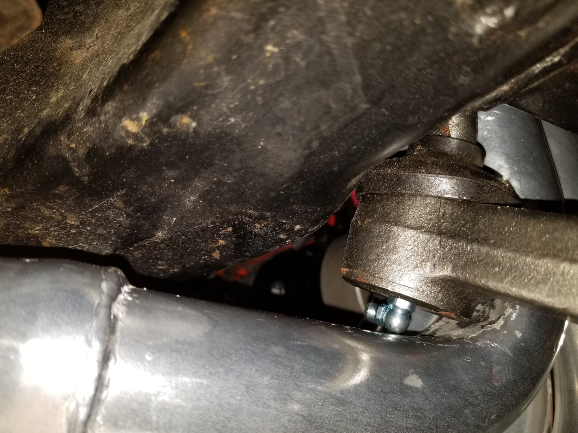

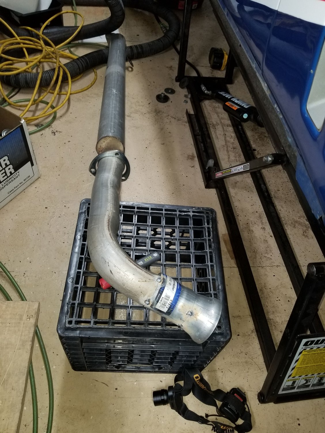

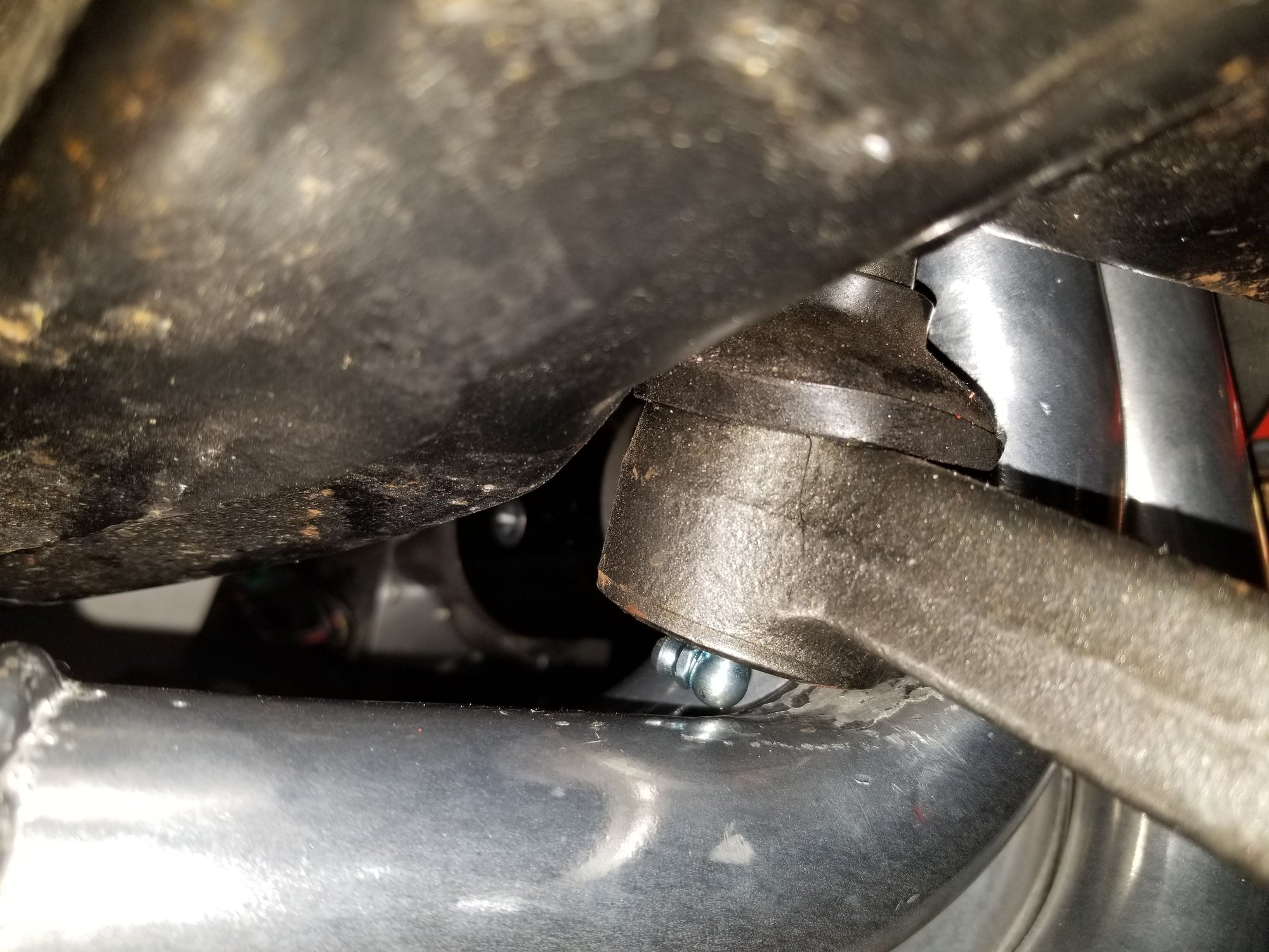

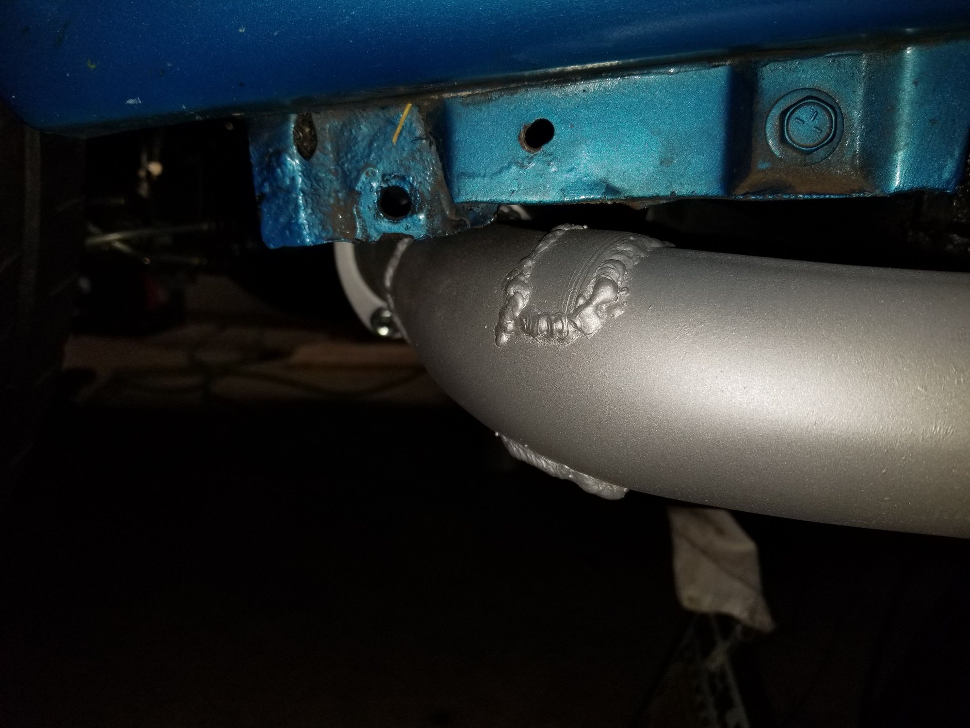

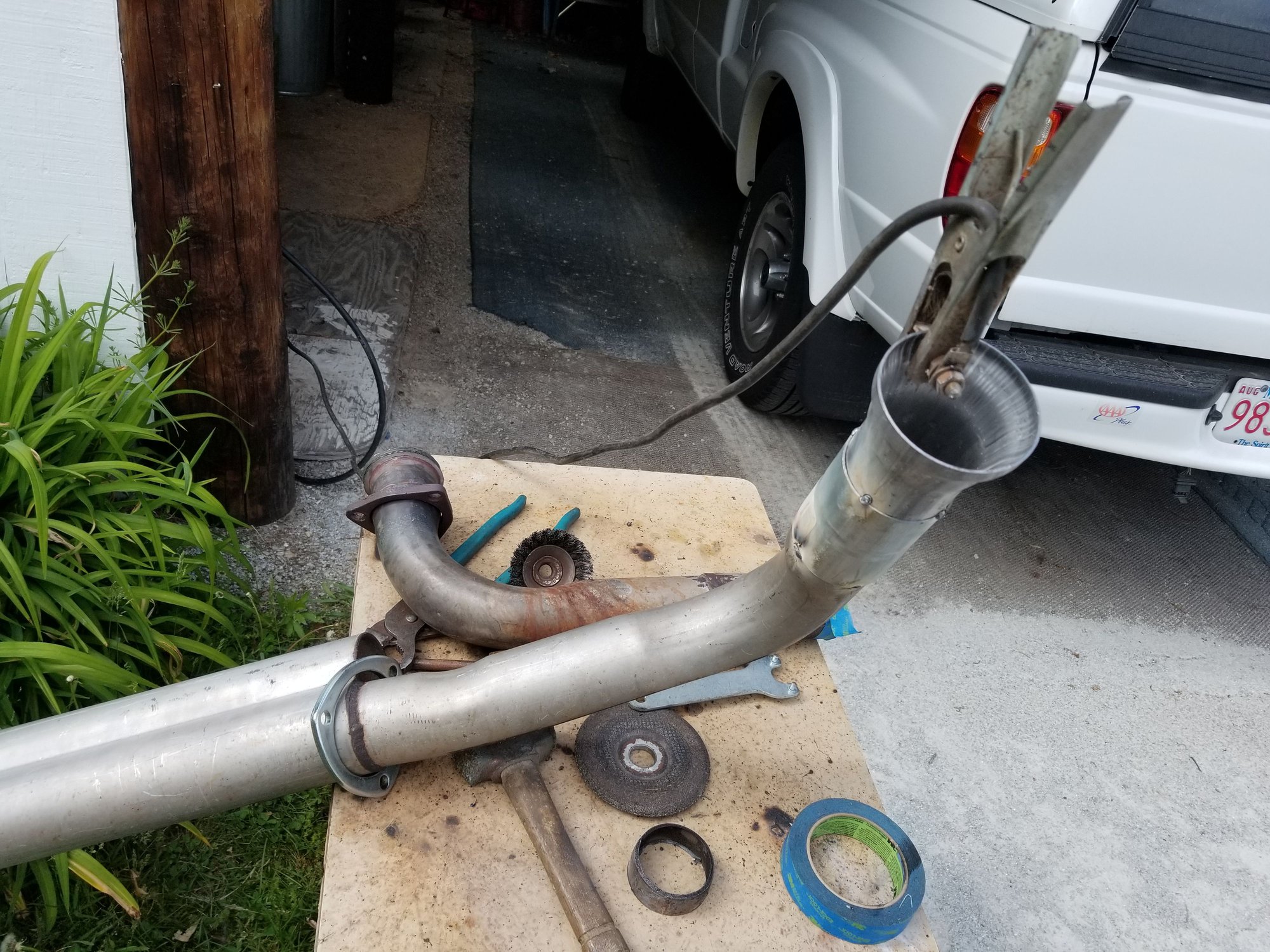

HEdman makes headers for big block and small block. They say they are not for angle plug heads, but I used a marine 1/2" spacer on my small block that eliminated the need to massage the headers at the spark plugs but I still had to massage them at the steering box and the steering stabilizer. I bought the ceramic coated ones and they stayed cool and I didnt notice a cabin temperature increase. Luckily the dents were small and the ceramic coating didnt chip. I had to cut the stock side exhaust off and reweld the new ends on for the collectors. I have a newer set for my big block now that my plan is to massage them and then have them ceramic coated afterward so they have a better chance not to chip.
https://www.summitracing.com/search/...e%3aside-mount
spacer
massaged area
plenty of plug room
massaged areas
I had to cut the 90 degree angle t open it up a few degrees for better alignment. Then patched it
final mount before the covers went on

So it looks like they have as much clearance as the side pipes and don't come in contact with any part of the body?
Old Feb 3, 2021 | 03:54 AM
Rescue Rogers's Avatar
Rescue Rogers
Is my vette stock?? HAHA
Joined: Oct 2015
Posts: 20,216
Likes: 9,354
2016 C3 of Year Finalist
yes, you are using the stock pipe under the frame and body
