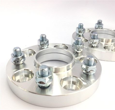

Use this style. They come in many thicknesses. Much safer/stronger and you don't lose any stud grip.

That was my first thought Greg...I haven't been able to find anything like that in 1/4...

If you use the 1/4" spacer make sure it's the billet machined spacer not the cast universal fit type.

Yes...the front spacers were custom made...hubcentric I believe...made to fit the back of the wheel...

Try these then:
This is not the exact one for your car but they will probably have the right ones. Here's a link to the seller:
https://www.ebay.com/itm/2pc-1-4-Whe...EAAOSwLShe5BTI
