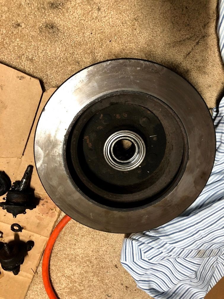

Looking at rotor options. I see some kits that have rotors with wheel studs and some do not. I didn't really pay it much attention when I had it apart. If you get ones without the wheels studs, how hard is it to take the old studs out and swap them? Should you just buy new studs when you get the rotors?

It seems I have mislead a little. Not on purpose. My desire is to change rotors. I put new wheels on and they show the brakes as opposed to the originals that cover up the brakes. So I am wanting rotors that dress up the car some. When I took the brakes apart doing the suspension rebuild it was this:
The studs are not broken, but this was one assembly. Now looking at rotors, some of them are just the rotor and some include the hub with the studs. Most are just the rotor. So I need to separate the hub from the rotor. This, I have never done before. That statement is a common theme with me as this is my first "project" car.
Sounds like I just drill the rivets out to get the thing apart. I can probably handle that part. Then what? How do I get them back together? Do they need to go back together? Or, do you just sandwich the rotor back on by tightening the lug nuts?
The goal is to make this look a little better and up to date.
I would love to put bigger brakes and fill the wheel more, but that would be a lot of money.
