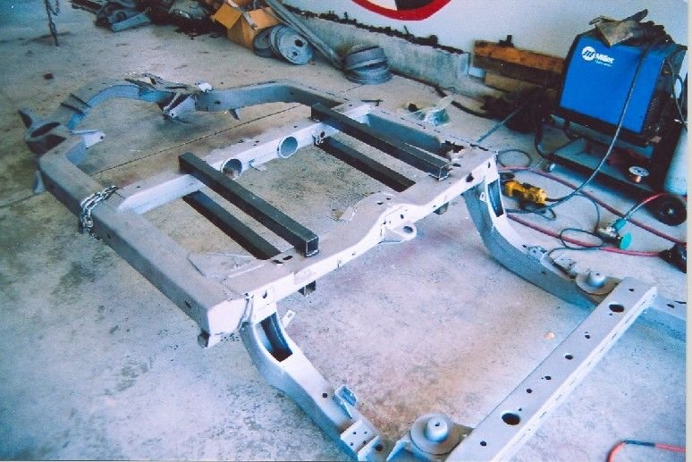

I've done quite a bit of frame welding. The problem in doing the bracket weld that you're referring to is that the crossmember that the snubber bracket welds to is actually pretty thin-walled. If the snubber bracket is rusted through, the wall thickness of the crossmember is also rusty and reduced in thickness, even if it's not rusted through. In order to do the weld, you have to grind or blast all of the rust off the crossmember in the weld joint area, and chances are good that you'll grind through the crossmember wall, or reduce the thickness so much that the weld may not be possible. If you have adequate wall thickness on the crossmember, the weld is easy enough: You cut the existing bracket off using a high speed cutoff wheel and a grinder. You then grind/remove all rust in the weld area on the crossmember, weld prep the new bracket, and weld it on. Biggest problem, if the crossmember is sound, is that you may not be able to get to the welds on the top side of the crossmember that weld the upper flanges to the top of the crossmember with the body on the frame:
Note the welds on the top, rear-slanting surface of the crossmember holding the left and right upper flanges to the crossmember. You need to take a critical look at the position of these welds to see if they can be done with the body on the frame:
If not, you'll need to weld those flanges with a fillet weld from the bottom, assuming you can get to the old welds to grind them off. It will be a bit tricky with a lot of overhead welding, which few people can do well...
A frame weld repair in process in my workshop, showing the snubber bracket welded to the crossmember:
If your snubber bracket is all rusted out on its bottom surface with the big round hole in it, and if the left and right vertical walls of the bracket are not rusted through (since they are vertical, they usually won't rust), you'd be best off just cutting the bottom surface off the bracket and fabricating a new surface with the hole in it (or cut that surface out of your new bracket) to weld back into the bracket - much less work with a much higher probability of success.
