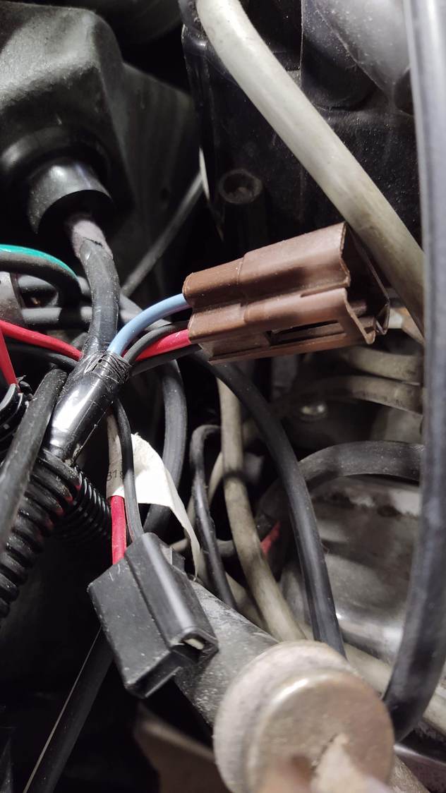

Trying to figure a wiring challenge on the 79. I have replaced the AC harness and all harness in the engine bay. However, when I orderd the starter harness I did not get one for an AUX fan as it had been removed at some time in the past and didn't realize it originally had one. The AC harness has the connector for what I assume is the AUX fan connection. Is there a way I can jump these connections so everything works correctly. From what it looks like, I think jumping the red to red and then the blue and black to the black in the other connection would be correct as it would see it as the switch in an always ON setting. Is this correct or am I missing something? Thanks for the help.

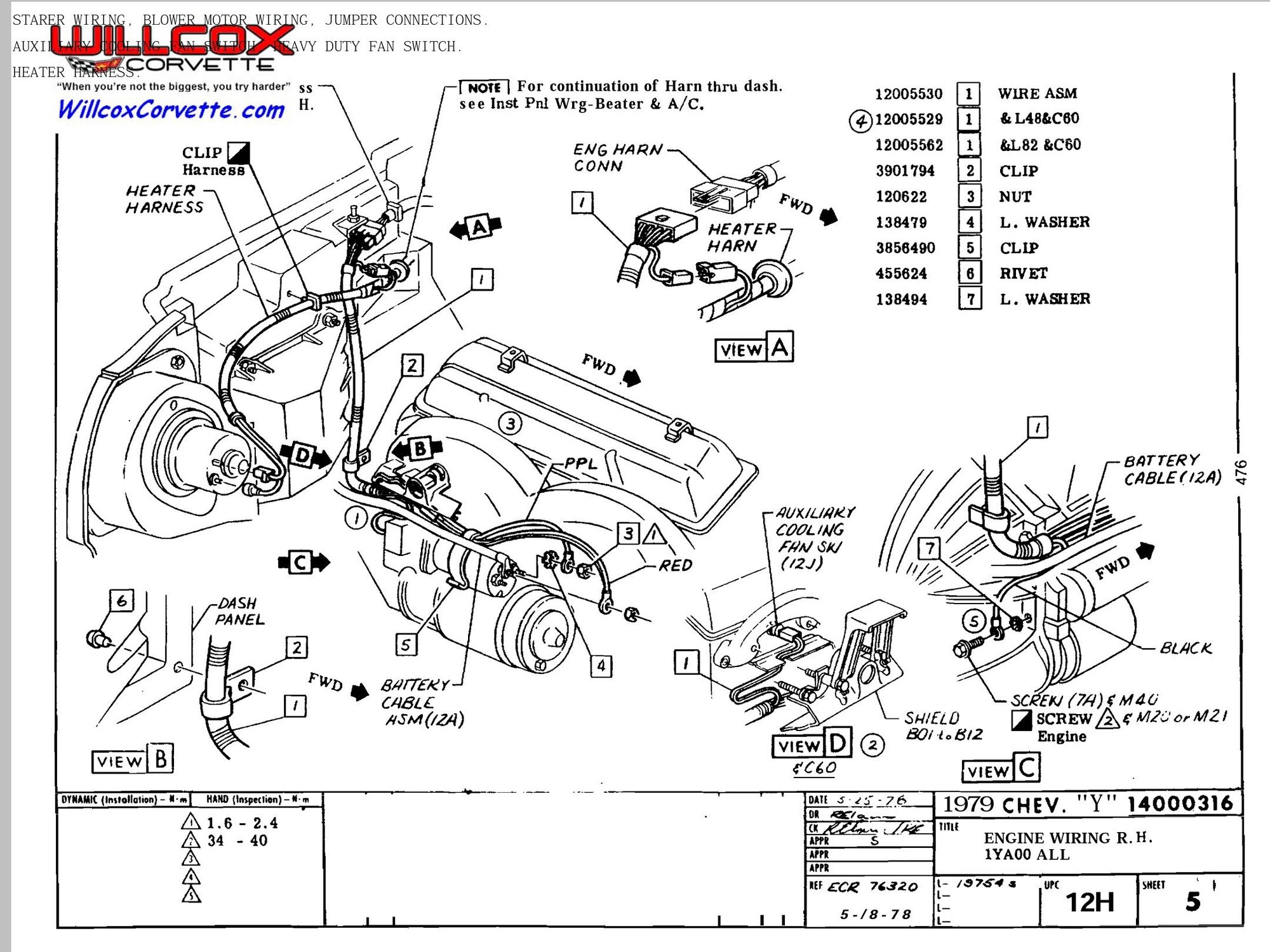

Does this help?
need a pic of something?
i havestarter wiring pics here
https://www.corvetteforum.com/forums...-starting.html

Very nice. Yes that helps with a few things I wanted to verify, but still not sure about if I can jump the wires or not since I do not have the fan or the correct connection on the starter harness.

Not sure about what your jumping..
on my 79 the temperature switch grounds the fan and it turns on..two wires to the sensor..i just jumper it in summer so it runs all the time and helps ac...and like now it is just open and off...temperature sensorwonky anyway and very high set point and not cheap

Thanks. That actually answers my question about which wires to connect where.

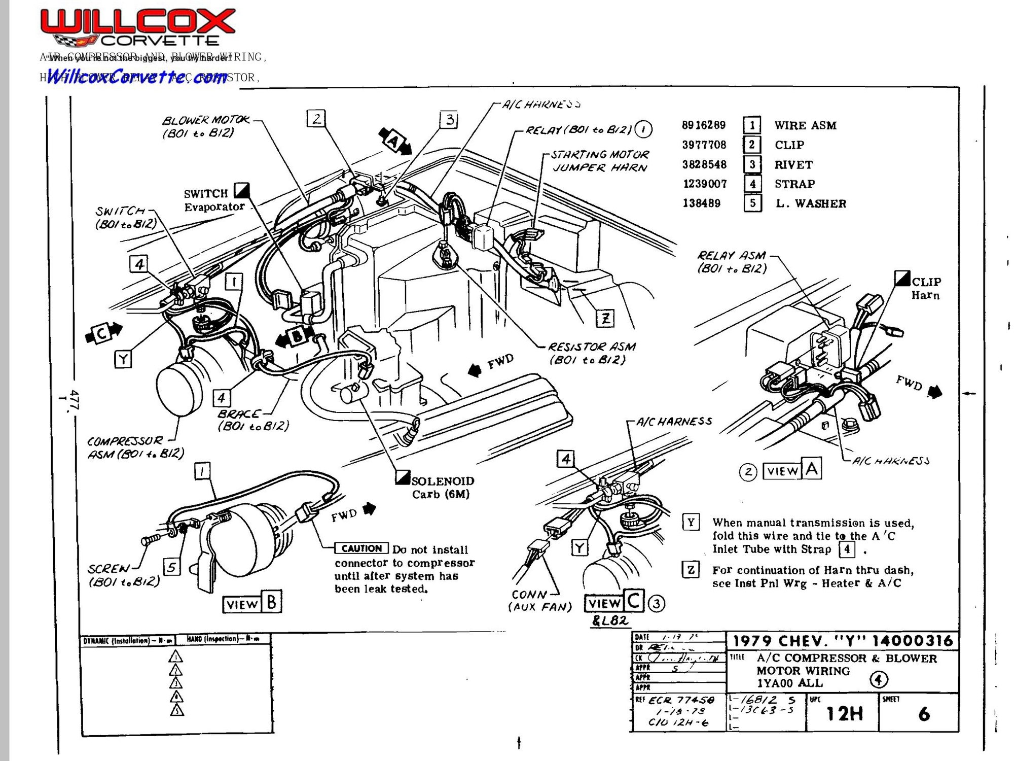

Heres couple more
