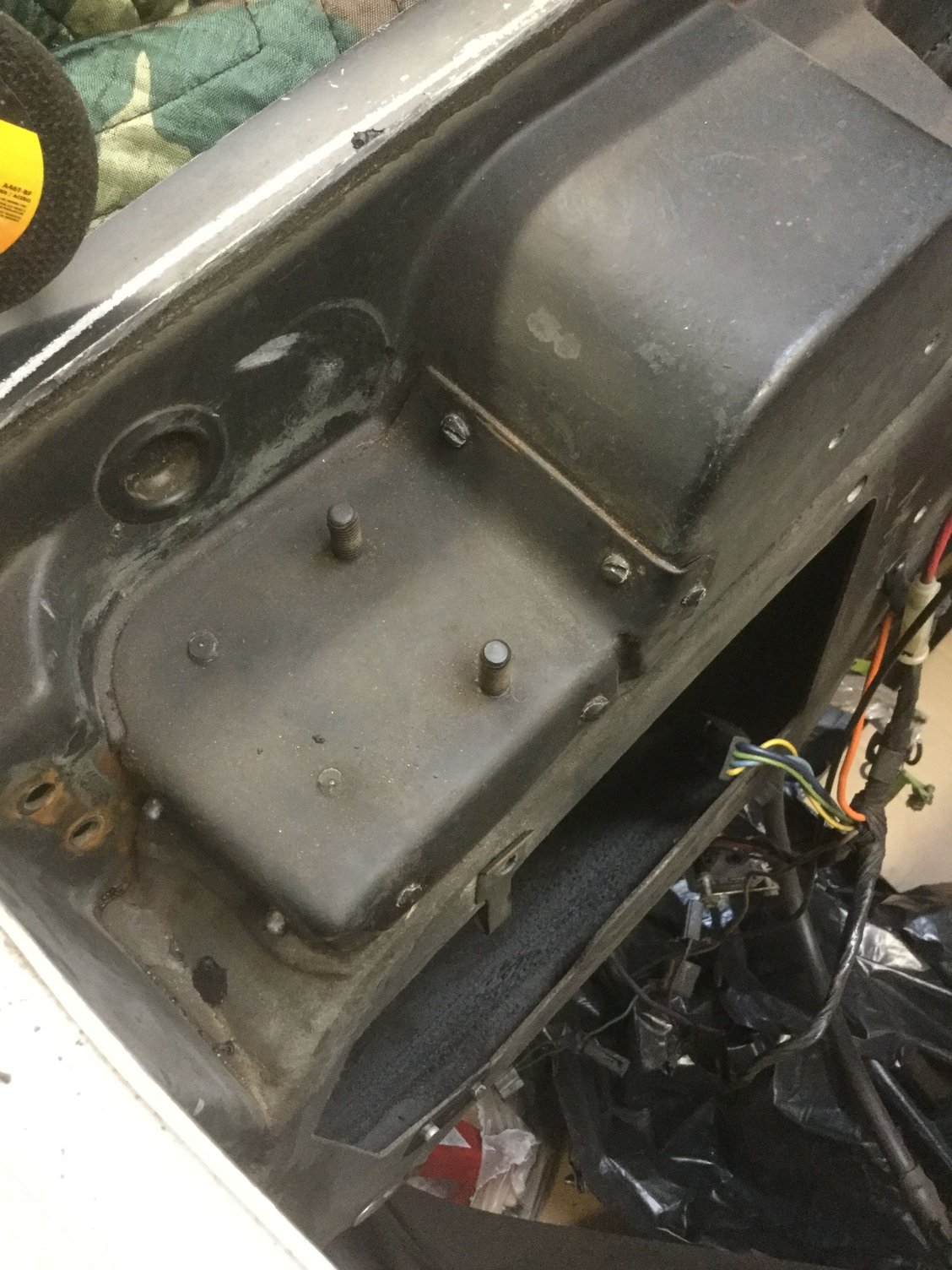

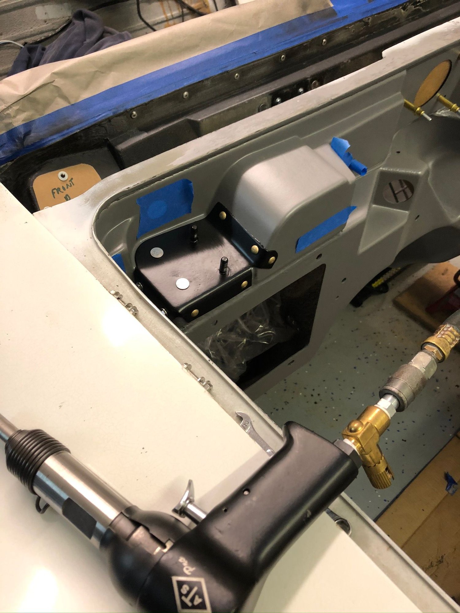

I feel your pain. I cannot say if the 1978 is the same but on my 1976 the engineers at GM thought of this problem and provided a clunky but workable solution. On the wiper Bay Area side of the firewall there is a plastic cap plug that with the correctly bent tool(steel rod) you can push the tab and release the latch from the pin that is on the lower side of the hood itself. This is a bit tricky but it can be done. I know from experience. Below is a picture of where that cap plug is located on the firewall. Much harder to see when hood is in the way. I do not have a picture of the hood latch itself but maybe another forum member does and can post it to indice exactly where you need to push to release the latch. You are basically doing what the cable does. Good luck.
Spring assembly removed but you can see plastic plug.
Top left is where hole is located.
You can see access hole has blue tape on it, plug not installed.

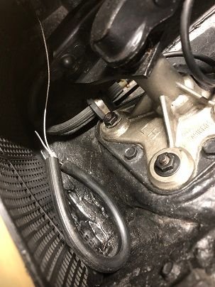

They sell a kit, but I just ran a thin cable from the latch through the firewall and made a loop at the end.
Very easy to reach under the hood. Pulling it releases the hood if the cable from in the car lets go.
Actually I open the hood with it pretty much most of the time now.
Of course if the cross cable breaks all bets are off, but one could be put on the other side also.
