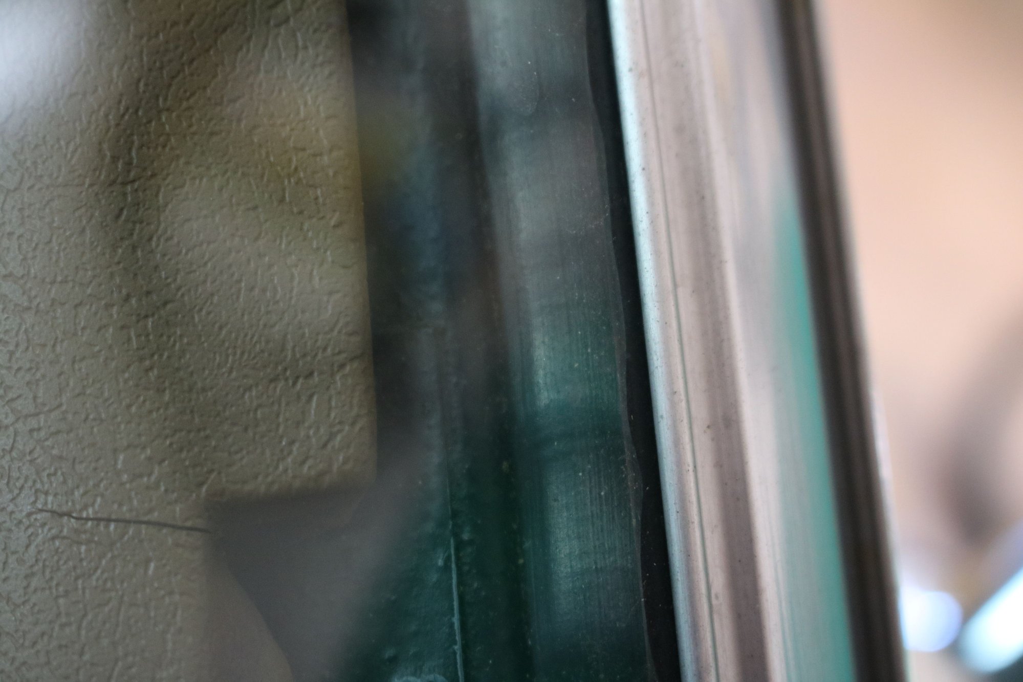

Safe-lite replaced mine but it's been at least 10 years ago. Tech that did it used modern glue and luckily he was a muscle car guy (We talked about his 1970 Chevelle as he worked) and said he was the local Safe-lite vintage car installer. Since he used the modern "caulk gun" type glue I was worried that the windshield would sit too far into the pocket and cause a big gap between it and the stainless steel trim. He had the solution which was to put a thick bead of glue to raise the windshield up to the proper location. He said he's done 100's of '60's and 70's muscle cars this way. It turned out great. Another good thing about using the modern glue is most modern car windshield actually are part of the body stiffness integrity so the modern glue is much stronger than the old butyl tape. I noticed my convertible windshield frame doesn't move as much as it did with the original windshield installed.
Here is a picture of the glue:

Did mine the exact same way. Been in the car 9 years now with no issues. That product is called windshield urethane adhesive. The trick is to use the setting blocks and use the stainless trim to serve as a gauge. Only press the windshield in until the trim fits nice a flush. Removing a windshield that has been urethaned in is a little more challenging. A sawzaw with a putty knife attachment will do the trick. 😎
