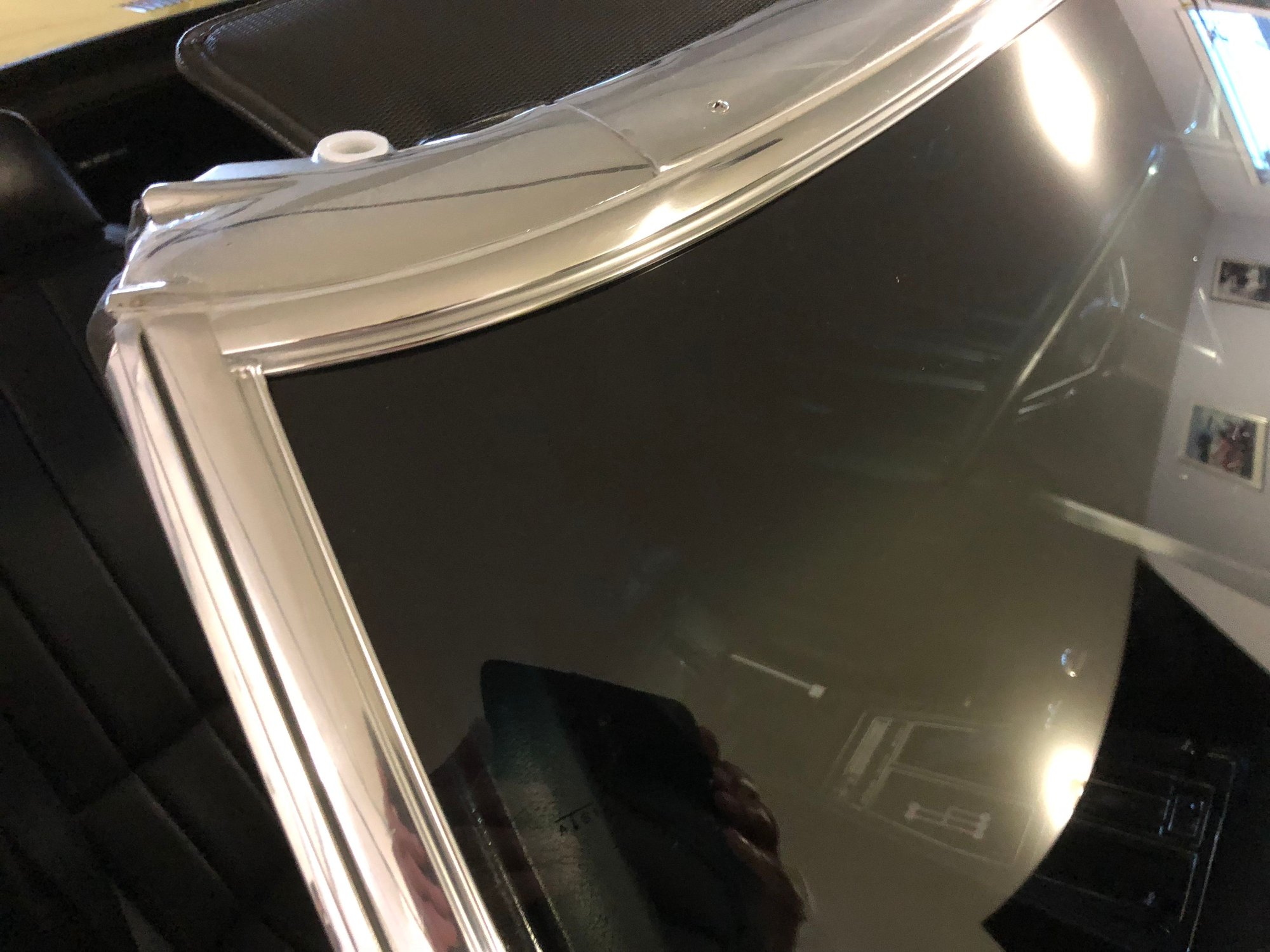

I replaced the windshield in my 69 myself at home. I had reviewed the video in post 2 and found it probably the best one out there. One thing I found is that aftermarket glass is about .070" thinner than original. The factory used a 5/16" damming strip but with the thinner glass, I had to go to a 3/8" strip to get the gaps exactly right. Measure your old glass and your new piece. Test fit everything. Try some trim for fit then do it all over again. Make sure you have everything measured right and it makes the final install fairly easy. Get all your measurements right and your trim will also fit better than when it left the factory.
