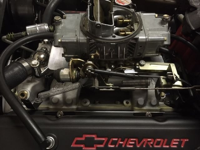

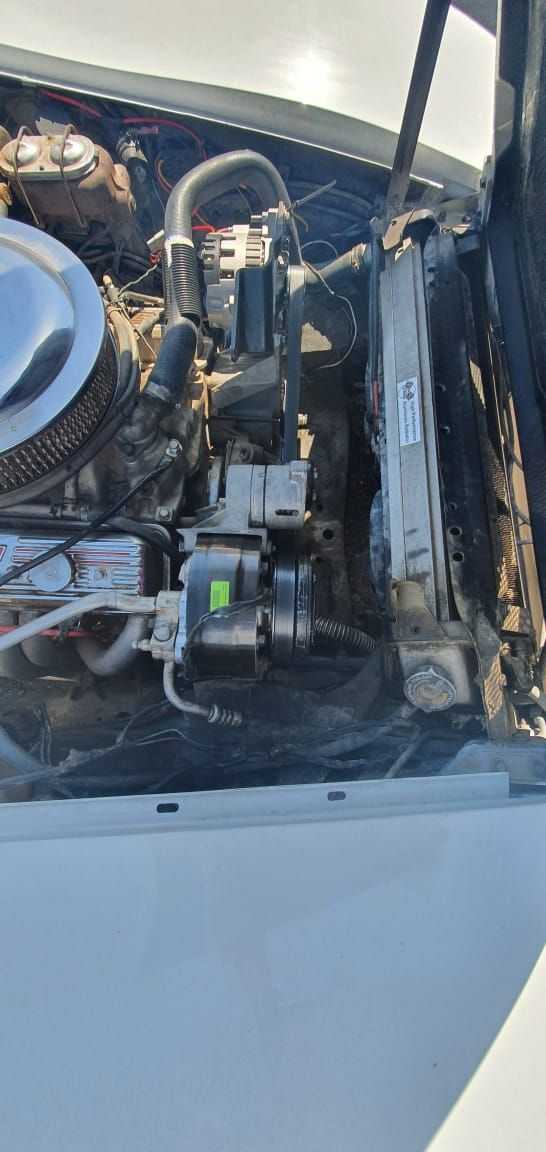

Went ahead and swapped to a Chevrolet Performance 350HO 330HP crate engine.
Car runs great UNTILL the Air Con is switched on: then there is an obvious and annoying hesitation every time the compressor kicks in, and that is now every 3 to 4 seconds.
with the old engine this didn't happen.
replaced compressor and clutch, still feel the shudder.
here are some pics of the setup.
Any ideas why please.
Thanks

I can't help much with A/C questions (my 80 doesn't have it anymore), but I am curious about your upper radiator hose routing. Can you post some more photos?
EDIT: Do you have the dual gauges to check the high and low side pressures? Rapid cycling could be from overfilling the system.

You can buy a solenoid that kicks the idle up slightly when ever the ac compressor kicks on that will prevent that problem. It mounts to the carb and is wired in with the compressor. Easy fix.

Solenoid is located on the left side of the carburetor on the throttle linkage.

Do you have a way of testing your AC charge pressures? I use one of these (link), with the appropriate R12 adaptors for a C3 (not that I have a C3 with working AC, which is why I have an R134a manifold).
But, yeah, timing is the low-hanging fruit. Email @lars for the proper timing specs to follow.
