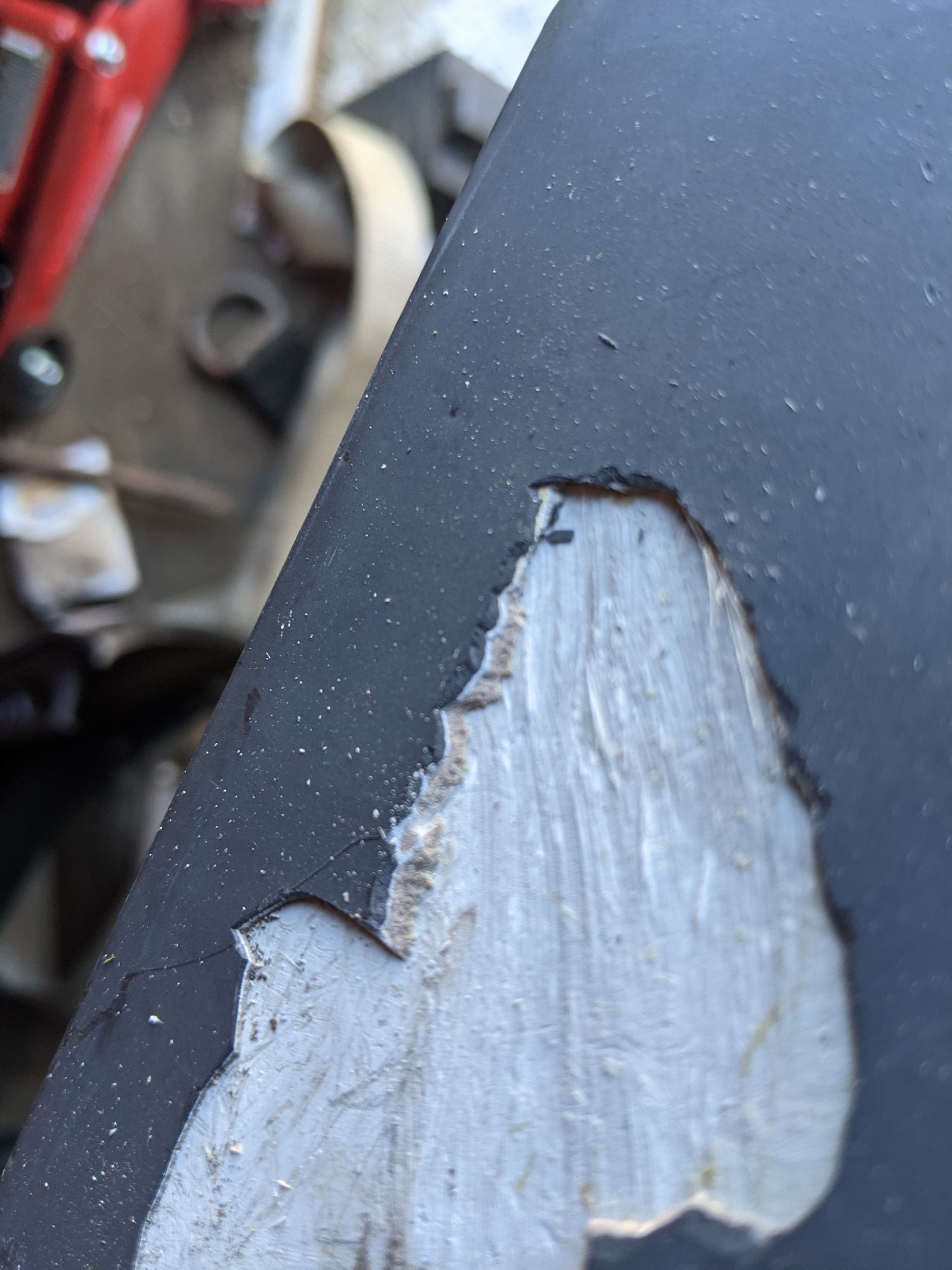

The car was all prepped and ready for paint until something either bumped into it or scratched the paint and now this is flaking off!
Thats not just paint or primer that flaked off... it looks like some sort of body filler was applied over some pretty rough fiberglass and it did not adhere to it well .. From the looks of it, thats an old repair from being hit. I suggest grinding that bondo away and using vette panel filler like evercoat makes. It costs more than bondo but actually adheres to the vette fiberglass/smc and is much stronger in every way while also being impervious to water. Where is this on the body? if its the rear it almost looks like where the rear marker lights should be? I had similar damage on my car when I stripped it for paint and used a lot of the vette panel adhesive/filler.

Agree with augiedoggy it is an old repair. You need to find the edges of the repaired area and remove all of it or you will have issues later. What year is it? If it is a 73 and newer, it is a SMC (sheet molding compound) panel and uses an epoxy based resin. All 72 and earlier are layup construction and use a polyester based resin. I’ve had to do a lot of re-repairs on 73-later where a polyester based resin was used over the SMC panel due to bond failures. This looks like that.

You should actually be happy that happened before paint. You would be really upset if you were admiring your new paint job and suddenly a chunk of car fell off!

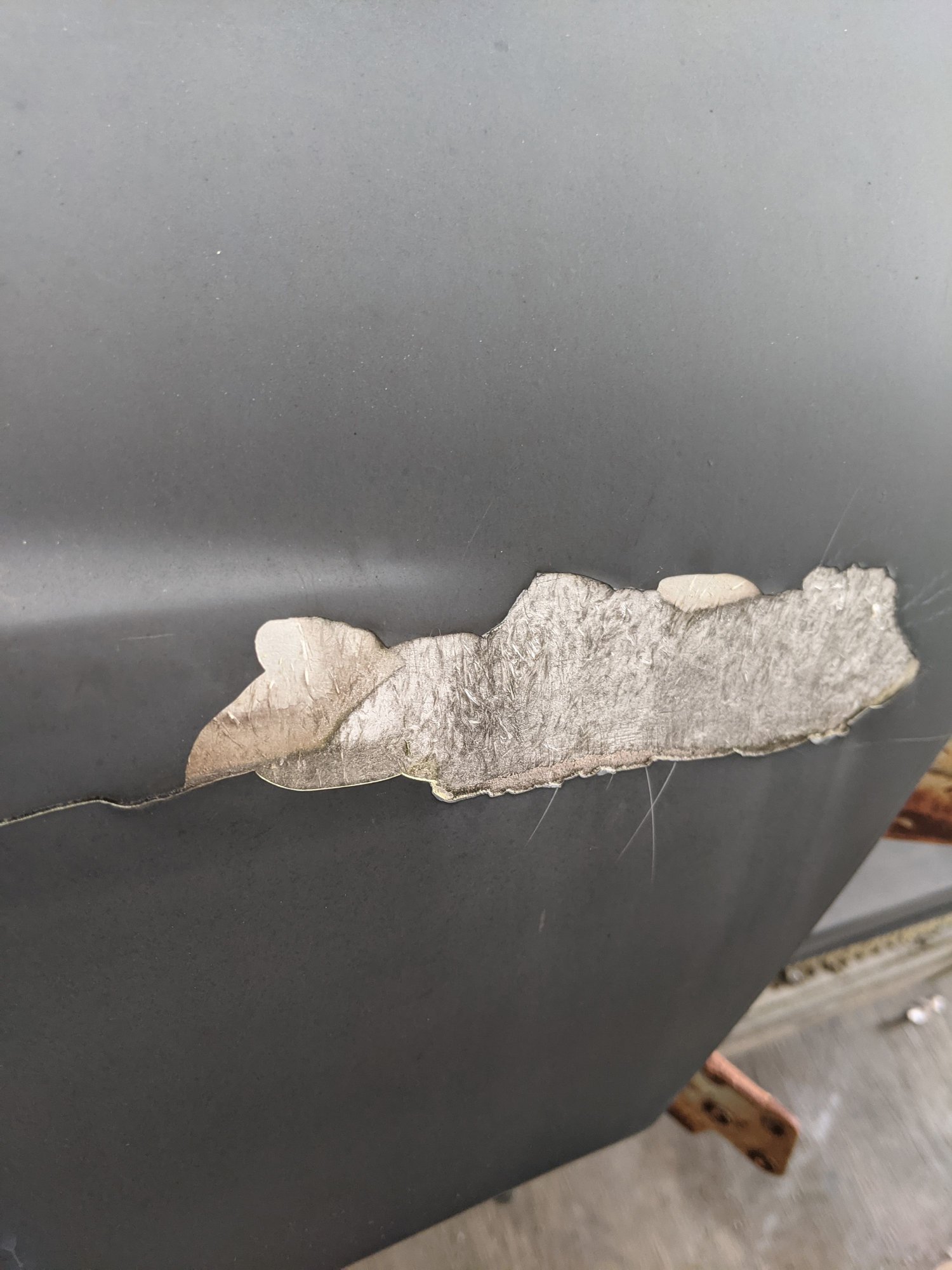

I would be looking all over that car for signs of damage and quick patches.
The primer(?) looks like it's ready to peel in other areas.
If it was mine I would just strip it completely down before I decided to do anything else.

I agree here... if it was repaired incorrectly in the rear theres a damn good chance theres bondo in other areas too... I painted my car and found an area I didnt pay enough attention too were a previous repair was done and no I have tiny bubbles in the paint in that spot a few years later. Wish I would have given

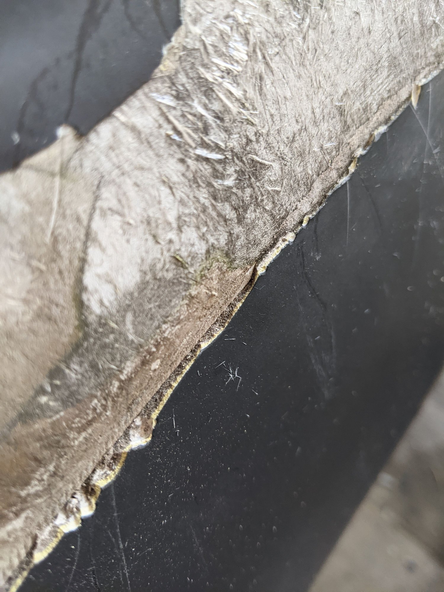

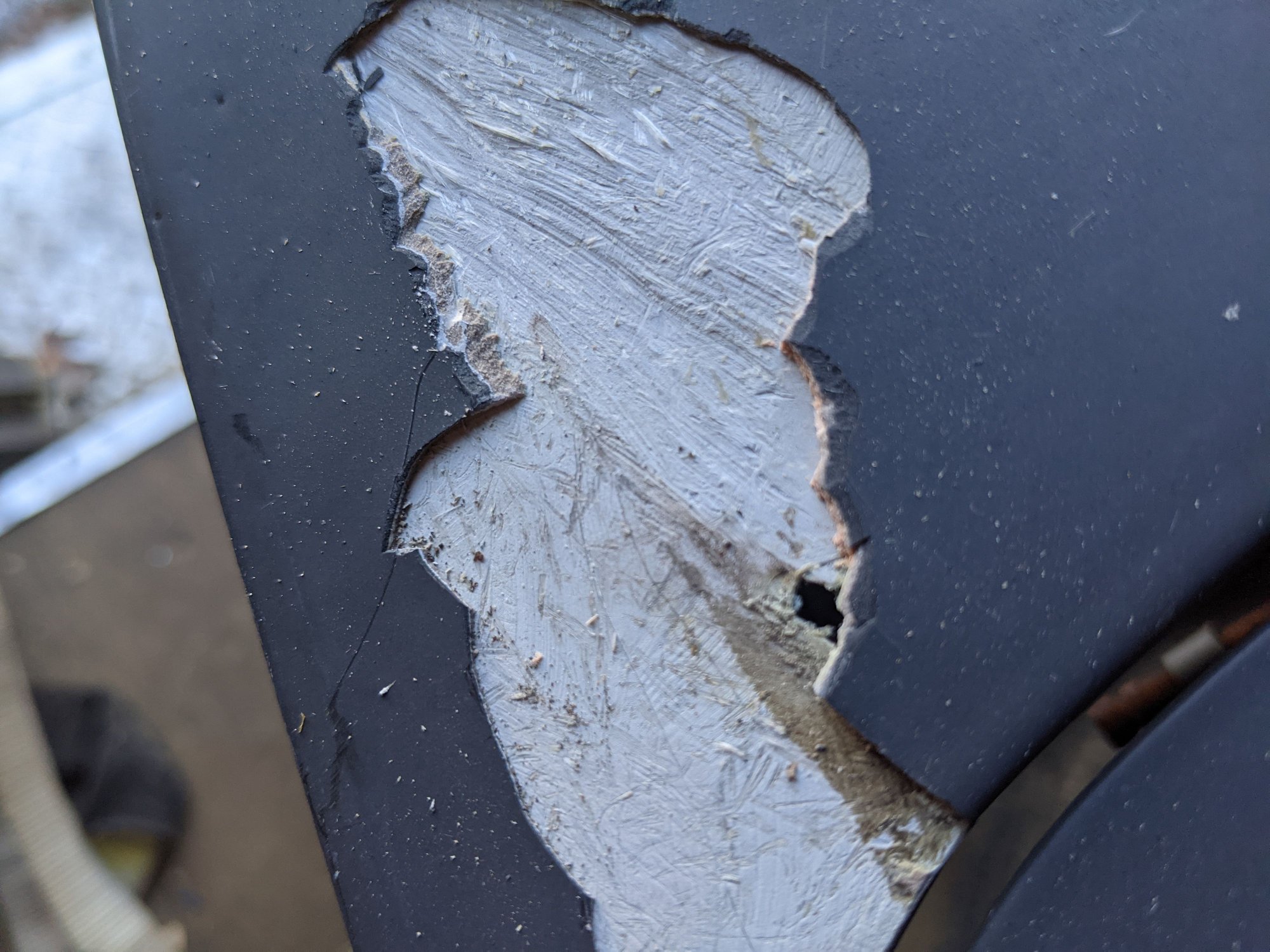

So I probed around a little bit with a putty knife and I see pink which tells me someone used blondo.
It could be a situation where someone hit it with an epoxy sealer and then use blonde over it. I was talking to some more people and this thing has been sitting on this wood dolly being rolled around for like a year and things have bounced off it, It could very well be that these failures are due to things hitting it.
I'm going to sand down these areas and fix them with some mat in a two-part epoxy and then reevaluate the situation.
My buddy can media blast the car but he said that he'll destroy the fiberglass trying to remove the filler, so it's probably better for me to just go at it with the DA and some 80 grit..

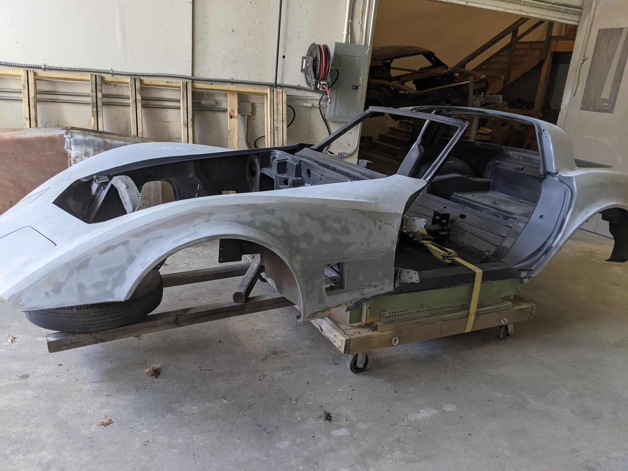

Carefully prepped and media blasted.
Removed all the filler without ruining anything.
