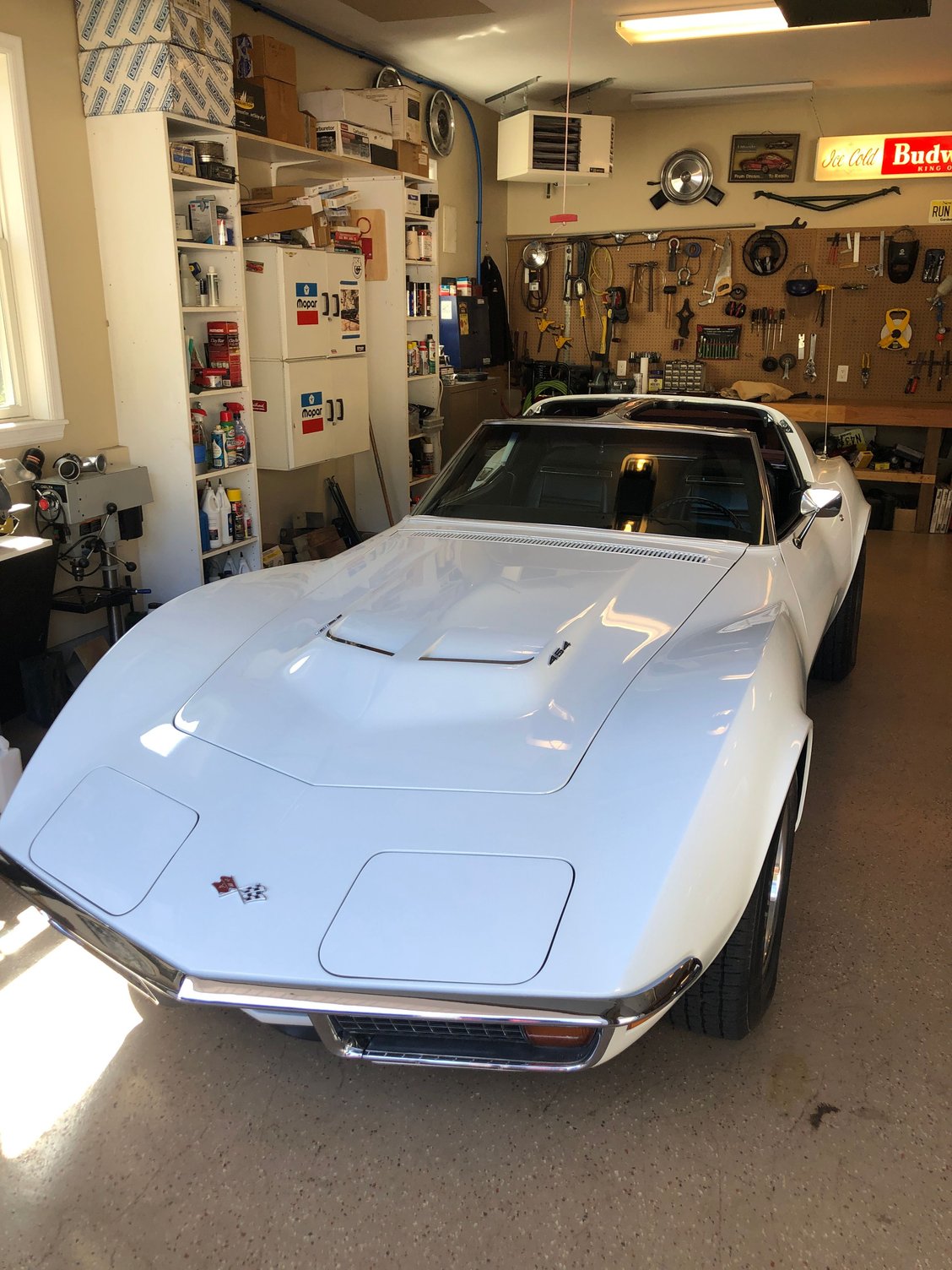

Beautiful 72. I wanted a 72, but I found my 74, before a 72 came along.

I think it's most likely you'll find it'll work once you charge it up.
BTW your shop is way to clean and organized. Mine looks more like a flea market after some kind of explosion.
