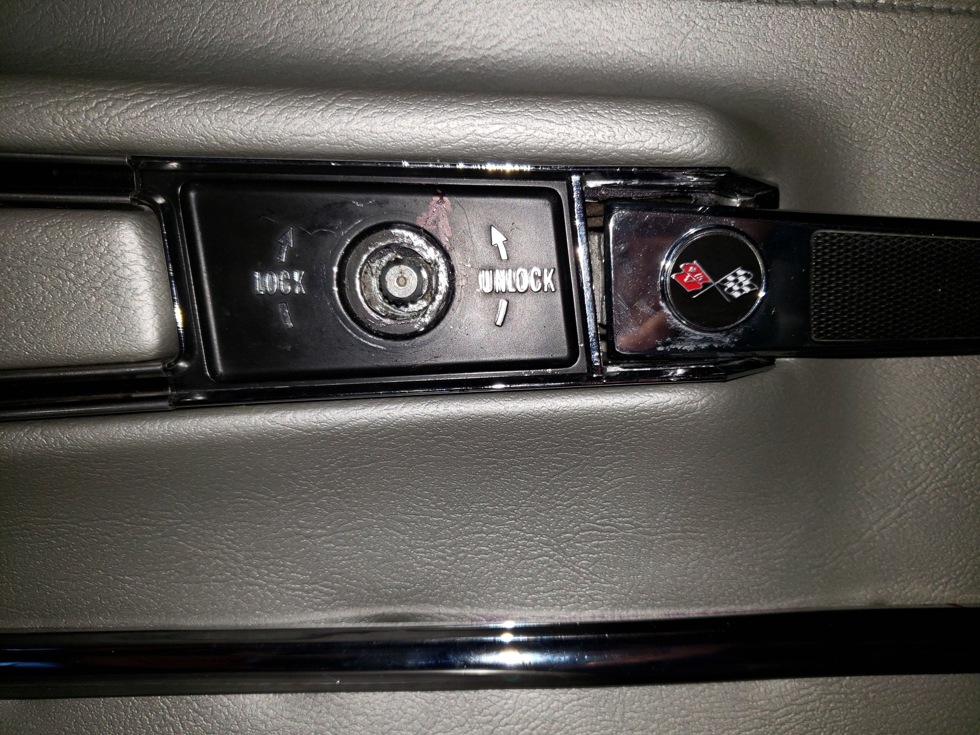

Got my new door panels back on my 75 coupe. I reused the original trim, have the lock plate lined up decently centered and tight to the panel. However it seems they are still a hair thicker, having a hard time getting the ***** to clip back on. Have one original **** that I did not try, these are new repo ***** that fit fine on the old door panels.
Any tips or tricks, can I dremel out the lock plate or do I need to pull off the panels and thin out the ABS backing?

Before taking out the Dremel make sure there’s nothing keeping the door card (ABS) from fitting tight again the metal door. Are you using the clear plastic water vapor that is attached with rooked caulk to the door metal? My fired did his C3 and ended up braking out his heat gun to make the top part (at the wipes) fit correctly. Also the lock handles go on the ribbed post ONE WAY ONLY!

The lock shaft has to be almost exactly on center of the hole on the door panel to provide enough clearance for the ****. I can't tell by your picture. I would try next removing all the screws you have holding the door panel attached to the door (but leave handle attached) and let the door panel "float" on the door and now try snapping the **** onto the shaft (on mine I had to use a plastic hammer)
If this doesn't work I would guess you will have to get the heat gun out and warm up the plastic backing to make it fit tighter to the door like the previous people have posted.

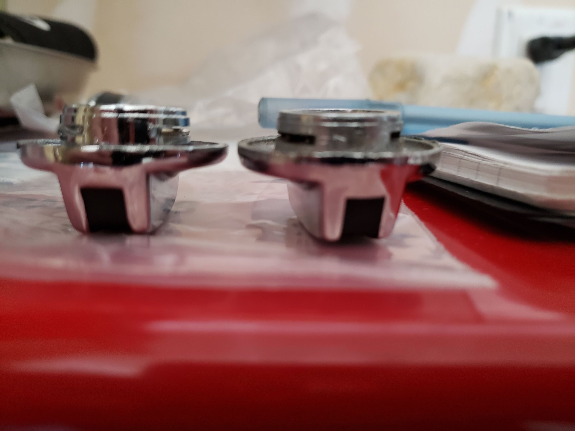

I noticed my old **** does look like the cut differs from the repo on the left:
