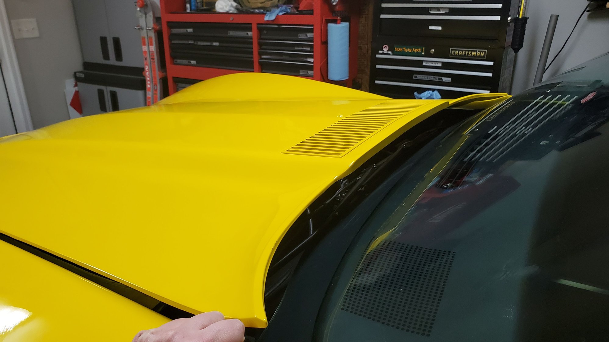

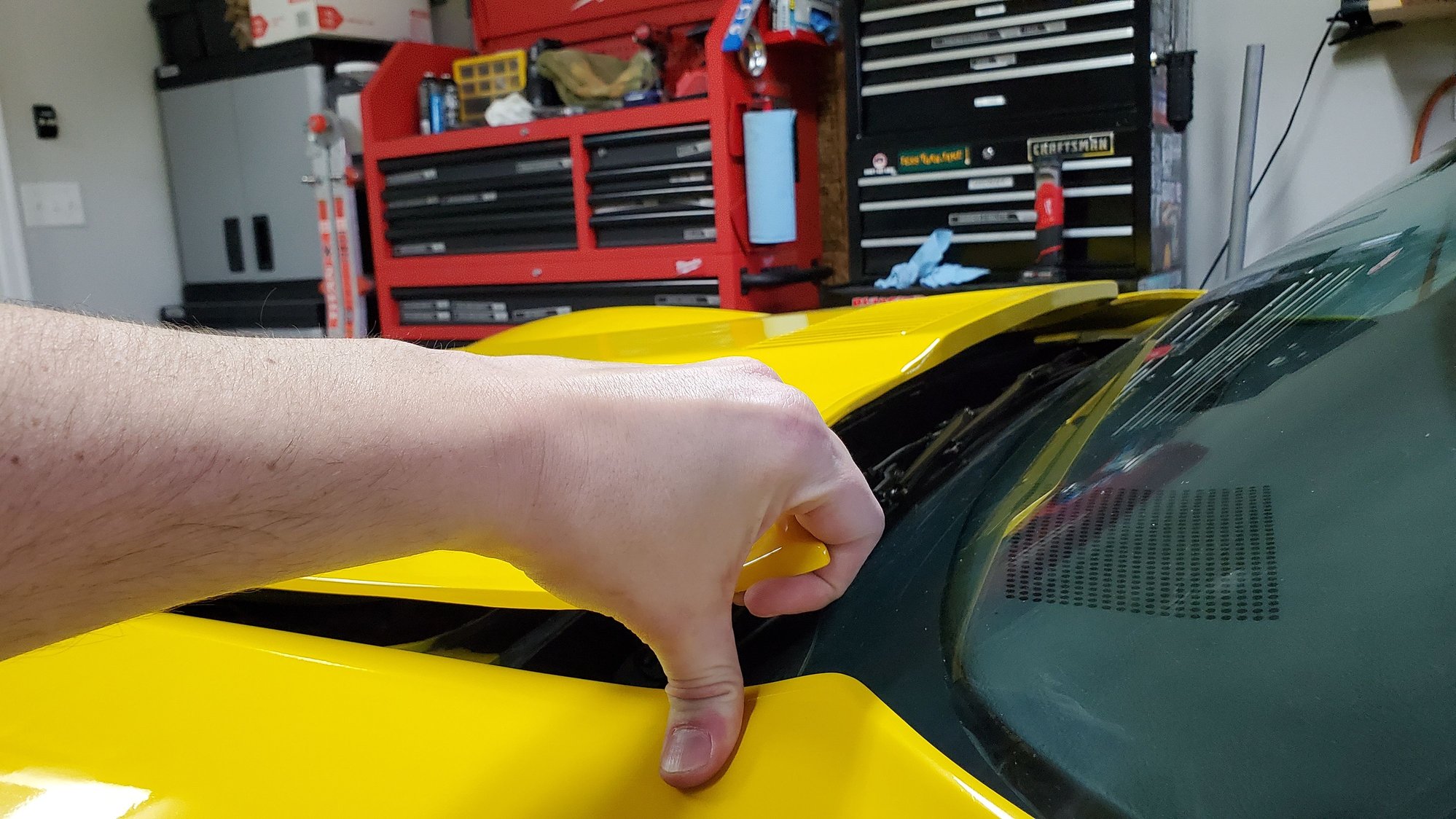

Just spent a couple of hours working on this to no success. I am still fully able to pop the drivers side open per the below picture and lift the hood a bit. Passenger side still 'pop's but is unable to be lifted. I've tried ever combination of jacking up various side parts of the car to see if that would give the frame enough of a twist do dislodge it, to being under the car and manually holding the passenger side latch open while some pushes/pulls/moves it side to side etc. I am at a total loss on the next steps. I wonder if its possible to get a ratcheting wrench up there and loosed the bolts that hold the hood pop up spring assembly to the body.
Both sides 'popped'
Drivers side is fully disengaged while the passenger one is still in a weird half latched state or something
