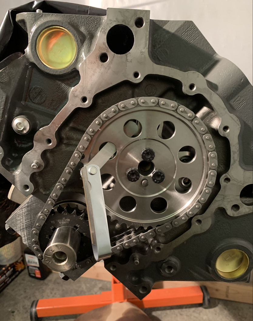

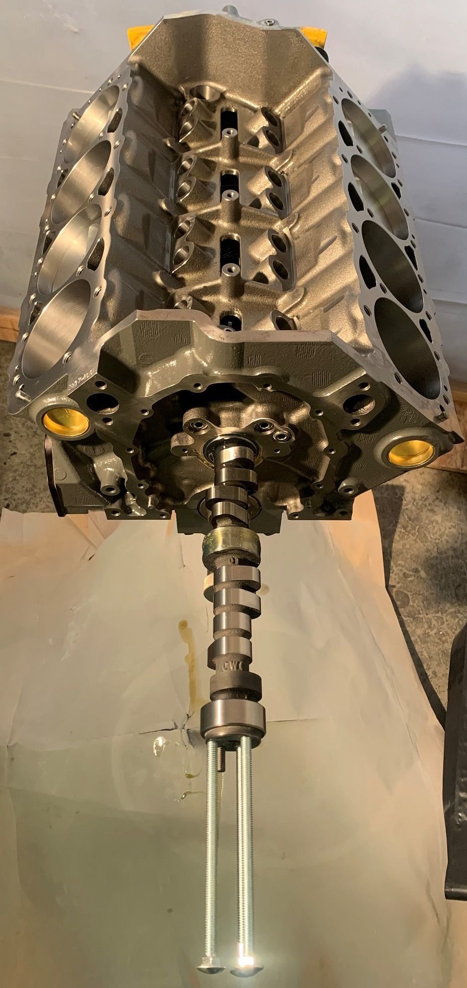

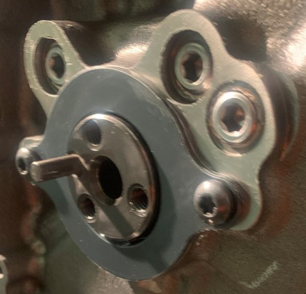

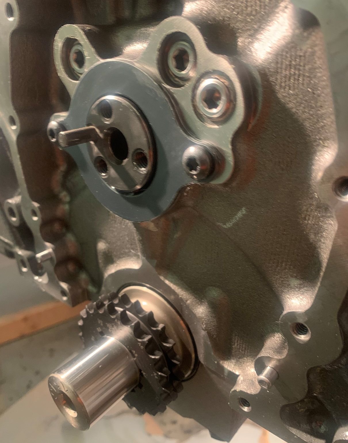

Thanks R.R. I ended in this whole situation because parts have been taking forever to come in, or have not been delivered at all. Case in point: Dart top-end kit. Ordered in August 2020 - still no show. The original plan was to build and start the engine this winter and beginning of spring, then continue the body work starting in mid-spring. I really want to focus on body work / paint during the warm weather. So here's the new plan: today I installed the cam with the original grease/assembly lube/break-in oil. I will continue the engine assembly as the parts come in, except the spider retainer and intake manifold. Then next winter when the weather gets cold again, I will pour fresh 15W50 Comp Cams break-in oil through the block's 4 slots onto the cam lobes, button it up, prime it and start it, on the rolling chassis.
The amateur's cam installation handle.
Cam plate hand tight.
Checking clearance with the plate's torx bolts.
No problem so far. Fingers crossed.

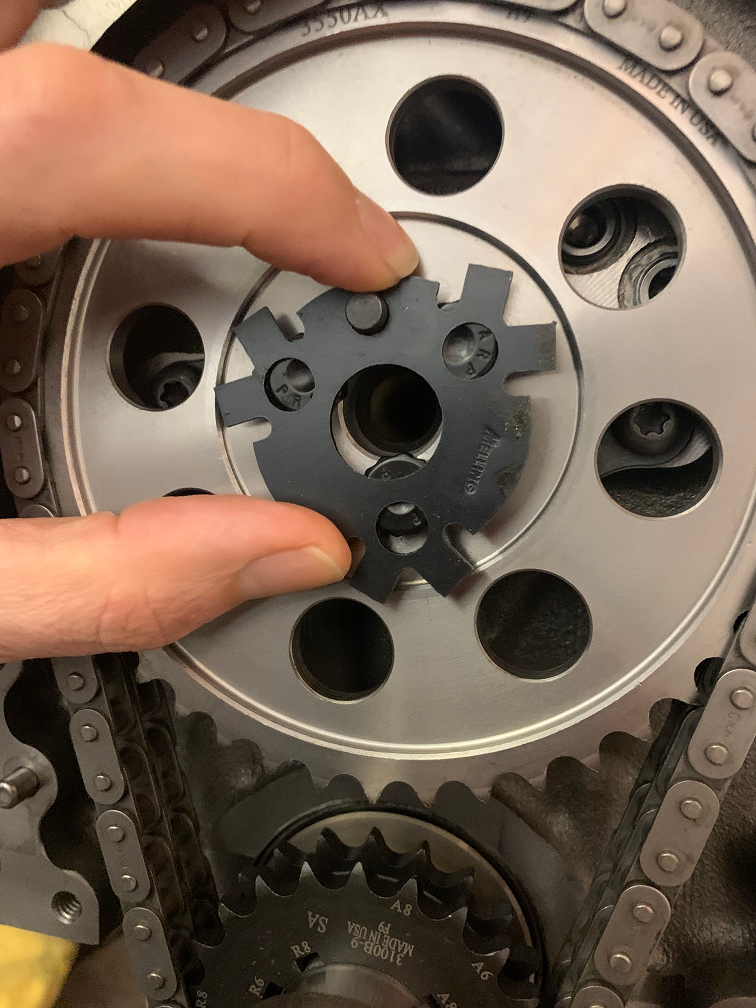

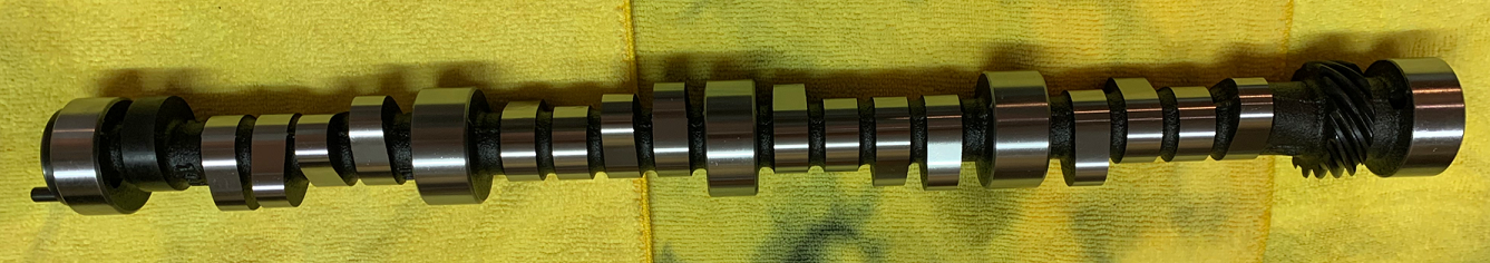

I have a 1987-1995 factory hydraulic roller cam and this COMP Cams 7136 COMP Cams Keyway Adjustable Billet Timing Sets | Summit Racing timing set. For peace of mind I wanted to install a cam lock plate and bought this one: Melling 4605-LPK Melling Camshaft Bolt Lock Plates | Summit Racing. But, pas de chance:
Am I right believing that there is no cam lock you can purchase for such an oem factory hydraulic roller cam? Thanks!

You maynot have the correct lock plate, that cold be for a differrent engine make like a ford or chrysler

I definitely don't have the correct lock plate - it's for GM though. Since nobody proved me wrong, I am going to assume that there is no cam lock plate I can purchase for my factory hydraulic roller cam.
I will use blue thread-locker alone then.

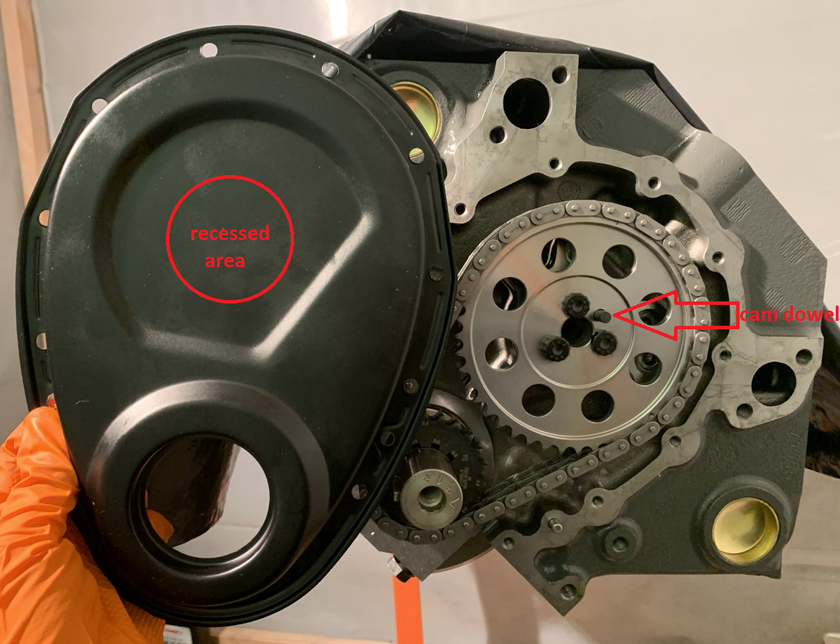

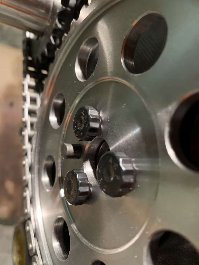

Wow, it seems every day comes with a new challenge. Tonight I installed the cam bolts with blue loctite. Once I was done I tried to fit the timing chain cover. Well, it did not fit. The cam's dowel is too long by about 1/8" - it hits the recessed area of the cover.
This is the cover I got: https://www.summitracing.com/parts/trd-8636
And again, I have a 1987-1995 factory hydraulic roller cam in a Dart SHP block.
Any recommendations? Thanks.

I just realized this: if you look at the pictures of my post #3, it seems that the cam dowel sticks out more than usual. Maybe it is possible to hammer it in 1/8" while blocking the chain sprocket...

Use an Allstar 90110 Timing cover.

Thanks Jebby. Did you mean Allstar 90010 https://www.summitracing.com/parts/aaf-all90010 ? I can't find an Allstar 90110.
Don't you think my cam dowel pin sticks out too much?
Yes, 90010 is what I meant and yes that dowel is about 1/4” too far out.....walk it out, cut it and tap it back in.
Jebby
Looks like it from that angle

A few days ago I simply placed the thickest feeler blade I could fit between a cam plate bolt and the sprocket and tapped in the dowel about 3/16" until it bottomed out. My guess is that whoever prepped the cam did not tap the dowel pin all the way in as expected, and since I'm a novice I had no clue. The timing cover fit like a glove afterwards.

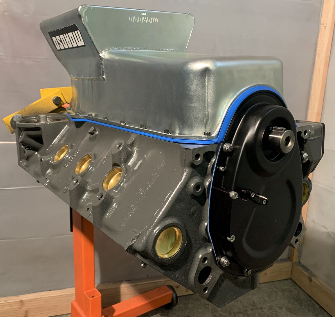

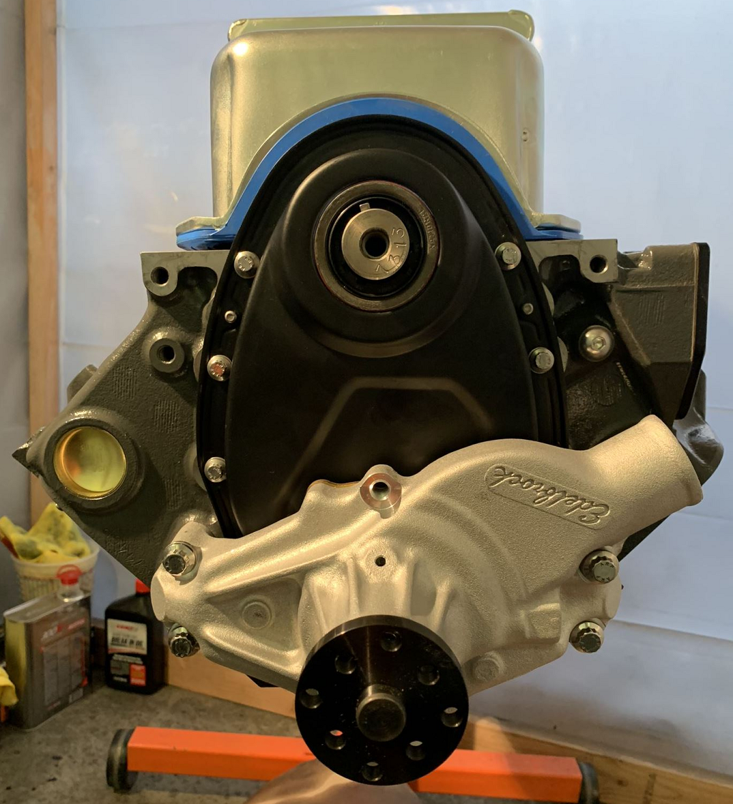

After that I test-fitted the oil pan gasket and oil pan:
...and test-fitted the water pump:
Everything turned out good.

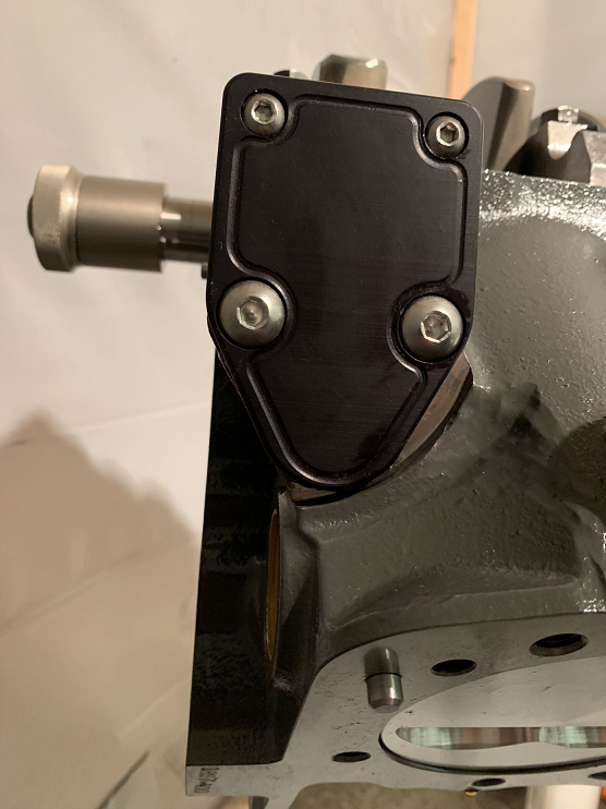

Now, next question: after reading this https://www.corvetteforum.com/forums...post1603285807, I wonder if I should remove the gas pump plate I already installed and put in a fuel pump pushrod even though I'll be using an EFI system.
Do folks with an EFI conversion install a fuel pushrod? I could not find any literature about this. Thanks.

I took mine out....didnt want an extra piece of steel in the motor, It shouldnt go any where and it would just be bottomed out against the plate if it was left in there.

I'd take it out if I was going EFI

Thank you guys! I won't install a pushrod either.
