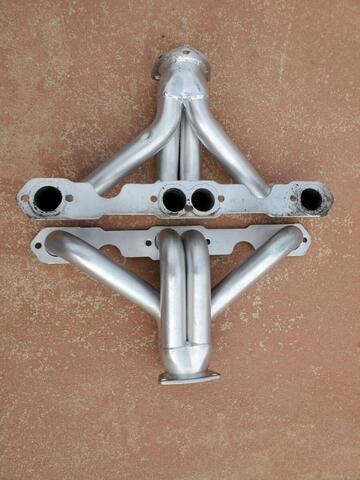

Likes: 654
From: Tampa, Florida

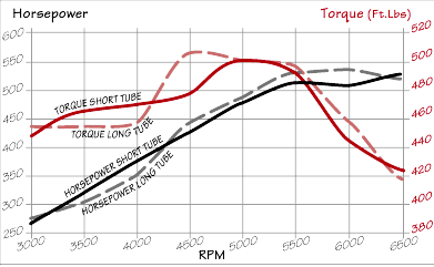

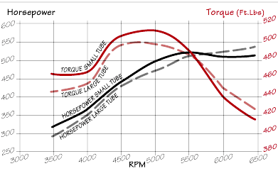

Old Apr 12, 2021 | 12:55 PM
OldCarBum's Avatar
OldCarBum
Posts: 14,399
Likes: 8,204
From: Napa Valley California
Hey Jebby,
Sanderson Headers did some dyno tests which show the numbers.
For some people it will give them some gains and give them the ground clearances they want or need.
There is no comparison for a high performance engine that really needs to breath.
I do agree with you, but I can see the other side as well.
Here are the graphs Sanderson did on their dyno tests.

For anyone's info, I have a pair of slightly used, but good condition block hugger headers, suitable for experimenting with, or just low-cost option for headers I could sell.
Would like $100 plus actual shipping.
