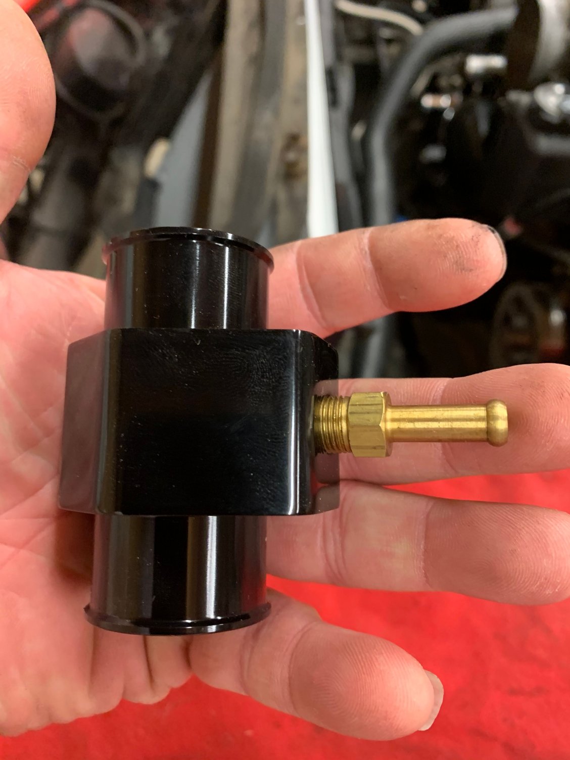

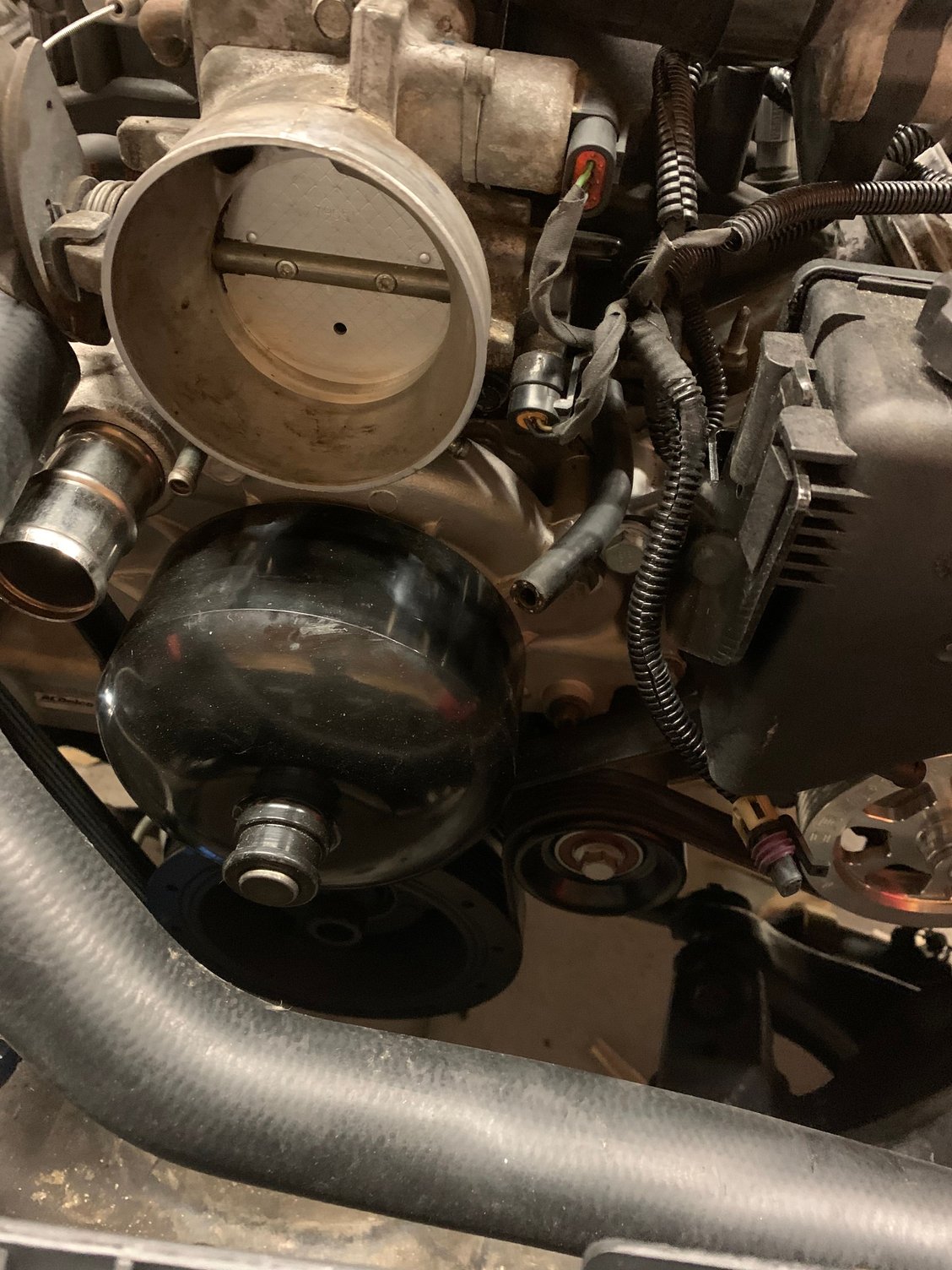

So to rephrase my question so it is a bit more clear. I am contemplating taking the hose indicated by the arrow on the right and running that directly to the upper radiator hose using a fitting in the bottom photo. I would cap the fittings coming out of the throttlebody that are indicated by the left and center arrows.
Old Mar 9, 2021 | 01:09 PM
lionelhutz's Avatar
lionelhutz
Joined: Apr 2007
Posts: 11,150
Likes: 890
From: South Western Ontario
Yes, that will work just fine. It is a very common modification to the EFI engines with the coolant passages in the throttle body. I did it on my LS1 after pulling the intake.

If you aren't using the throttle body tubes you don't need to cap them. On another LS project I just cut them off so you couldn't see them.

Agreed you can do that. It goes back to my previous statement of what does it gain you HP wise vs what you lose drivability wise. I’m not sure but something to consider.
It does clean up the plumbing some and I have seen throttle bodies spring a leak in the past as well.
