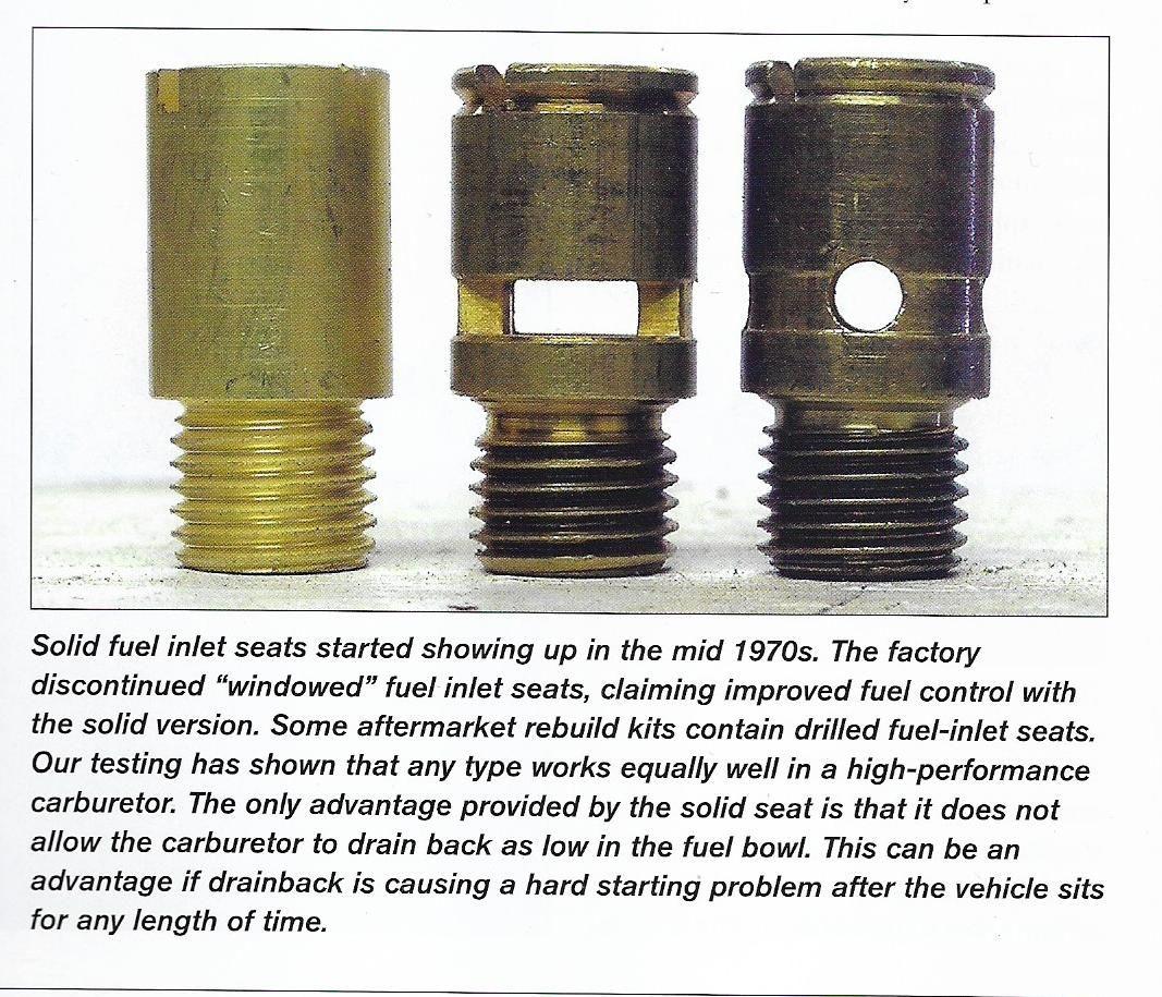

Needle seat and washer assembly. Some seats are open around the base and some are a solid piece is there a difference and why?
From Cliff Ruggles book:

I noticed 2 different sized fuel inlet holes in the seats also.
Dom

If you are talking about the inlet seat, they do come in different bore sizes. The guy to ask real advice from on your car would be Lars.

Yes, he would know. I had a Qj,jet starve and changed the seat and all was perfect.
WHY, didn't they just do the larger seat to start with??
Production changes are expensive and I think that small fuel hole would have been what was needed from the beginning.
And Yes I love the Q,jet as I think it was the BEST carb made. Proper adjustments will make it awesome.
