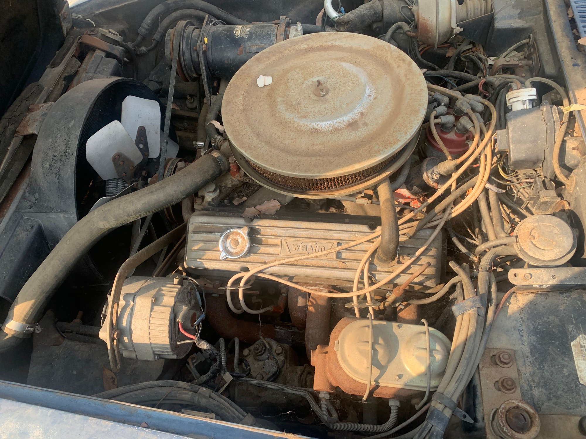

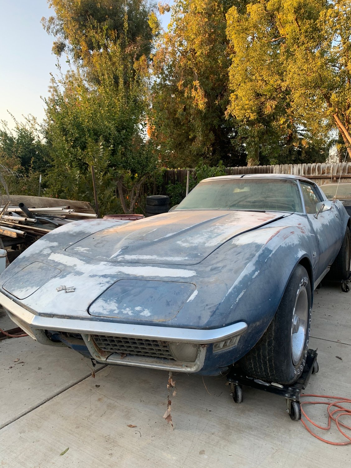

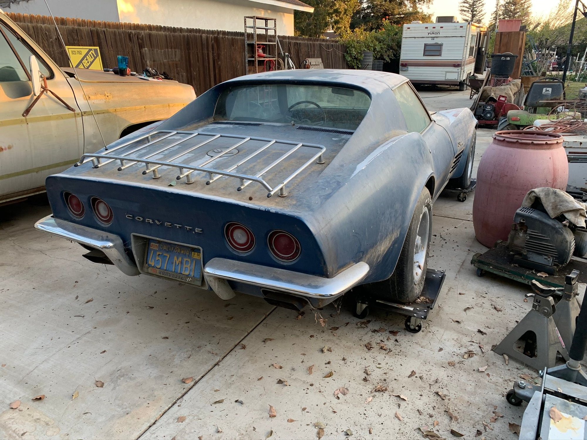

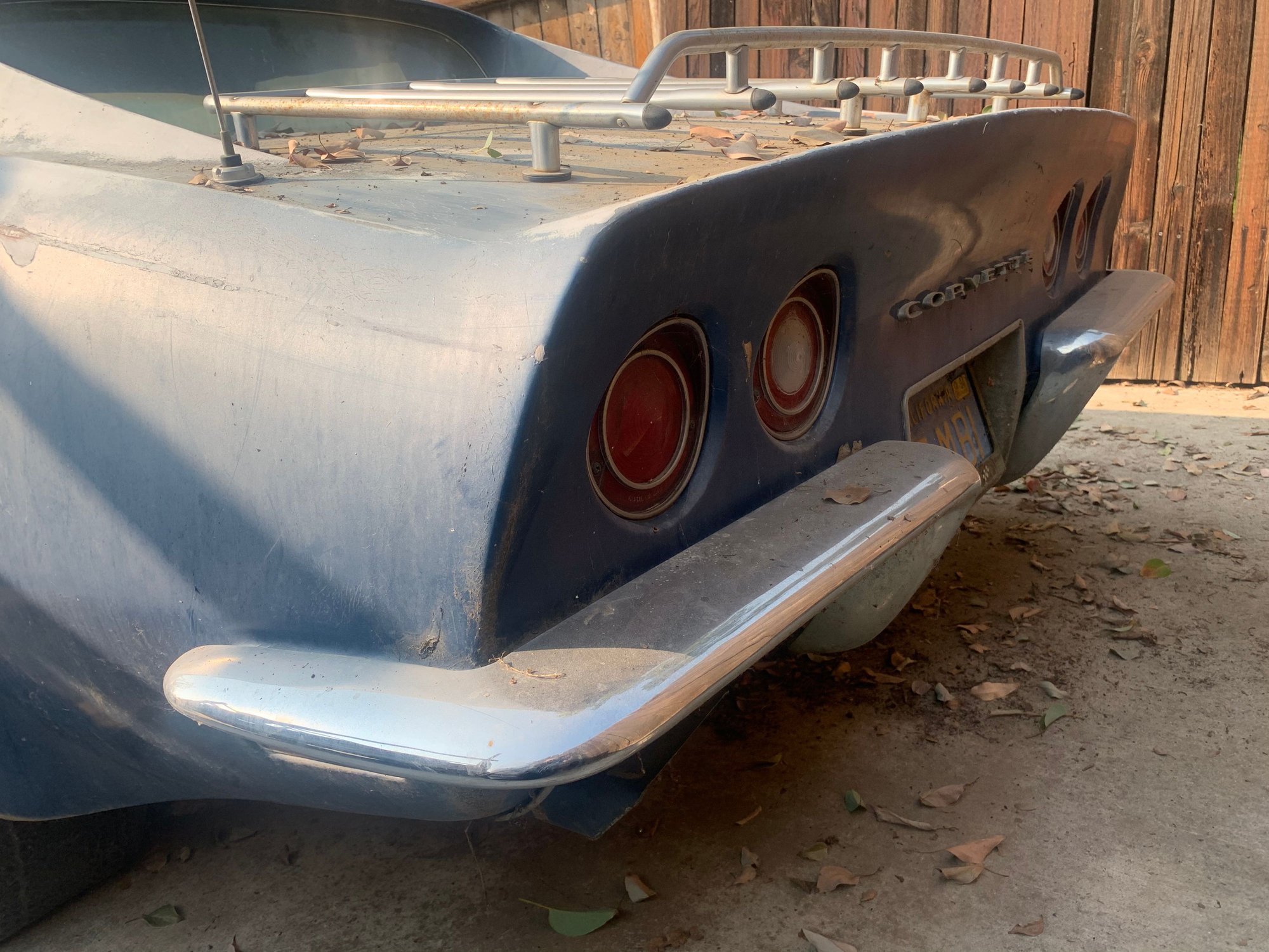

Originally Posted by ralphspears
Let's see some pictures of the car
