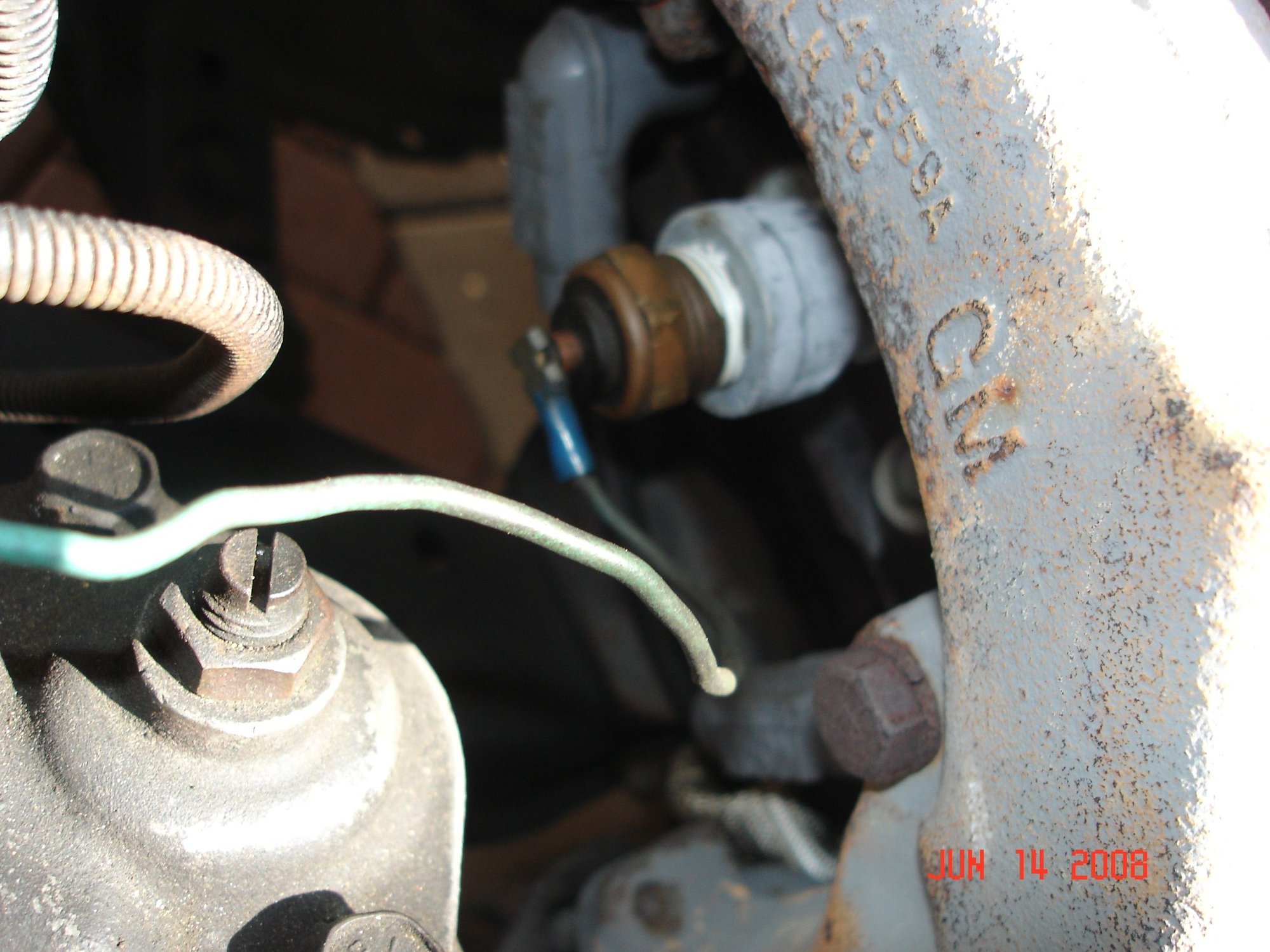

If you have a die grinder and a steady hand you can grind out the hole just enough so the existing threads are just gone and you will be right at where the tap drill size needs to be for this operation. It's getting cut with the tapered tap so you dont need to be dead nuts perfect. I will post pix in a couple of weeks.
If that is just too scary, Home Depot sells a drill and tap kit for this job for $14 Ebay is a good source for the tap as well.

Here is my $3.00 Home Depot "Bubba" fix. The plan was to use this until the next time I pull the heads to drill and tap it to the correct size.
