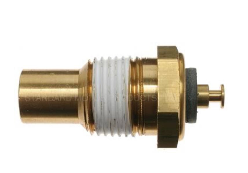

Does anyone know of an "off the shelf" part number, that will fit my Dart heads and be compatible with the gauge on my '73? I'd just as soon not have to spend $80.00 & wait weeks for the one Wilcox sells.

find one that fits and use the water temp gauge adjustable resistor that he sells. IT works very well and you woont have to find the "perfect" sender.

But is it compatible with the stock gauge? According to Wilcox, none of them are. I've been through three so far and they all read low.

Willcox sells a cutdown sensor to fit the 3/8" NPT threads. https://willcoxcorvette.com/corvette...79-3-8-npt-new

No it's not, Willcox uses the correct working larger sender and then machines it down to 3/8" and re-threads it.

My stock sender was a blade connector.

No they are not the same, the resistance is different. Thats why you have to use the original style. If you dont want to pay for a machinists time and labor, then buy a 1/2 inch drill bit, tap and die and for NPT and re thread the head. But thats going to more expensive if you havent priced a NPT tap. If you have an issue with Willcox and his pricing you should call him and talk to him about it. You will find that you can actually talk to the owner of the company that has been in business with GM products since his Dad had a Gm dealership and garage. Try that with Corvette Central, or Ecklers or Zip.

Originally Posted by Factoid
Men, that is the same goddamn sender only Wilcox places the Corvette tax on it. Slime *****.
So you can pay the BS Wecox price of $80 or buy it on Amazon for less than $20 with free shipping. Your choice.
Really? Doesn’t the stock sender use a pin connector like this one?
Interesting. That is now three different connector types I’ve seen on a C3. Blade, pin and threaded. At any rate, both of these senders, Wilcox for $80 and Amazon for $17 are the exact same range and 3/8” npt.
No they are not the same, the resistance is different. Thats why you have to use the original part numbered piece, not some chinese look alike. If you dont want to pay for a machinists time and labor, then buy a 1/2 inch drill bit, tap and die and for NPT and re thread the head. But thats going to more expensive if you havent priced a NPT tap. If you have an issue with Willcox and his pricing you should call him and talk to him about it. You will find that you can actually talk to the owner of the company that has been in business with GM products since his Dad had a Gm dealership and garage. Try that with Corvette Central, or Ecklers or Zip.
A third option is the Willcox variable resistor that HIS company invented to make those chines senders actually come close to working. But that involves taking the dash apart. The OP said he didnt want to do that and that is time consuming. Remember you time is money whether its actually paid time at work or existential "time" that you spend working on your own vehicle. If you dont want to do it your self, check a mechanics rates. Most locally here are about $150 an hour for shop labor
