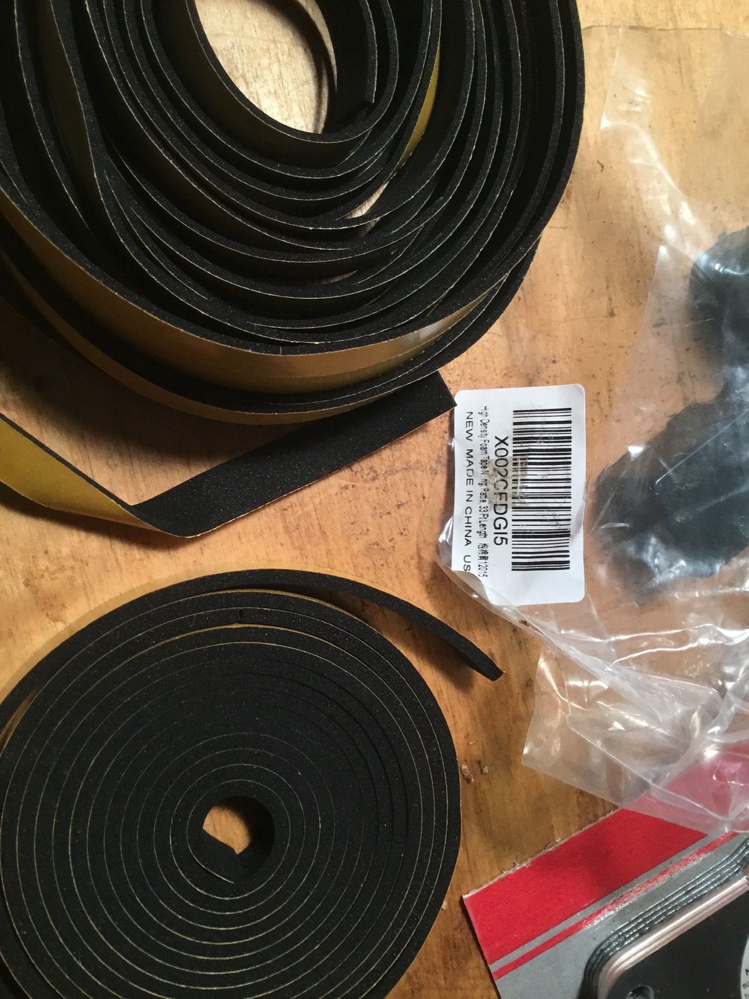

I used this stuff from Amazon. 1/16” and 1/8”

You don't want foam seals on those vent housings. Why not? Because foam will disintegrate in just a few years. Buy a piece of black felt...about 3/32" think (about 2 mm).... and cut some 1/4" wide strips. Clean the inside of the vent housing [where the seals will attach] with lacquer thinner or other volatile cleaner. Use some thin double-sided tape or contact cement to attach the seals so that there is a full round in each of two places per housing. To re-insert the *****, turn the ball so that the front/back openings are facing right and left (90 deg turn from normal position). Now just push the ball into place and turn back 90 deg to normal position.
The felt will last for many years without losing resistance--so the ***** won't slip out of position on their own.
