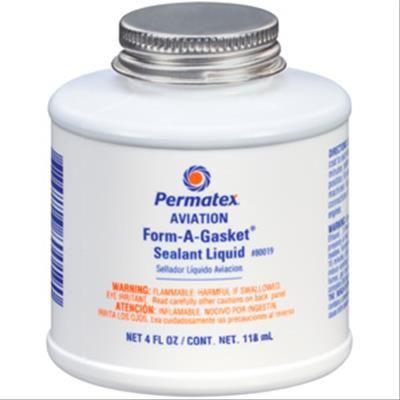

I coated the threads where fuel line attaches to carburetor with Permatex Aviation Form-a-Gasket sealant liquid, 3H item # 80019 and snugged tight.
