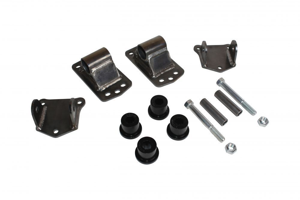

I'm collecting parts to put my C3 back together, and I'm trying to decide what to do for motor mounts.
I don't know if I want to run solid mounts because I'm worried about vibration (maybe they are not that bad?), but would prefer something more robust than the stock interlocking type. I have mounts like this on both my trucks, and they are much more robust than the factory interlocking style. Is there anything like this out there for a Corvette?
https://www.offroaddesign.com/competition-style-motor-mounts-for-73-to-87-gm-small-block-or-big-block.html

In your pic , all you would nned is the solid plate if thats they way you wanted to go. Did you have an issue with tearing the polyurethane in the interlocking mounts? I know I used to tear up motor mounts alot years ago, but I havent had an issue with my corvette, even with racing it at the drag strip or doing stupid stuff while cruising the beach. Usually break something i the rear end first
