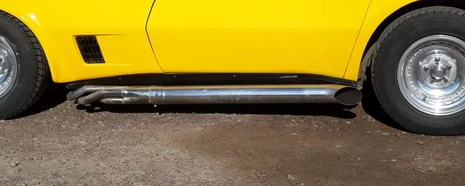

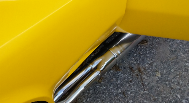

The pipes are actually quite solid (except the inside rust). BUT, I found two little holes on each pipe, from the spot where the old insert has been in contact with the tube :I So these do need replacement at some point. Most likely I will use these tubes as they are for this summer and then buy new side pipes later.
I am not sure, but I think they are "hand polished stainless steel", these: https://www.holley.com/products/exha...arts/7542-3HKR
I have to measure them later this week.
EDIT: Here are some photos of the pipes, maybe someone will identify them from the photo even x)
