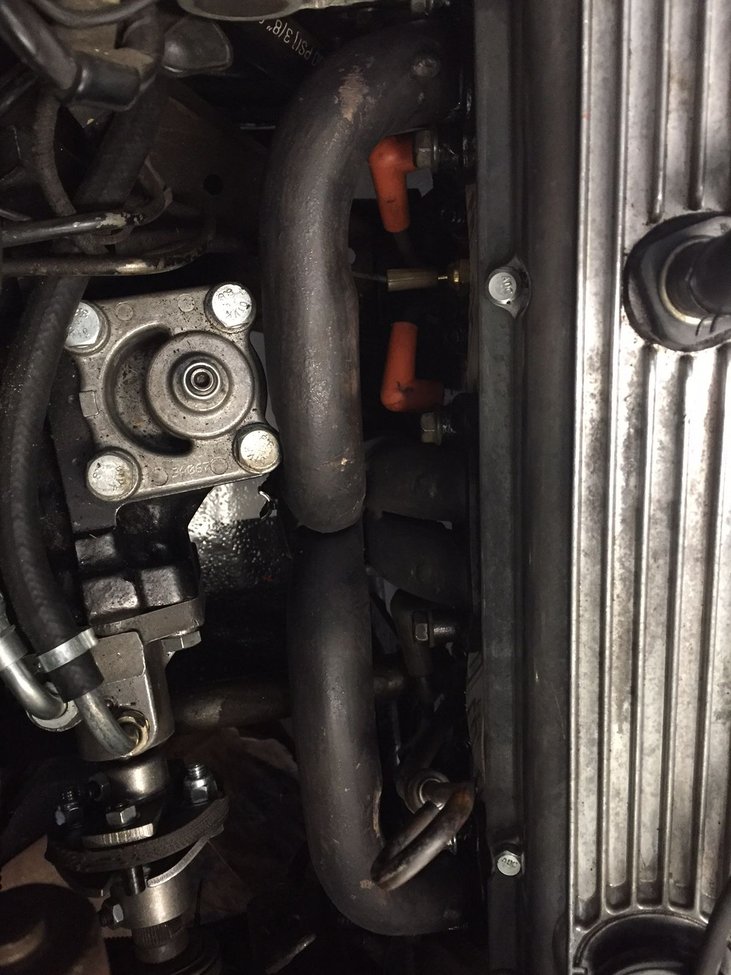

One option is the factory 1981/82 or 84-91 C4 L98. They were solely for weight reduction over the previous cast iron units and are good for about 300 crank hp only. You will have to remove/weld up the air injection/EGR tubes. I used 81/82 on drivers side (with Borgeson) and C4 on passenger side of my '69. I did have to dimple a tube for the Borgeson slightly but plenty of room afterwards. if you hit the right junkyards they are inexpensive, usually pricey on ebay though. They are 409 stainless
