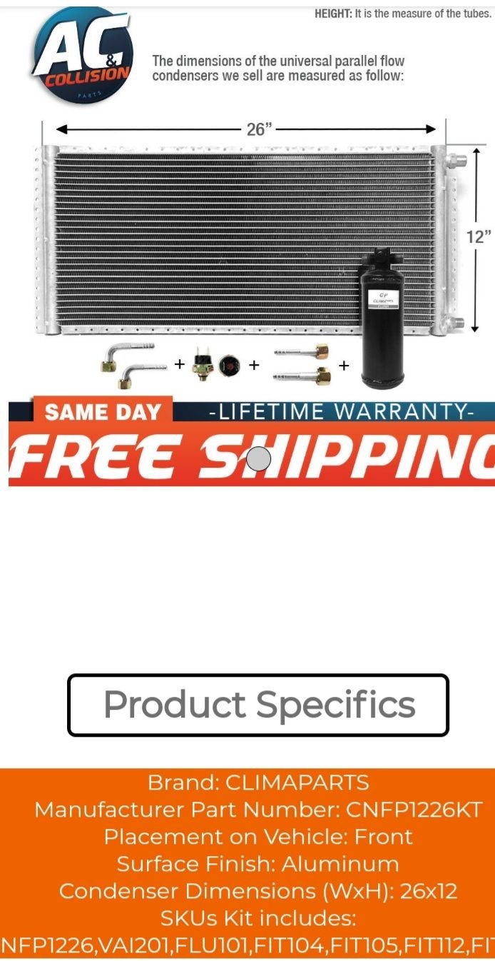

Thanks for the reply's. I am defiantly going with the Parallel Flow Condenser. Everything I have read, (and I have read alot) confirms that with 134 the system will definitely run better and colder with the Parallel Flow Condenser.
To Carriljc, I looked on line at the one you got from Amazon. it is no longer available, However, I found this one at a fair price and they will ship to Australia.
What do you think about this one??

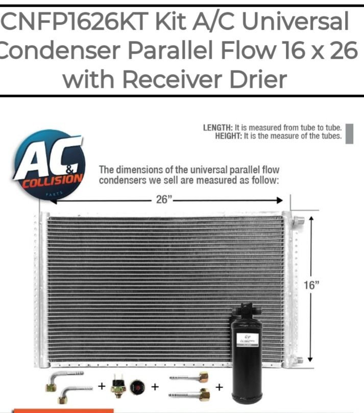

A bit more digging

Looks good. Just ensure the end fittings hook up to the hoses. As long as it's empty you may want to consider installing a Trinary switch if you have an electric fan. It's a good time to do it.

Thanks for that Andrew. I bookmarked there page, I'd never heard of them before. Had a quick look at there site. prices look very good for Australia. Unfortunately they don't list a condenser anywhere near as large as the stock corvette one. and the overwhelming consensus is to run as big of a condenser as you can squeeze in. I've decided to order the 26×16 unit from the states.
